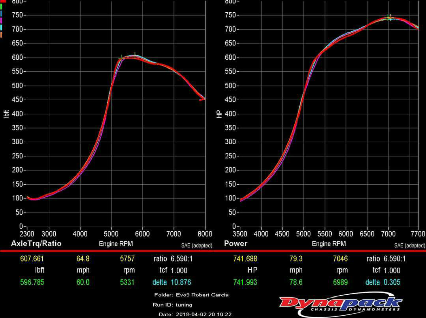

May 14, 2018 | 06:36 AM
As you expect, I've seen +1mm valves and blending of bowls and knife edge splitter gives up a little spool to get more up top (see photo for built 2.0L motor on FP Black). I believe porting will tradeoff more spool for more top end.

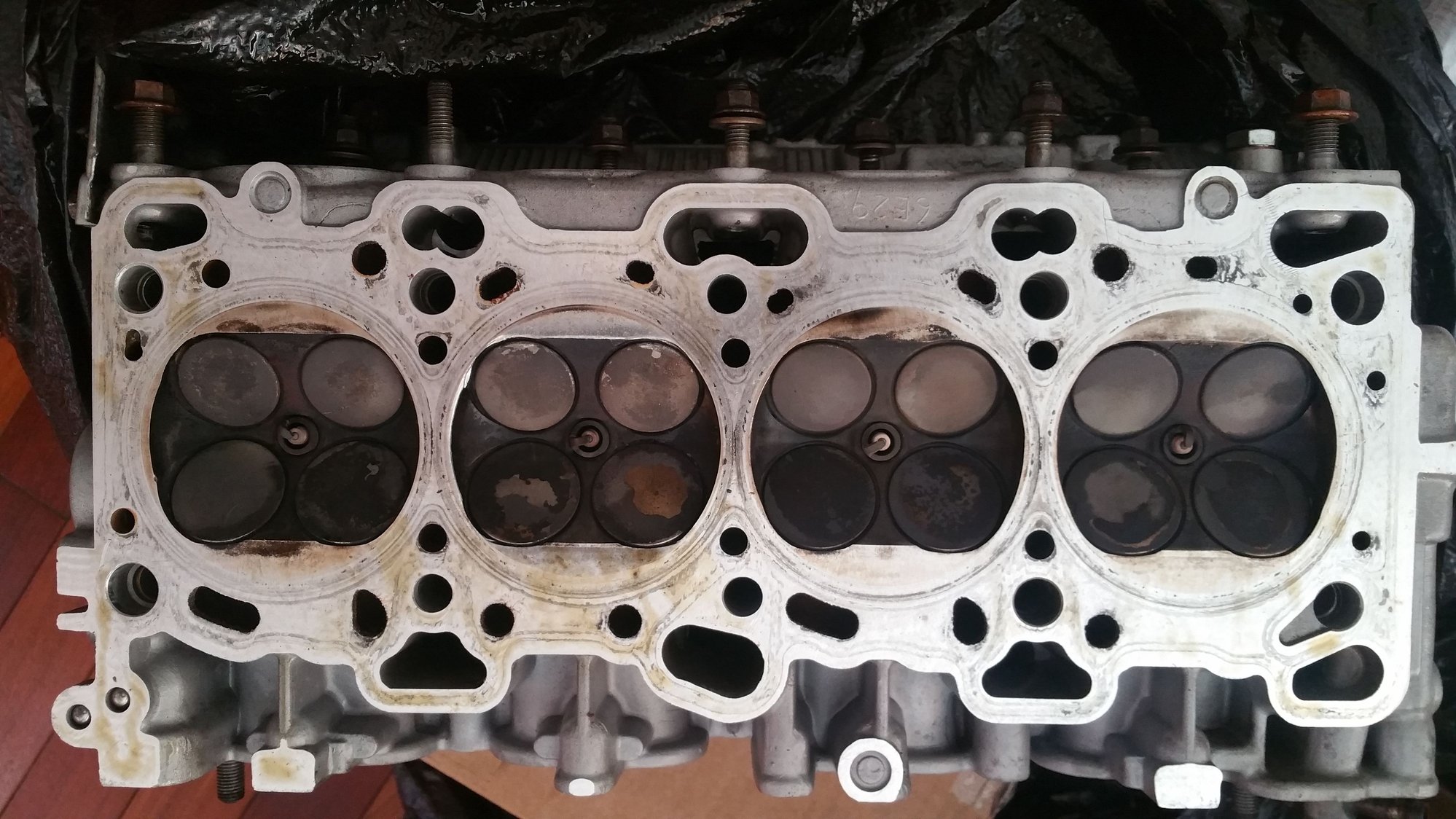

Quote: Who is installing your +1mm valves? Are they going to CNC your valve seats? Watch out for shops who only install +1mm valves and not machine the seats or hand port the seats. I have a spare head that has +1mm valves. The did not cut the valve seats, so valves stuck into combustion chamber. And yes, it has bent valves.
Can I see, if the seats are done as should? I have a 0 miles spare +1mm valve head too and got worried about this LOL
Reply 0
May 14, 2018 | 11:46 PM
Quote: Can I see, if the seats are done as should? I have a 0 miles spare +1mm valve head too and got worried about this LOL
Reply 0
May 14, 2018 | 11:53 PM
Notice how intake and exhaust ports overlap.

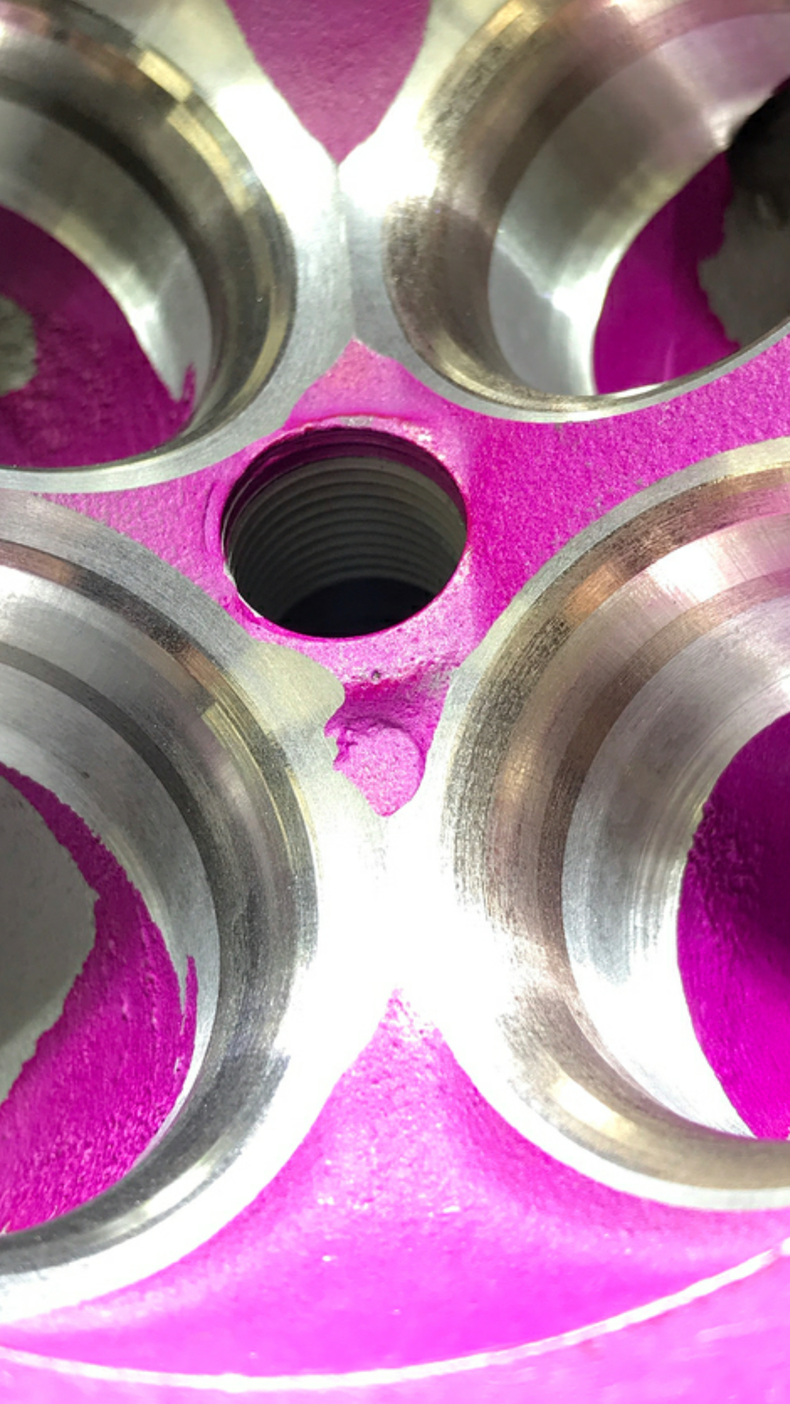

May 14, 2018 | 11:56 PM
Here's a CNC stock sized valve seats (opened up).

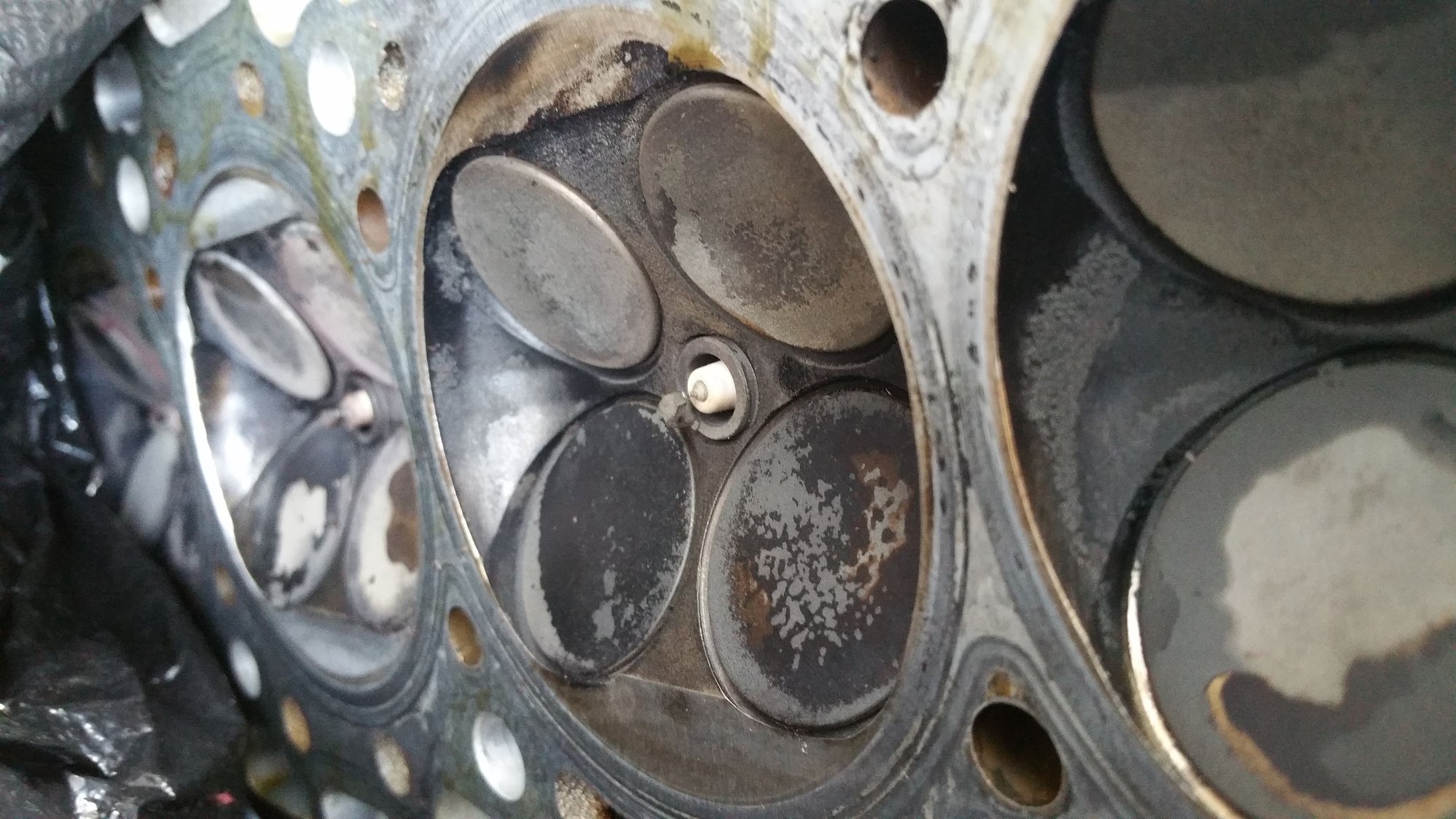

May 15, 2018 | 12:01 AM
Here's what +1mm valves installed looks like.

May 15, 2018 | 12:10 AM
Here's a +1mm installed on stock valve seats. Notice how it sticks into combustion chamber?

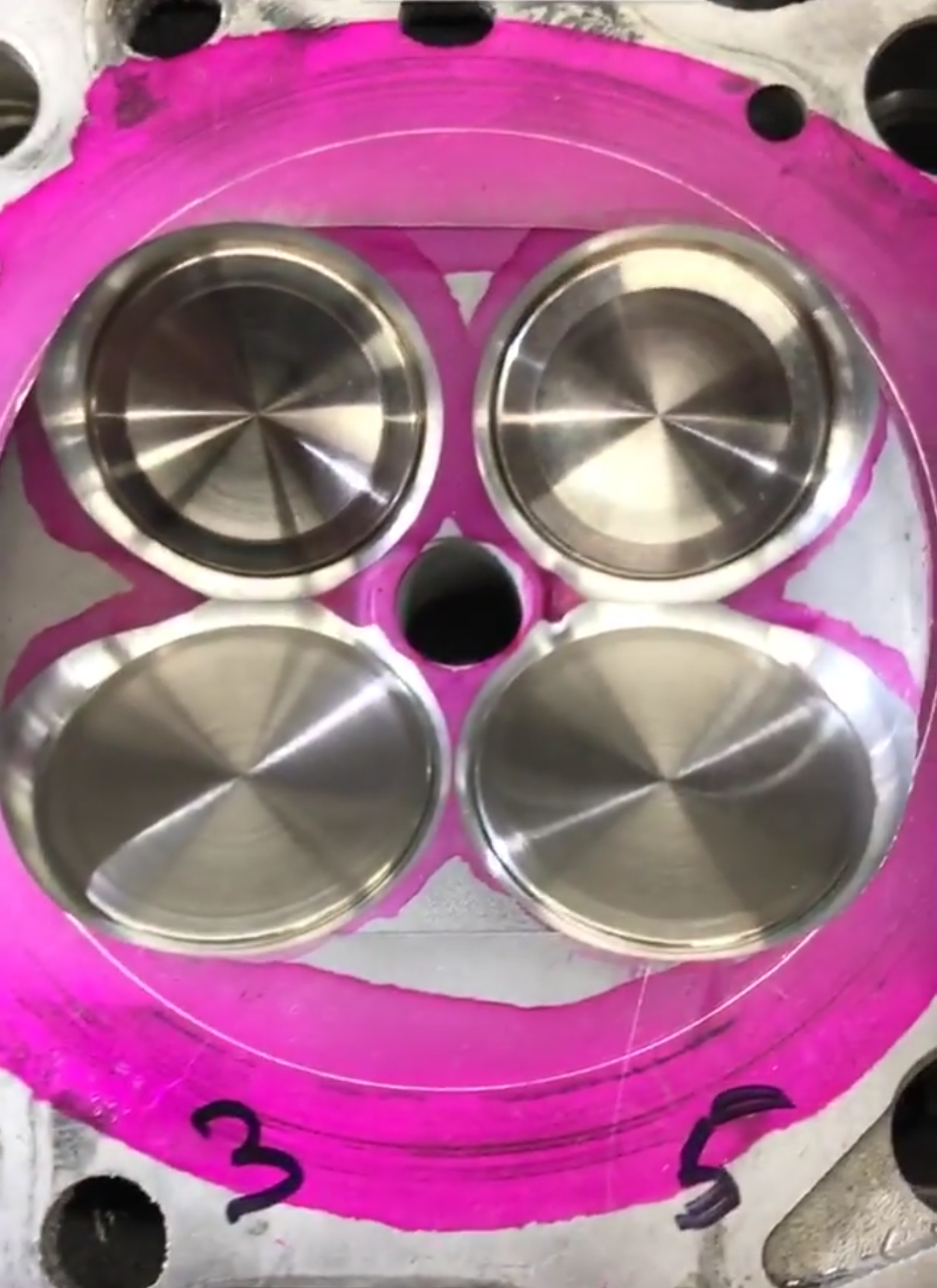

May 15, 2018 | 10:14 AM
This is how it should look (ignore the paint). Notice how +1mm valves are seated inside cut?
