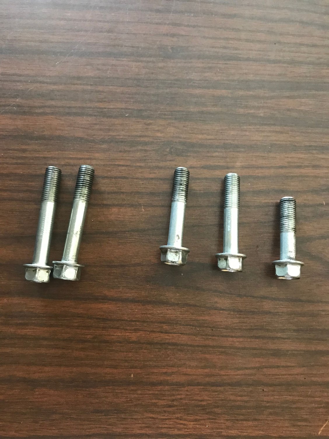

I’m having problems with the bolts that mate the motor to the trans, specifically the one hidden by the transfer case on the intake side. I have all 5 brand new from STM but the shortest one is too short to reach the threads, the next size up tightens up but runs out of threads like it’s too long. Any help is appreciated

the hidden bolt is M10 40mm length, should be the one on the very right.

I know it should be, but it just spins. I know at least most of the threads are good bc the longer bolt starts and tightens down. I guess I’m going to have to buy a longer bolt between the 2 lengths.

Based on the picture, looks like your threads could use some cleaning. I would run a thread chaser on the trans side threads and also the bolt. The bolt length for the middle bolts are 50mm, so inbetween size would be 45mm length bolt. That may be difficult to find that size...

I’ll try but by the time the threads act like they’re gonna catch the bolt head is against the block. Its weird...
