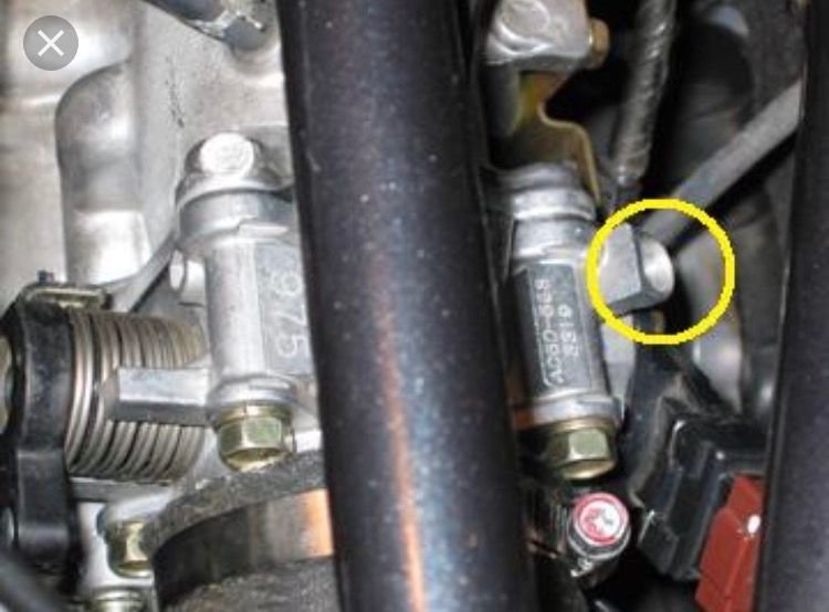

Sometimes the ecu learns how the car used to run and now with the new IAC valve it may have changed that. Try cleaning the throttle body first and see if it helps if not adjust the biss screw with the engine running until your car idles around 750rpm. Considering the car doesn't have cams.
