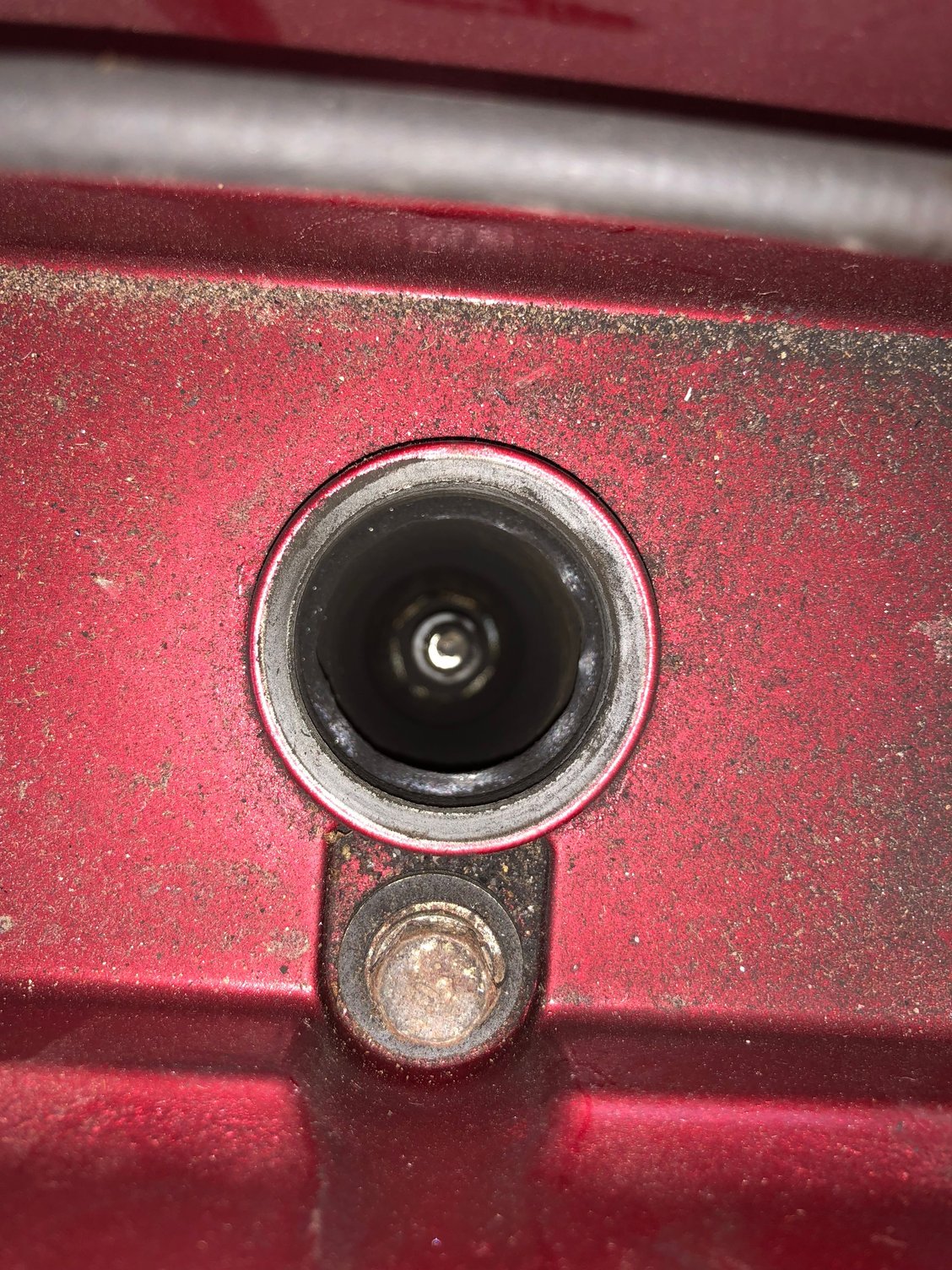

So I think I found the problem seems like one of the spark plugs is loose. Cannot get the plug/wire to fully go on the spark plug. I was thinking of ordering new plugs tonight!
Heres a video for reference!!!
https://m.youtube.com/watch?v=CFxkBw9JSSE#dialog

Glad you found it. That sound is slightly nerve wracking!

I had a feeling. Any damage to the threads or plug?
