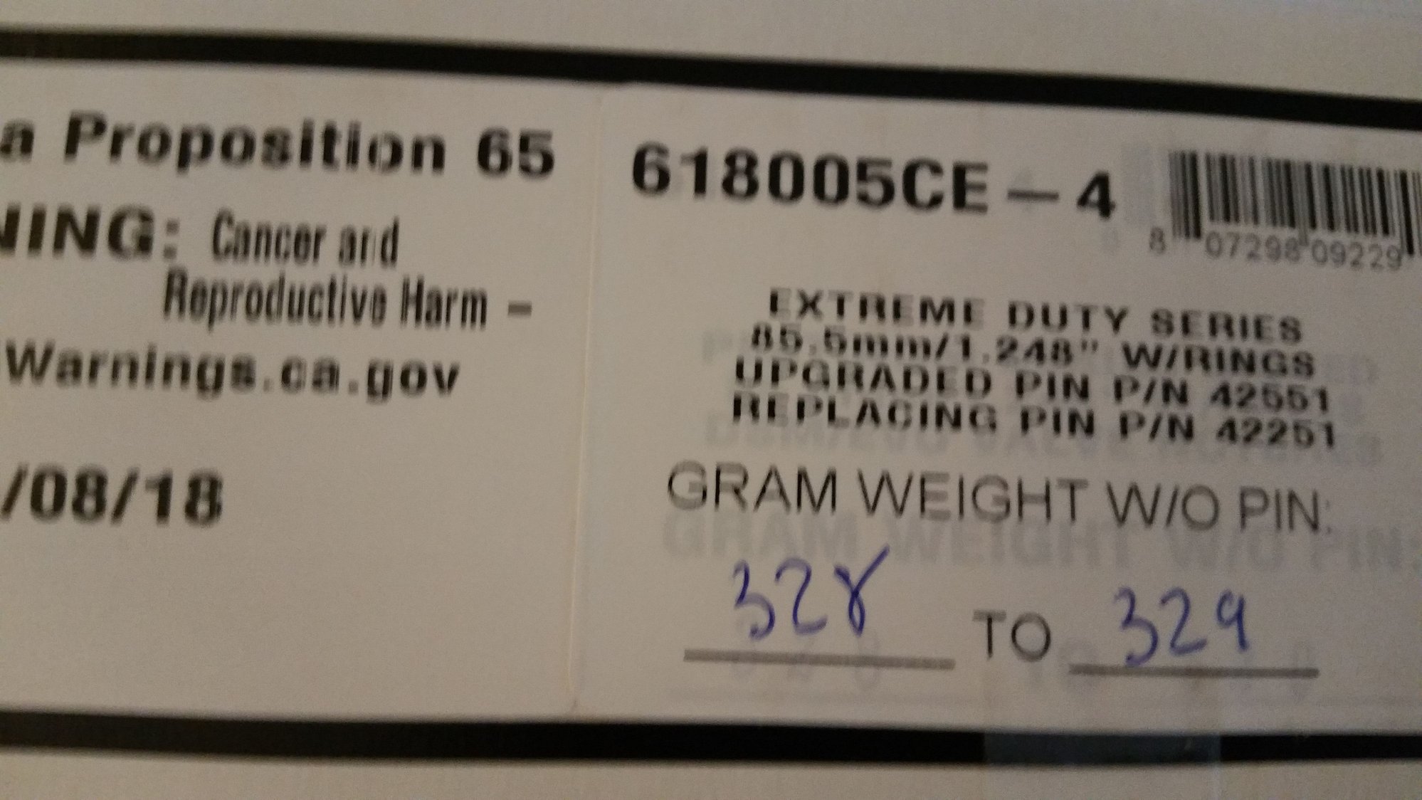

Are you sure about Manley = 527g? Did you mean 327g (w/o wrist pin and locks)?

Sorry...I meant 327g...typo...lol* So Manley 327g vs the JE 299g.
But okay...I was a bit confused by that myself but I suppose people just round differently. Haha.
Thank you for the arithmetic though!
your 0.040" Over puts your piston diameter at 86mm. Mine is 0.020" Over so I'm at 85.5mm. My finald displacement is 2.159L. Just a tiny bit smaller displacement than yours.
