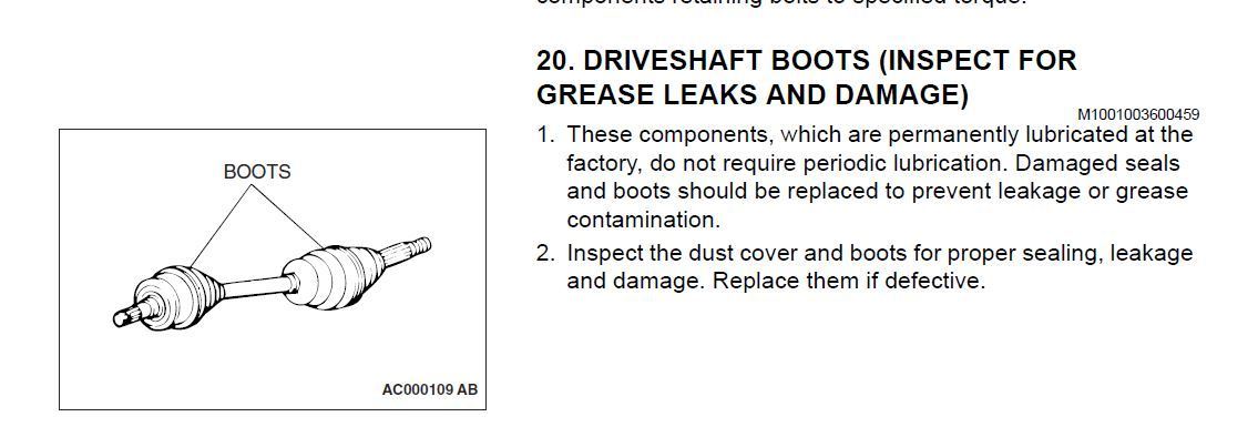

Old Nov 4, 2018 | 01:07 PM
Heres a clip from the SM. Might make you feel more at ease. If the boots are intact, its likely the lube is OK as well

FWIW, I've never seen a CV joint tgo bad as long as the boots didn't tear and release all the grease. So, just make sure to inspect your CV boots at every oil change. If you see one torn, or possibly starting to tear, or already leaking, plan to replace it soon. And replacing boots is pretty simple. No need to buy an entire axle.
