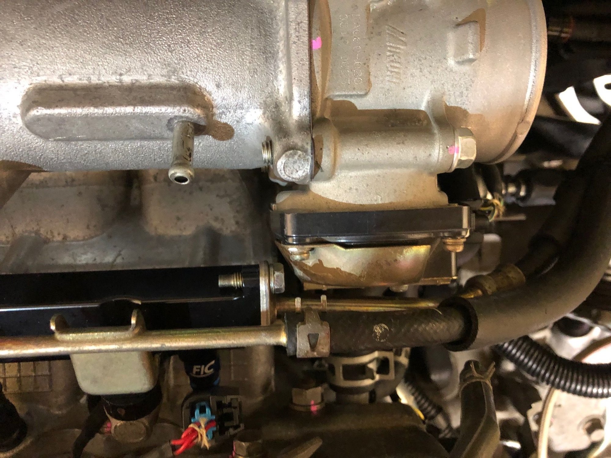

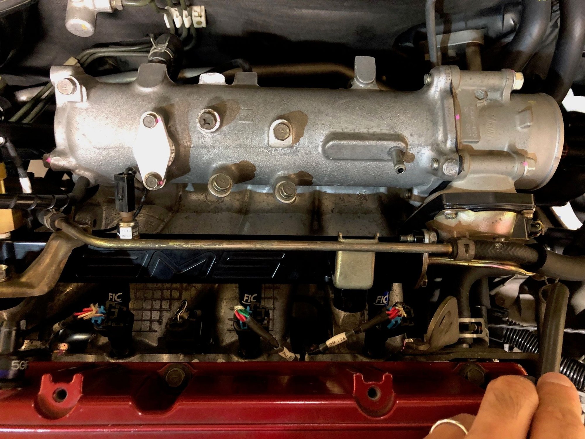

I use aftermarket fuel rail.
https://www.amsperformance.com/produ...ors-rail.html/
I use 4G69 TB.

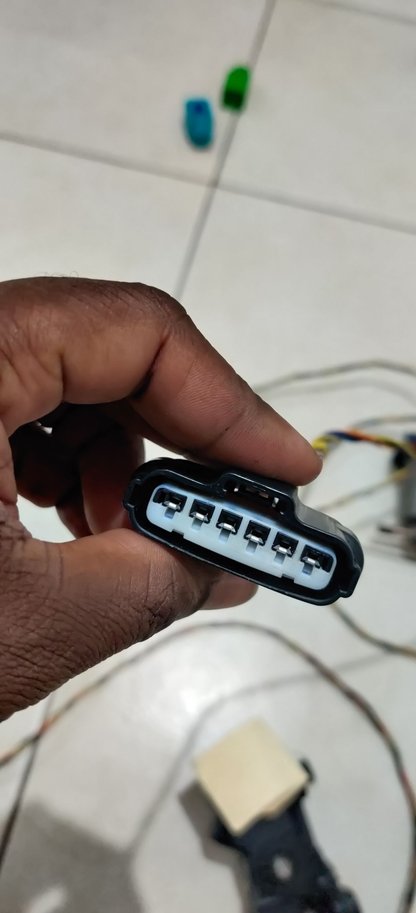

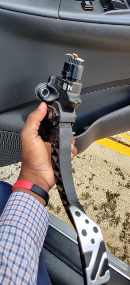

Oh thos pics are mint thanks for sharing. My fuel feed gonna be using an AN fitting a pretty big one and aftermarket lines so I think I may still have to use a spacer. I have already ordered evo 10 pedal I think I gonna order 4g69 tb and the same toyota plugs and put everything down till I get an ecu.

Got me an evo 10 pedal waiting throttle body. Have to order a pigtail for throttle body

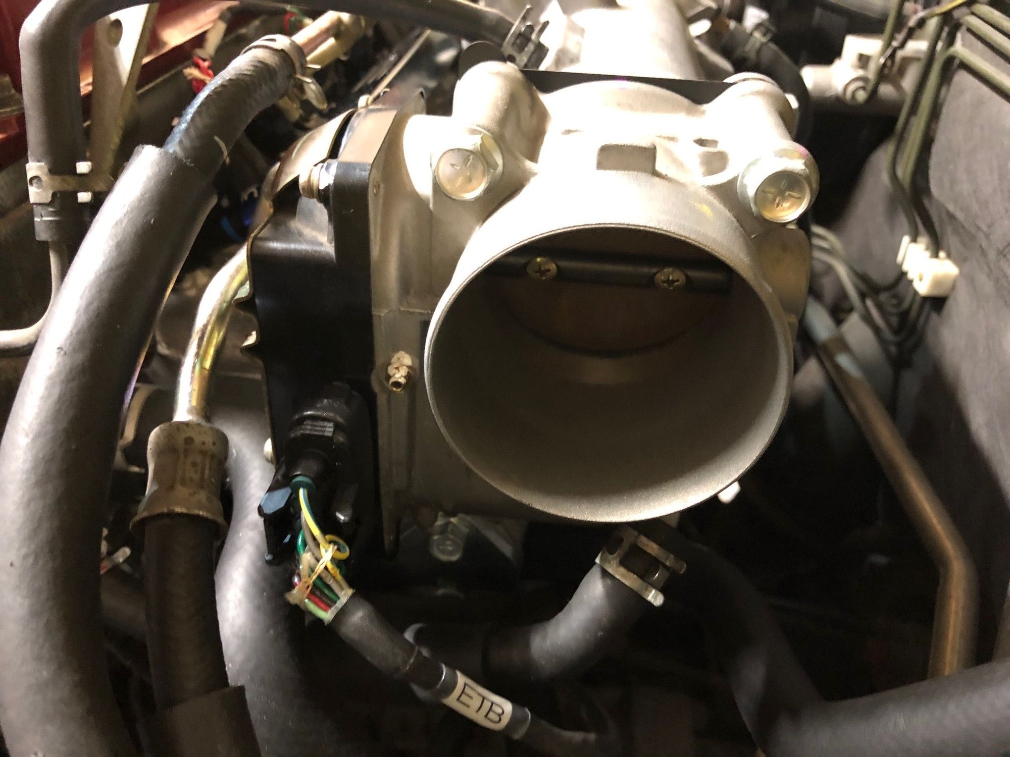

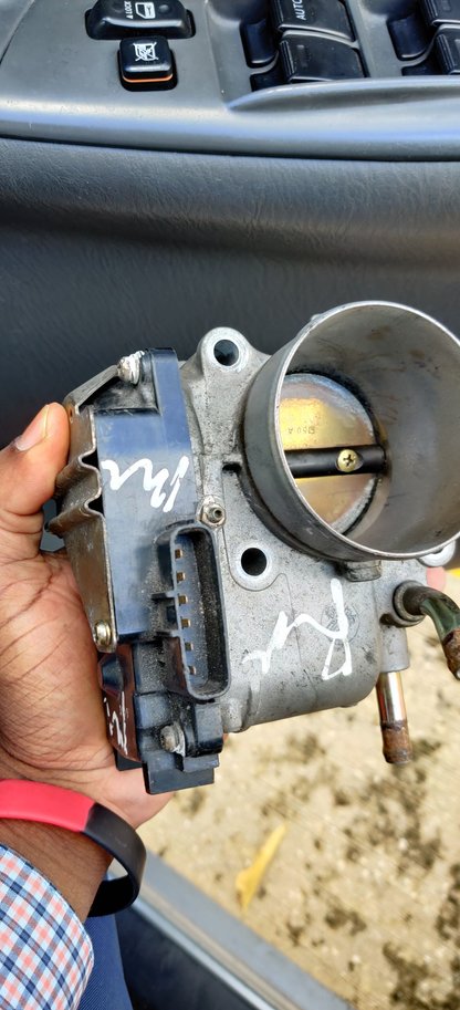

I got me an evo 10 pedal and a tb off a mitsu grandis

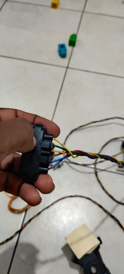

Any progress? I just wired my evo 10 pedal about to do the throttle body and test on Emu Black.

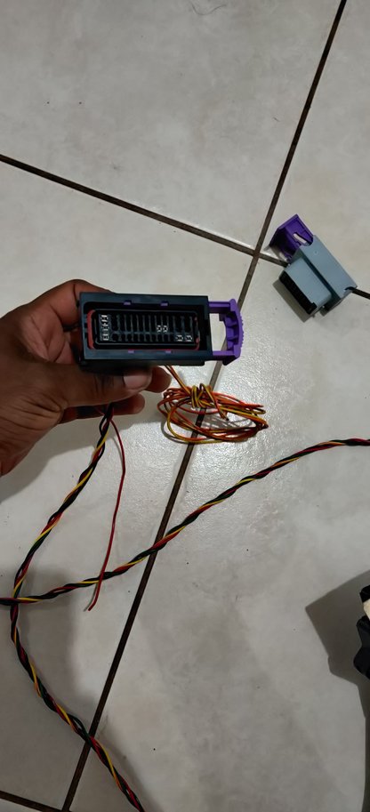

This thread has been the most helpful thread I have ever read lol on the internet thank you so much for sharing your knowledge. I just finished pinning the throttle body and pedal to spare ecu connector. So tomorrow I will be testing on my Emu black if all goes well I will just need to get a plate made to convert the pedal to work in my Evo 4.

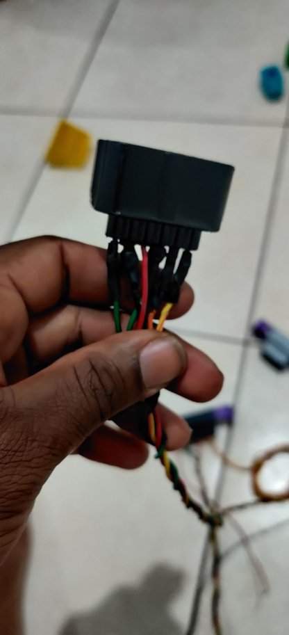

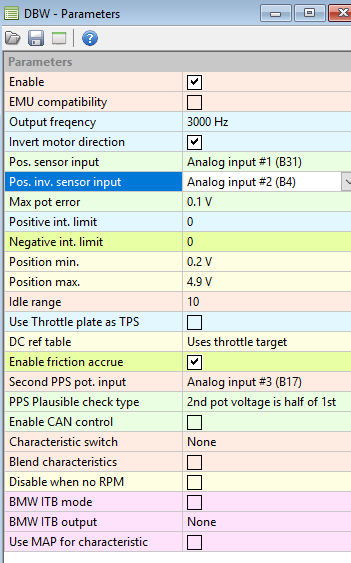

I am having world of stress. Tried the wiring provided here got nothing. Tried the one in the ecu I get a click when powered on a whine i can har if i put it next to my ear. Assuming cause its powered. But when i try to calibrate i get noting but an error saying the tb has not moved make sure it has power.
Old May 8, 2020 | 06:16 PM
  #43
Bajanhitman's Avatar
Joined: Apr 2011
Posts: 38
Seems my tb is dead either came that way or bad wiring on my part so I have to source one
