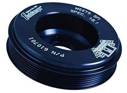

The simple answer may be this:
The fluidampr helps in reducing torsional vibration in the crankshaft, I believe this is different from the purpose of balance shafts, in that they are designed to reduce 2nd order vibration.
My opinion is this is more useful on the other end (flywheel) because of the short fistance between #4 and flywheel, mainly to help with #4 oil journal cracking issues. I know many don't agree, but that's my opinion.
