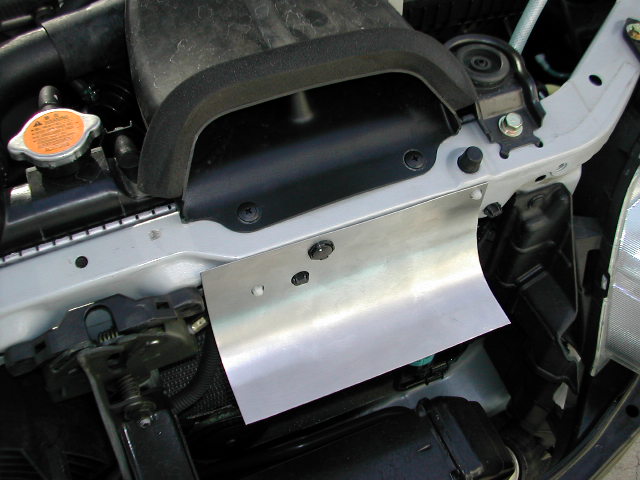

Ok I have already spoken to n00dle so this is not a hijack. Props go to Prototype_fab and Monster Sport for the innovation and to n00dle for bringing the idea to the DIY crowd. I made this today out of some sheet aluminum. Holds up to at least 120mph winds

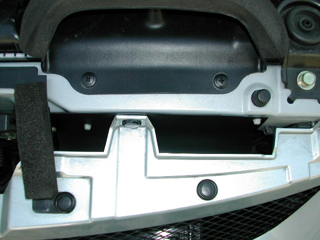

btw, I found that I really didn't need to pull off the front bumper, just push that support tab out of the way a bit for clearance.

Looks good. You found a different way to mount it. Just clean it up with the new one you're making to replace it. If you have a OBDII logger you can see if there's a difference in intake air temps with and without the guide.
