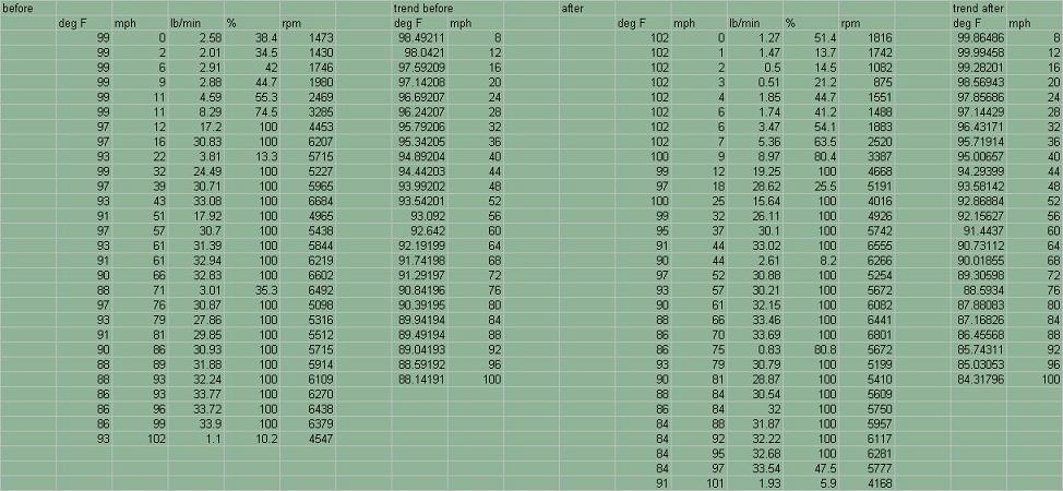

Here are some logs provided by Kam.
edit: easier to read this way.

Here's a quote from Kam "I believe the temps start off higher because I ran the test back to back at full throtle. The engine was therefore hotter to begin with after I installed the mod. (It takes about 15sec to install.) I think the important information starts after 40 mph, where the two trend lines cross (where the temps are the same)."
