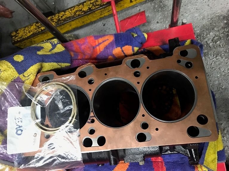

Bras/alloy flame rings with a crush allowance for the 60thou/1.5mm copper HG with Custom Age head studs in my 2.4lr
An overkill for my boost. They can hold 100+ boost
Why though? If you ever have a cylinder pressure spike for whatever reason , the head gasket blows and everything else survives. You put the strongest HG possible in it and you bend rods instead. Personally I wouldn't run anything crazy unless I was actually planning for over 35-40 psi.
Yeah I understand your point for a non built engine. My engine builder wanted this
My thoughts went out the door when I saw 3 dry sump race engines he just built
Was just saying what HG ended up in my built engine. Overkill for 32psi, prob yes

I think he wanted your money more than anything
I kid, but personally I'm all about that OEM HG life. Even on a built motor- although I typically don't shoot for crazy HP numbers as I'm more of a road course/rally guy.
When I build my 2.4 I'll be running around the same boost as you, but I think I'll end up going with an HKS or cosworth or something since the OEM doesn't fit very well.

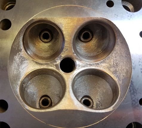

C.Chamber out to 87 and CR about 10.2ish
