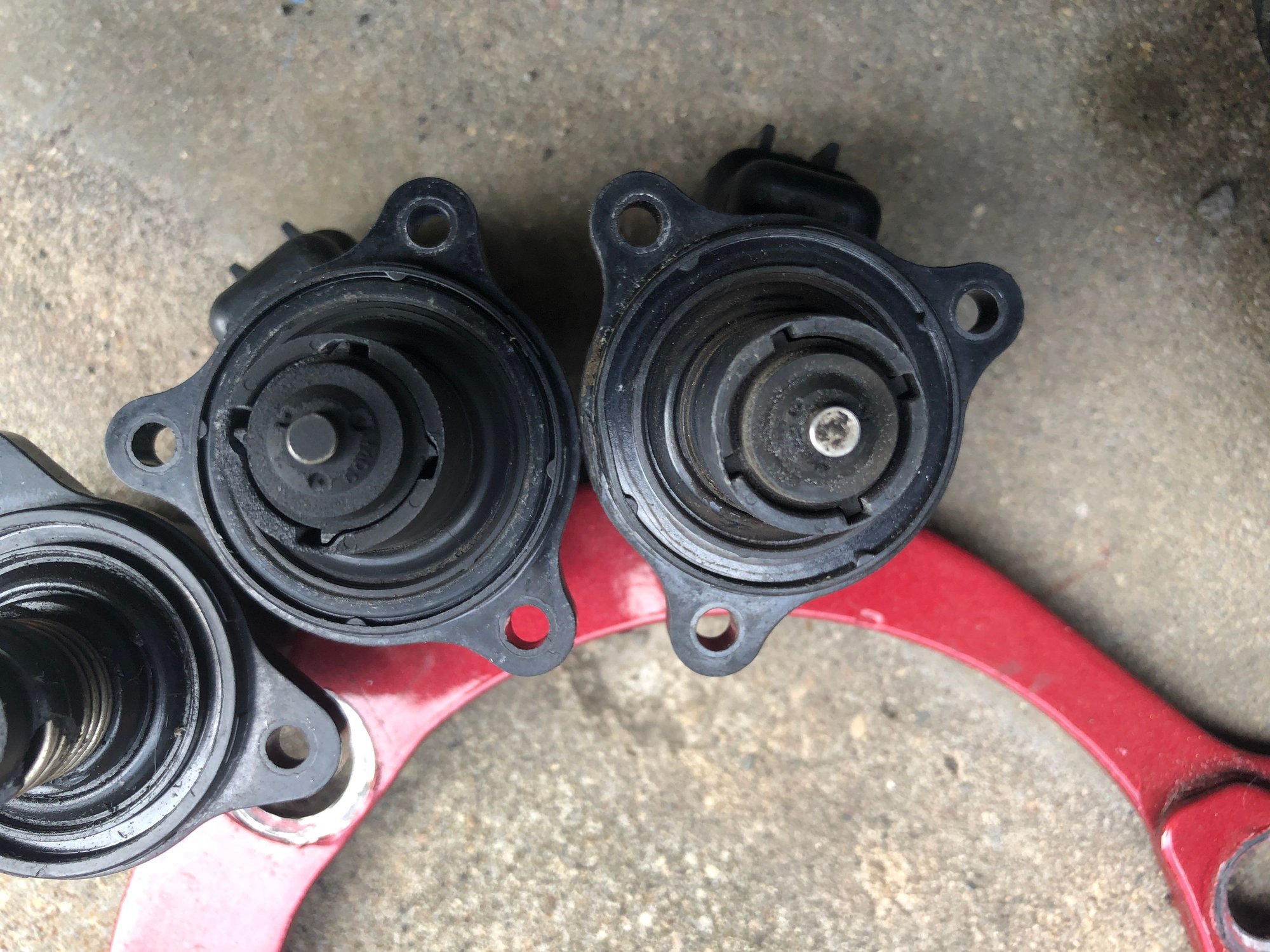

3) In the photo below. Left is what was in my evo 8 and was not idling well. Right is what i put in and fixed my issue. Is the one on the left simply designed differn't, or it is a way to detect a worn out IAC?

On the Evo 8 IACV, the four raised ridges around the circumference of the inner plunger barrel get worn down, and the slots in the outer barrel get worn. You can see this on the one you replaced. This eventually allows the inner plunger to spin at the higher extensions, so it no longer moves in and out and cannot control idle. The answer is to use the one off the Evo 9 with the external spring. This is a better design and does not suffer from the worn ridges problem.
That was my guess. I just never saw it documented anywhere before. It is good to know there is a way to visibly tell its getting worn out.
