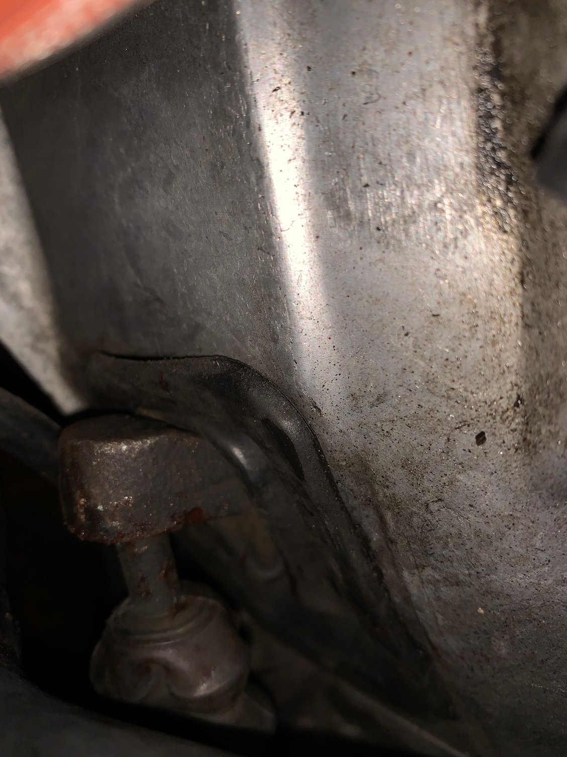

Went to take my son out for Trick or treating, backing out in reverse, and suddenly I heard a snap. Opening my hood it appears the connector between the slave cylinder and the clutch fork is snapped. So right now the clutch pedal is stuck in position but I can still shift into all gears. How screwed am I? Do I just swap the slave out? Can it somehow be hammer back in?? See the pic I have attached. I’ve also included a photo from STM with the piece that snapped out circled in red.

All I can tell from the photograph is that the slave cylinder is overextended. My guess is that the throw out bearing has detached from the clutch cover. Is the clutch pedal on the floor?

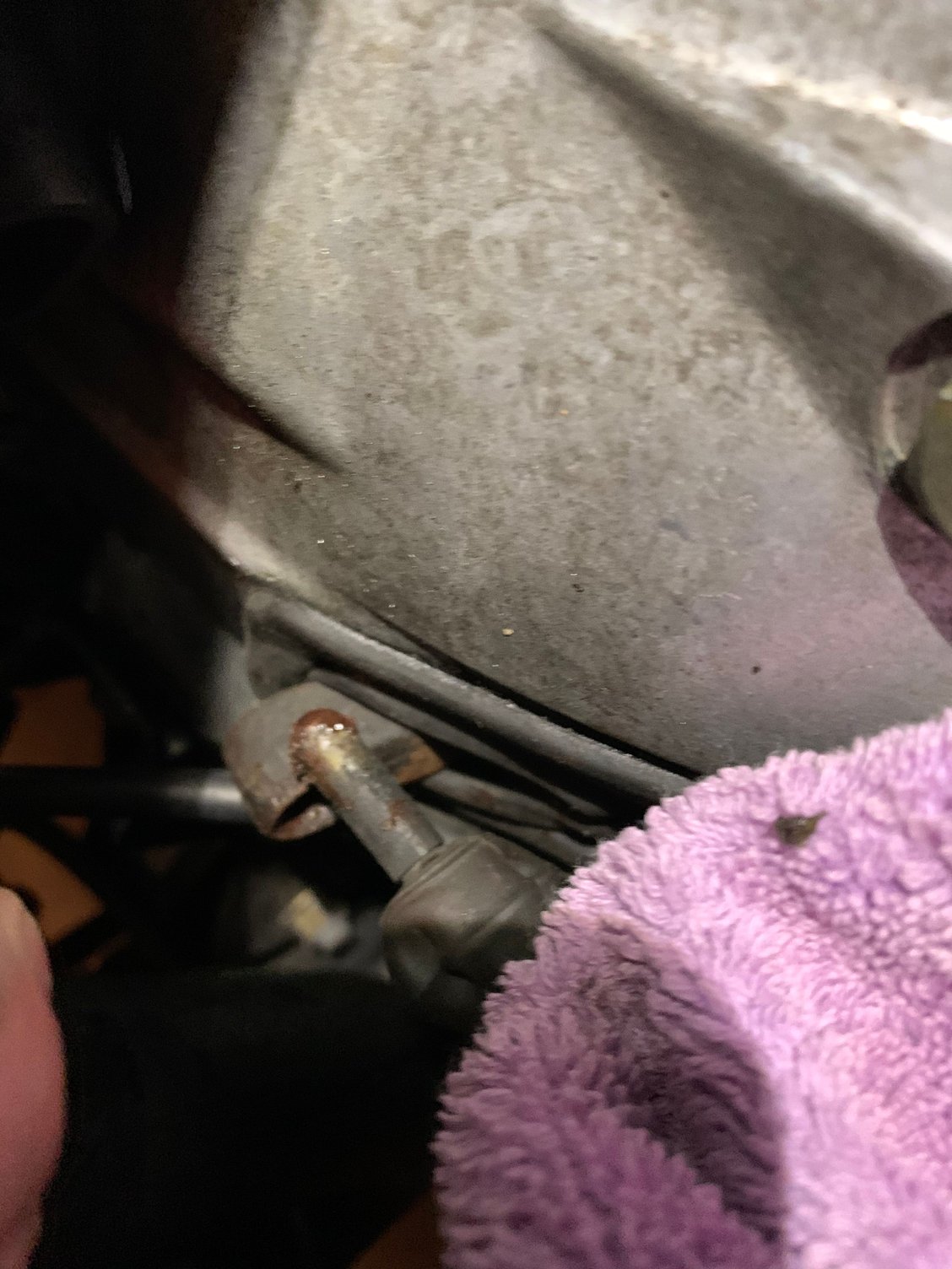

When it snapped, it went right to the floor. The piece that is circled is fully detached from the clutch fork. Hard to tell from the photo I posted because I tried to push it back in. Now the clutch pedal is stuck at about 80-90 % up (closer to its resting position) and far away from the floor. It won’t let me push it in at all. Gonna take another photo in a minute

If it really is the slave then slap on a new one, bleed, and good to go. Can the old one be reassembled? I suppose but where do you get the part that is broken?
With a slave cylinder in hand, if you pull off the rubber boot, you see the aluminum piston, the push rod comes off with the boot, it is a separate part.

Here’s what snapped off
if I just need to replace the slave then great that’s easy enough to do!

Sorry, but that is not snapped off. I have a brand new slave cylinder on the bench here with me and it looks the same. That is just where the push rod presses against the throw out arm. Most likely the thow out bearing came out of the clutch cover. Its the bane of pull type clutches. Others can chime in but probably what is required here is pulling the transmission. If you have to do that, might as well figure on a new clutch (or at least a new clutch disc) and a monoloc.

I wouldn't say confirmed but the most likely suspect. If the throw out bearing did come out with a monloc its the first I ever heard of. Anyway, I'd suggest putting the car on stands and pulling the rubber plug located at the bottom of the bell housing for a peek. It could possibly also be a broken throw out arm (unlikely but possible). The transmission would have to come out for that too. Or maybe a trashed clutch. Still, the same story.
If the throw out bearing did come out of the clutch you may try snapping it back in. Put a large socket over the end of the throw out arm and give it a good yank towards the driver's side fender.
