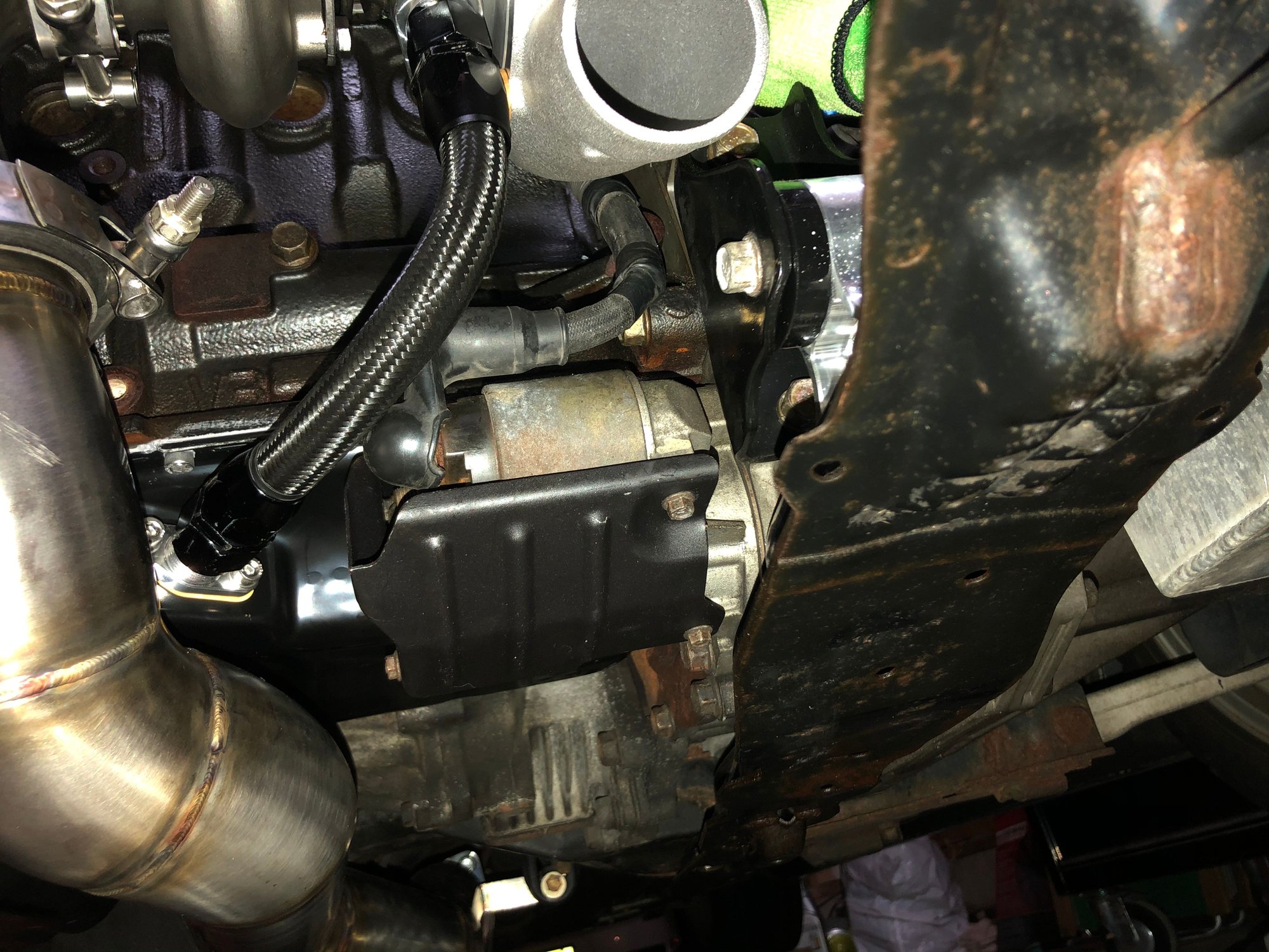

Hello, I am installing a bottom mount 6062 turbo and a Sheepey hot parts kit kit on my evo. I am at the point where I need to make an oil drain line for the car and it seems like it is going to be very close to the starter. Does anyone else have any pictures of their setup? I have a -10 PRL ported drain flange, which should help with draining the turbo, but i want the line to be positioned in a way for the best drainage possible.
Please let me know if you have any experience and please give me some pics!

Looks can be deceiving, there was actually enough room for the line, no problem. The problem was, STM includes a 45 degree angle fitting with their kit, which is not suited to Sheepeys extremely low mounting position. I ended up using two straight -10 an fittings. At some point, I think I will go back in and make another drain line that is about 1/2 or so longer than this one, as the bend is a bit tighter than I would like. Thanks for the reply everyone!
