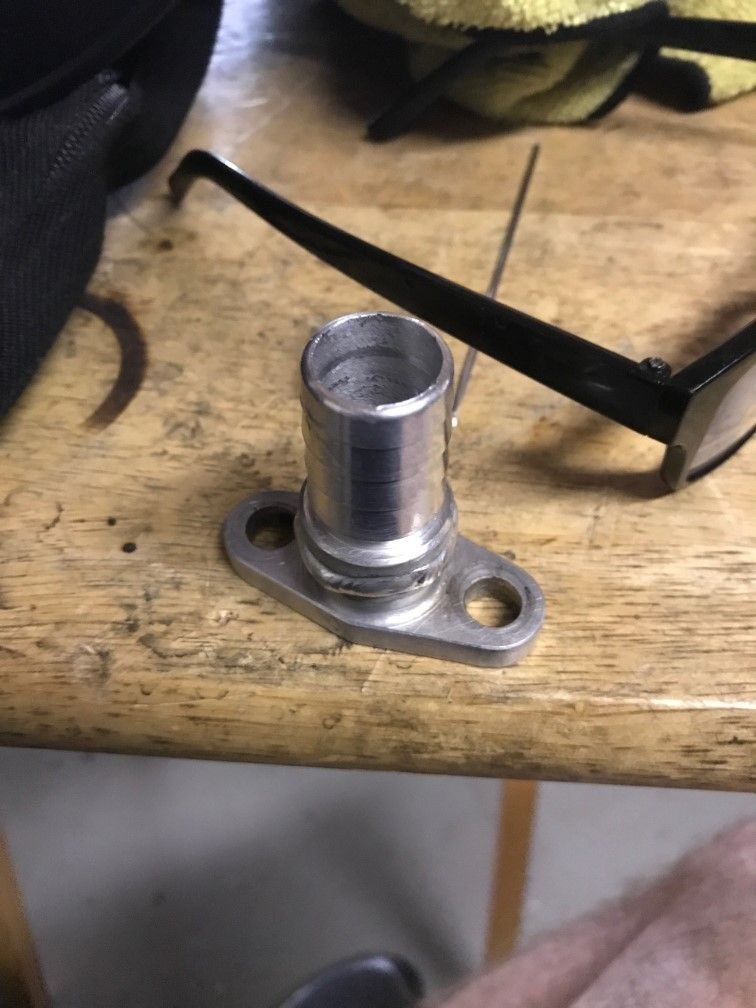

From: Charlotte, NC
Just a little update. Car is running well with no complaints, but started to smell burning oil so I put the car on the lift. Definitely oil coming from the turbo return line drain, but the line was soaked externally from top to bottom. The hose was purchased from a local hydraulics shop and they said it was rated for oil at high temp despite it saying "Gasoline" on the outside. I was originally going to just run a short piece between the hardlines, but the hose was flexible enough that I just ran it in between the turbo and oil pan instead of mostly hard line. My buddy also warned me the long tube headers can more around after being heated so I wanted the ability to absorb the movement. I had just a 2" piece of straight tubing welded to each of the flanges, but I don't think it was sufficient for sealing. When I removed the tube it had hardened at the ends so I bet it was just blowing oil past the clamps.
I ordered a pair of 3/4" barb weld on fittings and replaced the straight tube I had welded to each of the flanges.
And installed...
I ordered some hose that is rated for high temperature engine oil so it should arrive Wednesday. Fragola Performance Systems Series 8000 Push-Lite Race Hose (803012) is -12 hose rated for oil at 300F.
https://www.summitracing.com/int/par...3012/overview/

Old Aug 12, 2019 | 06:19 PM
  #135
Strm Trpr's Avatar
Joined: Jan 2007
Posts: 201
Likes: 9
From: NorCal
Nice!
I’ve had bare oil return hoses get brittle and crack when they’re near a bare DP.
The DP is now wrapped and I treat oil return hoses as a replacement item that gets inspected every oil change and replaced when needed.
