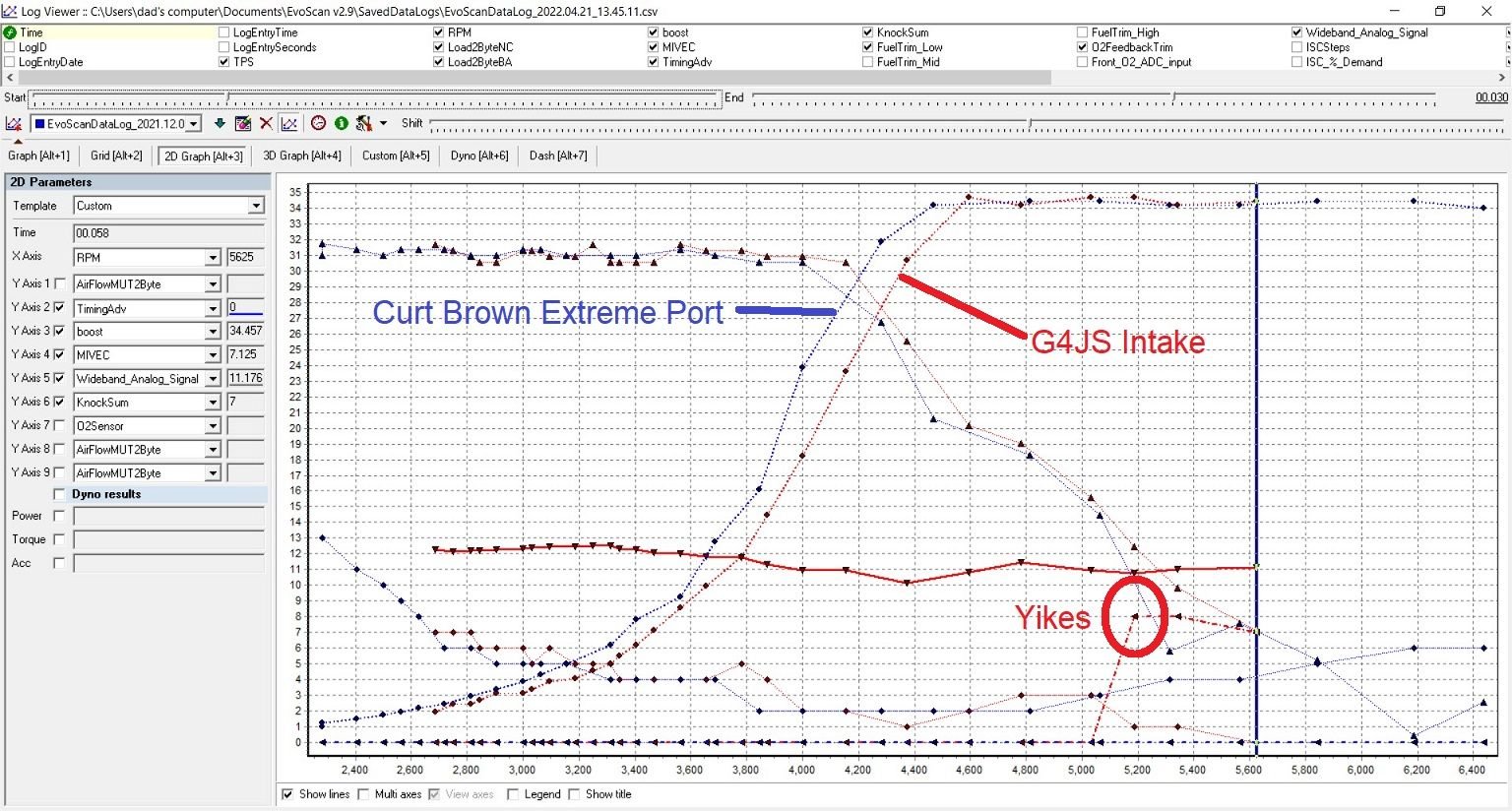

Knock Knock
Who's there
8 count

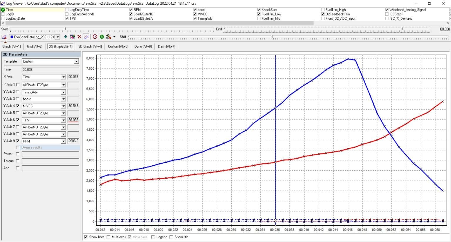

So this was just the initial pull after being warmed up so it should be ideal for log purposes compared to the last log I posted in this thread for spool in 3rd gear. The car almost never knocks so to see an 8 count is simply not normal and would suggest Abacus is a wise man. It repeated this knock several times so it is consistently there once into boost.
What the above graph doesn't show is that if I compare the time to sweep from 2000rpm to ~4200rpm the Curt Brown Extreme ports does it ~73% faster and this is something I can definitely feel when I stomp the gas at 2K RPM. This may be the shortest lived mod I have ever done because I'm not gonna keep boosting when I know it will knock.
