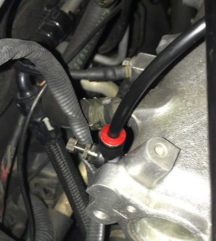

So the mini air regulator arrived today and it works like a champ. I quickly realized that even with the regulator all the way open it was not enough to compensate and keep the engine running when I clicked "Speed Adjustment Screw Mode" in EVOSCAN. I ended up setting the air regulator to about 1/3 of its flow and then used the throttle stop to get the RPM around 950 when "Speed Adjustment Screw Mode" was activated. I then locked in the throttle stop and adjusted the TPS to 13.33% and used the mini air regulator to make an incremental change. Funny, I've never played around with this feature in EVOSCAN and it took a long time to finally get the idle steps down and ISCV Demand down from 24% to ~8%. I had to blip the throttle about every 5 minutes for the ISCV Demand to lower again and it still has to update again since idle was slightly over 1000rpm, but all and all I'm happy. I hope this resolves some of the small idle crap I see from time to time. Here is a good link to how to adjust the throttle using this EVOSCAN feature.

  • The FB 70mm TB doesn't have a BISS screw and I don't want to use the throttle stop to lower ISCV Demand, which is about 25-30% from memory (62 steps with AC Off). I've ordered a mini air regulator (meter in) that will screw into the intake manifold via 1/8" NPT port and connect to another 1/8" NPT port on the intercooler pipe. It will act just like the BISS and allow for an adjustable amount of air to enter the intake to hopefully lower ISCV Demand.

I have used those mini regulators before so I will be amused to see it work as a biss screw on an Evo.

I don't know what you mean by "drill it out?"
The air regulator in the link is exactly the same except it is nickel coated and twice as expensive. You can certainly just add a valve to the intake to leak air as suggested if you are running SD, but it needs to be a "meter in" regulator because they have a one way check valve. Because I run MAF that is not ideal since it would put un-metered air into the system so I just connected it to a port on the upper intercooler piping. It works exactly like the BISS so a very cheap and easy way to add that capability if you have an aftermarket TB with no BISS.

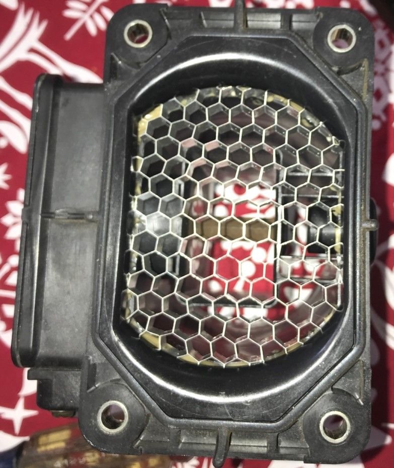

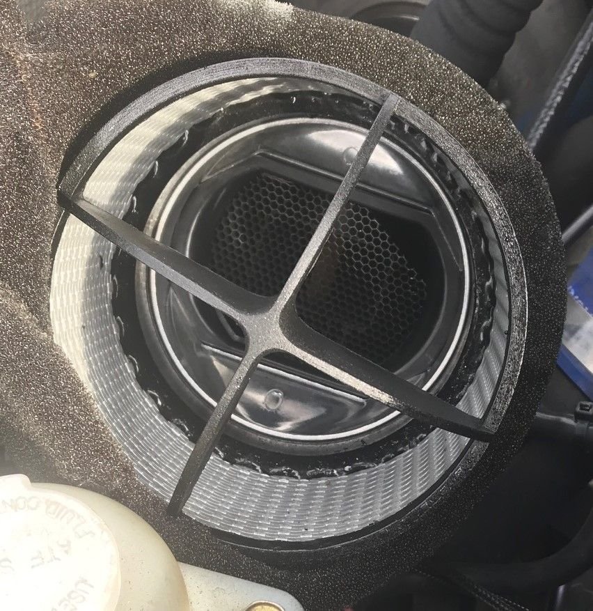

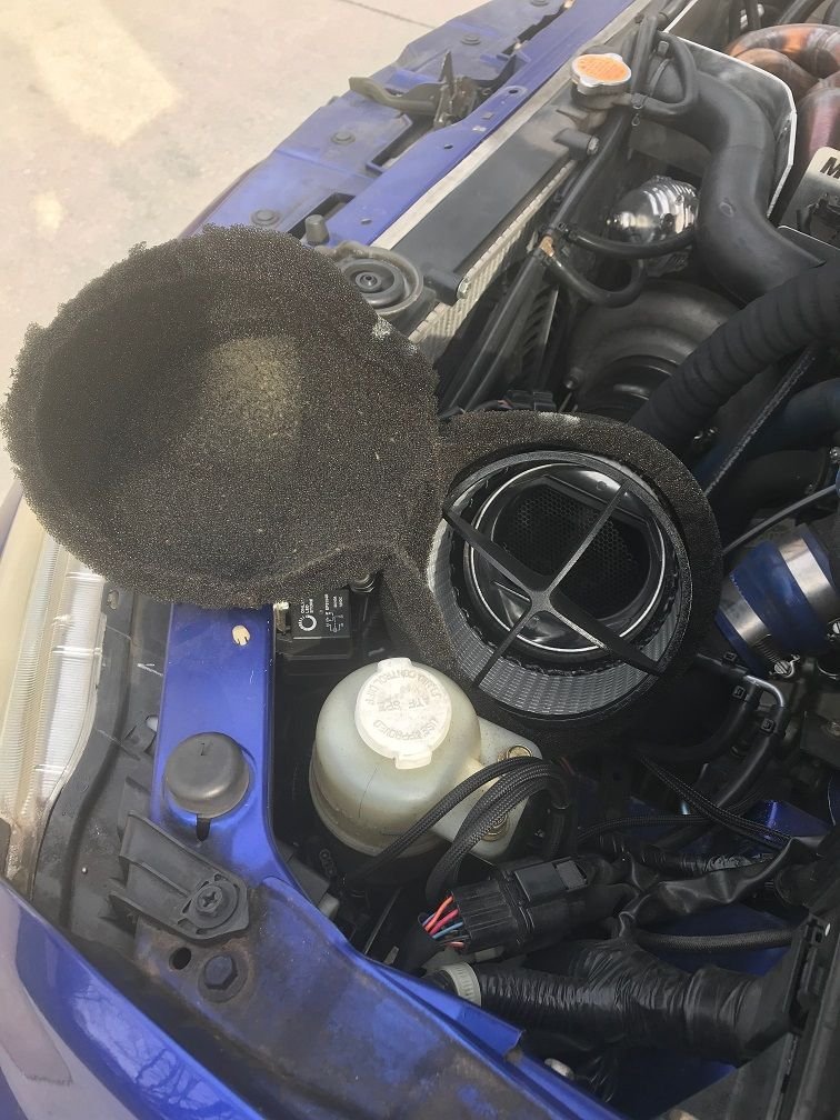

The stock MAF screen already took a dump so constraining it around the edges with adhesive is likely required. Weird how it twisted the screen and collapsed the cells to do it so unsure what causes it to want to twist. It also blew the top of the foam filter off despite my slightly angling the recirculation tube towards the compressor inlet. I went ahead and bonded the larger MAF screen to the housing so it will be ready to go once it dries and hopefully doesn't fail again. Not sure if I want to run another foam filter, but perhaps it failed due to it being so dang old.

Got the new MAF screen bonded into place so I am only waiting on the new intake filter to arrive. I opted to use a tradition filter vs the foam filter, which should arrive later this week.

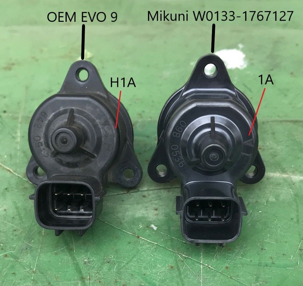

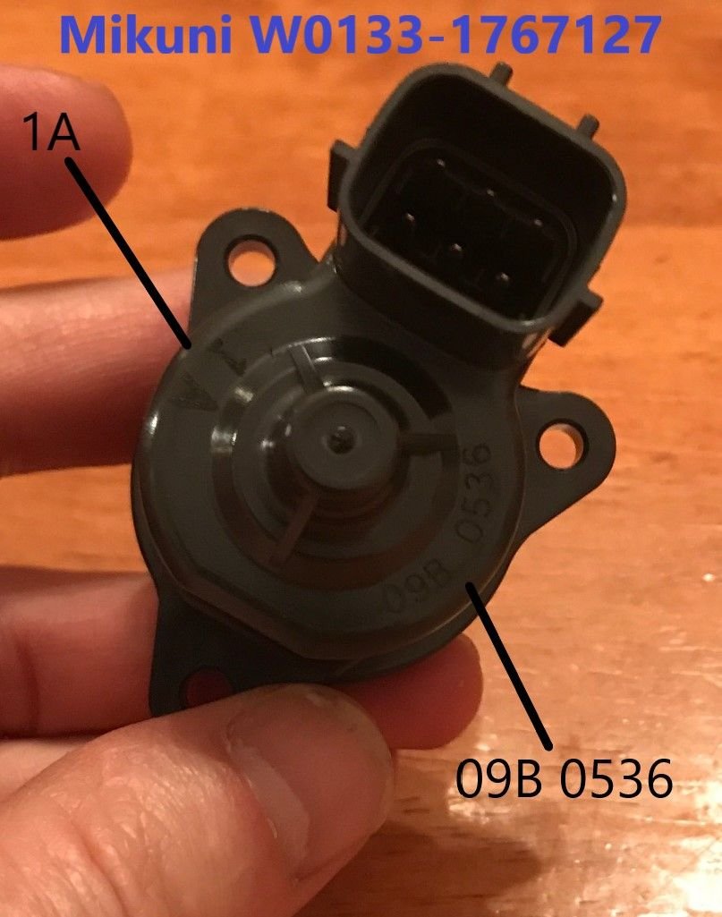

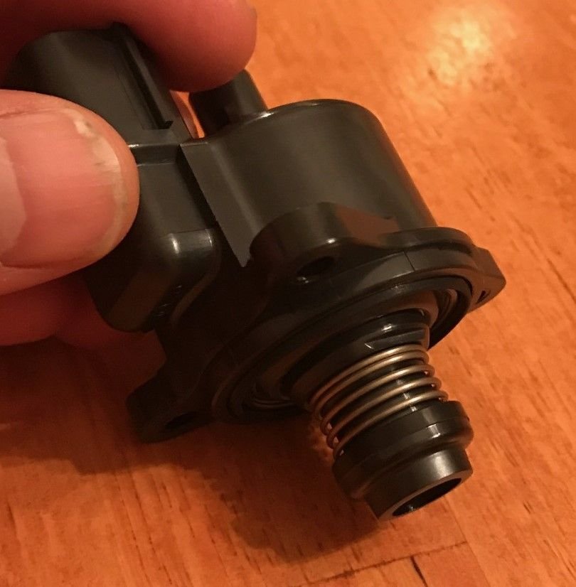

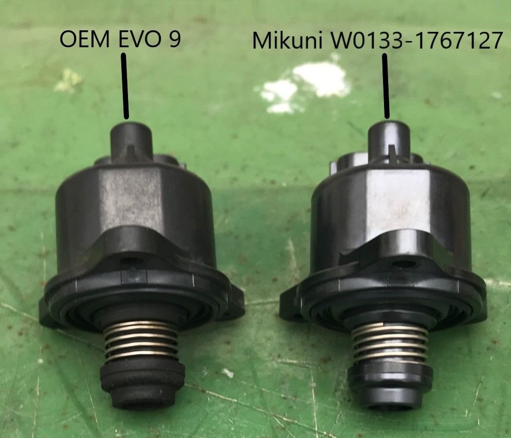

The new IACV arrived yesterday from PartsGeek for $225 shipped. I spent about 1hr trying to track down the OEM supplier for the IACV so I didn't have to pay $400 from Mitsubishi. The manufacturer of the IACV for Mitsu is Mikuni so after searching their part numbers I believe I found the OEM IACV at almost half the price. I'll compare the part numbers stamped on my OEM IACV, but the 1A stamp and the external spring indicate it is the EVO IX valve.

So here is a comparison of the stock EVO 9 IACV vs what I purchased.

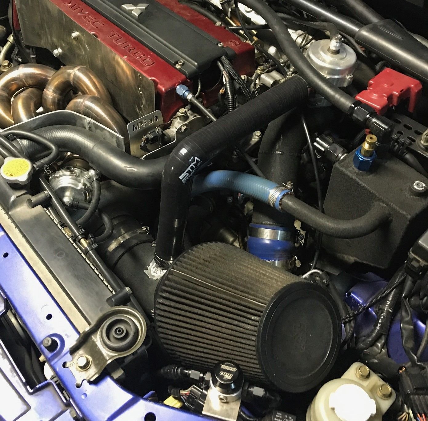

The new Green filter arrived today along with a fresh set of plugs and a new BOV dump tube for the MAF setup. Unfortunately, Green Filter incorrectly tagged the filter so I received a similar looking filter, but with a 4.0" inlet diameter vs the 4.5" inlet diameter I needed. Looks like I'll be running the SD tune a few more days, but at least I swapped in the new plugs and the new BOV dump tube.
