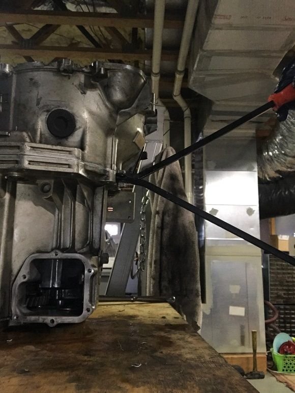

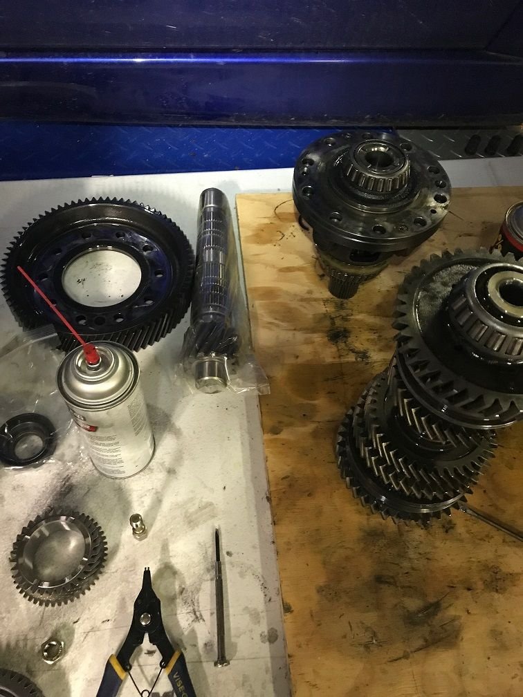

This is what happens when you watch Youtube videos. Swapping the 4.08 final driver and EVO 8 5th gear. Now I just gotta figure out how to take the gears off.

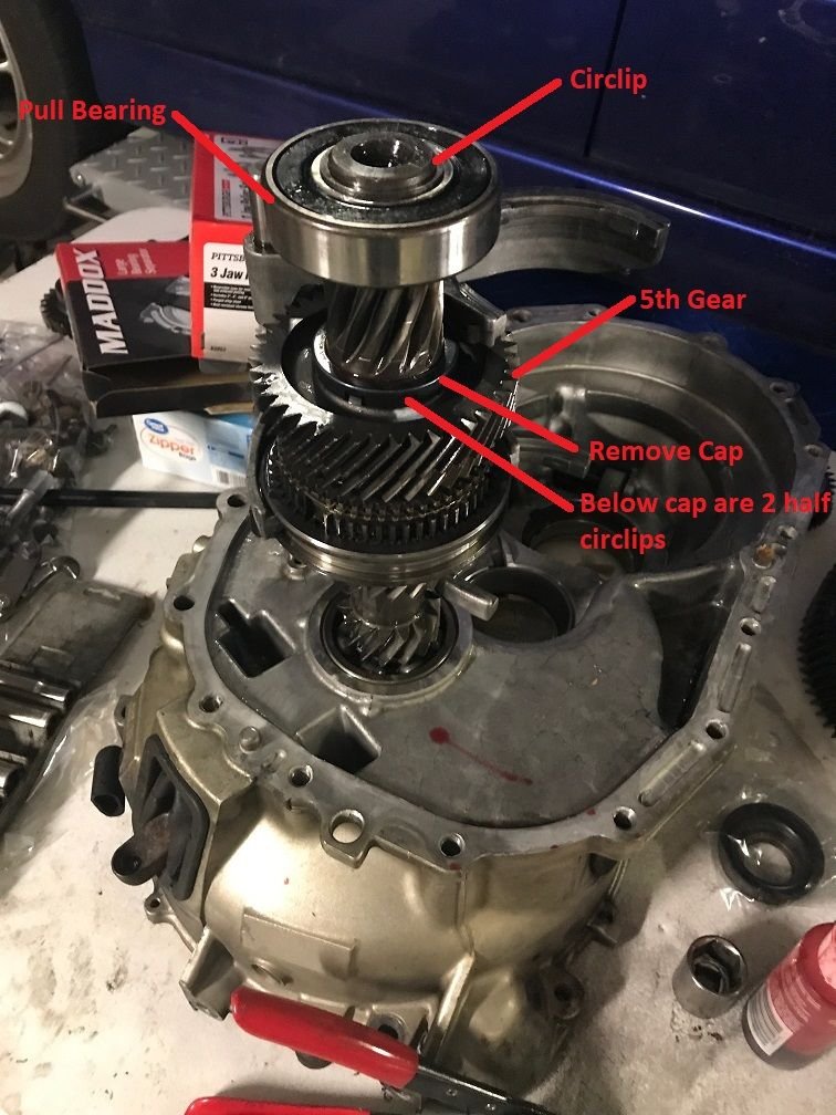

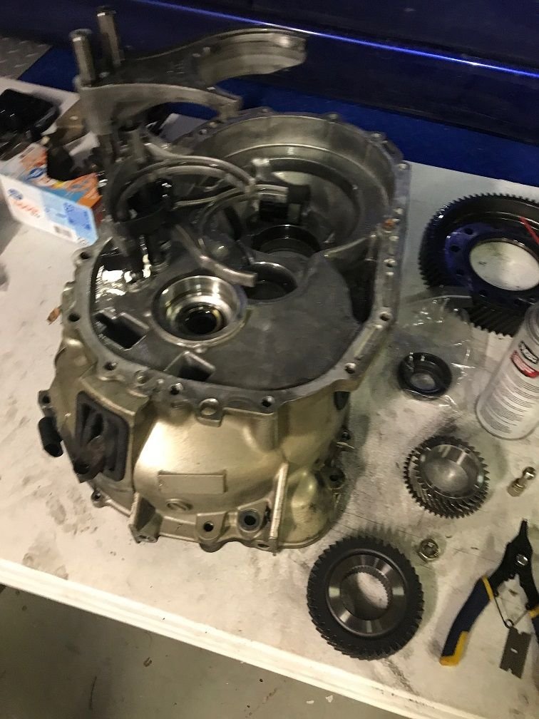

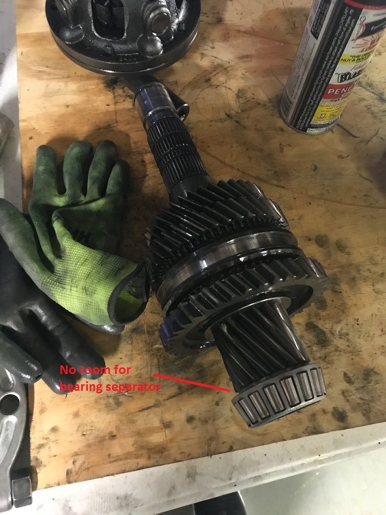

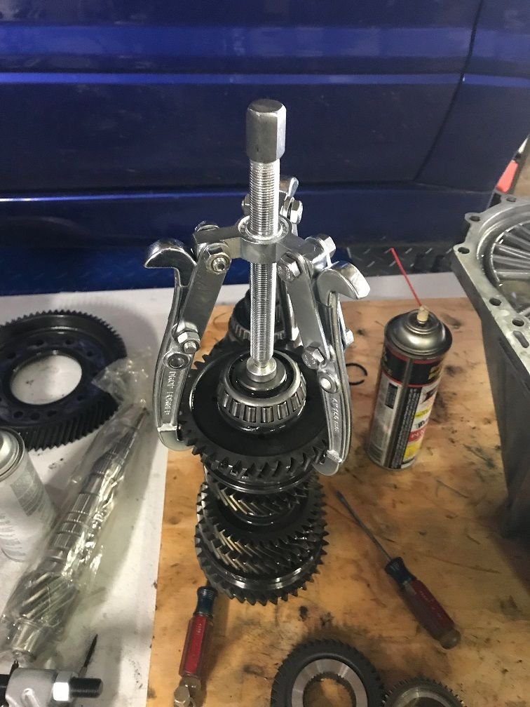

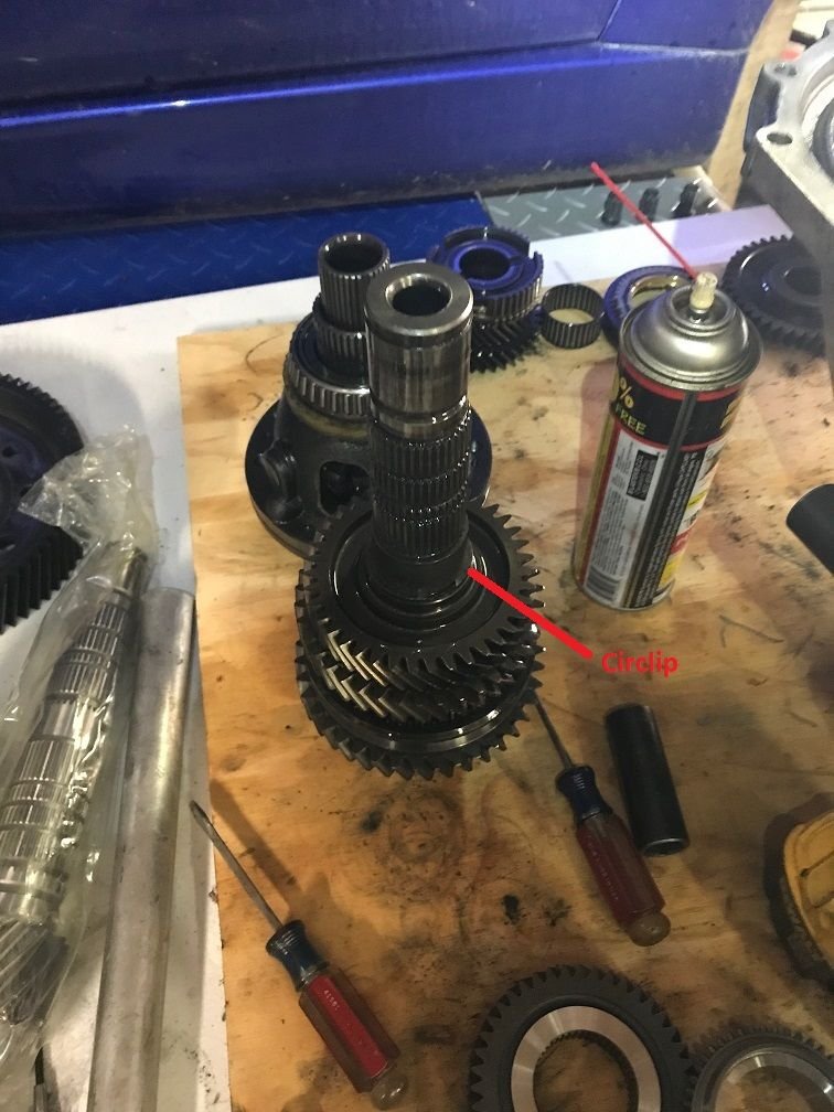

So far this is pretty easy other than working through it for the first time. I've only needed a 6" 3 armed pulley puller to remove the bearings on both shafts, but will also need a press to remove the remaining gears on the output shaft. I bought a set of pulley pullers and a bearing splitter from Harbor Freight, but have only use the one 6" pulley puller thus far.
Once you get the top bearing off the other stuff just pulls off. You then need to remove the circlip using the correct tool. Advance Auto had the proper circlip tool, which they call lock ring pliers for about $16 and made life very easy. Once you remove the circlip you just press off the remaining gears all at once and the press back onto the new shaft and reinstall the circlip.
https://shop.advanceautoparts.com/p/...040%7CL3*16175
Changing 5th gear on the input shaft took about 30 minutes. Remove the circlip using the lock ring pliers and then use the 6" pulley puller to remove the bearing. With a flat head screwdriver gently pry up on the metal cap working your way around the base. Once it is off, below it is a 2 piece clip that holds 5th gear to the shaft. Just use a screwdriver and remove each half and then 5th gear just pops off and you put on the new one. Put back the 2 piece clip and the cap that secures it. I just used a plastic weighted hammer to bang the bearing back onto the shaft setting the other end of the shaft onto some wood. Then reinstall the circlip to hold the bearing.
On the input shaft I just need to press off the gears using my buddies press and then press them onto the new shaft. The only thing remaining is the bearing and according to Jacks you remove with a bearing splitter. However, there is no space between the gear and the bearing sleeve so the only way to pull is to pull on the cage of the bearing housing. I'm gonna call Jacks on Monday, but I may just leave this bearing on there and order a new one to press onto the new shaft. Overall, once you have the correct tools and you get familiar with the trans it is not that big of a deal to work on.

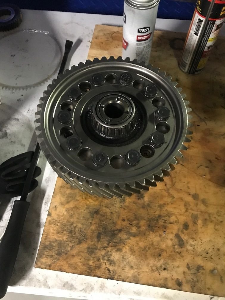

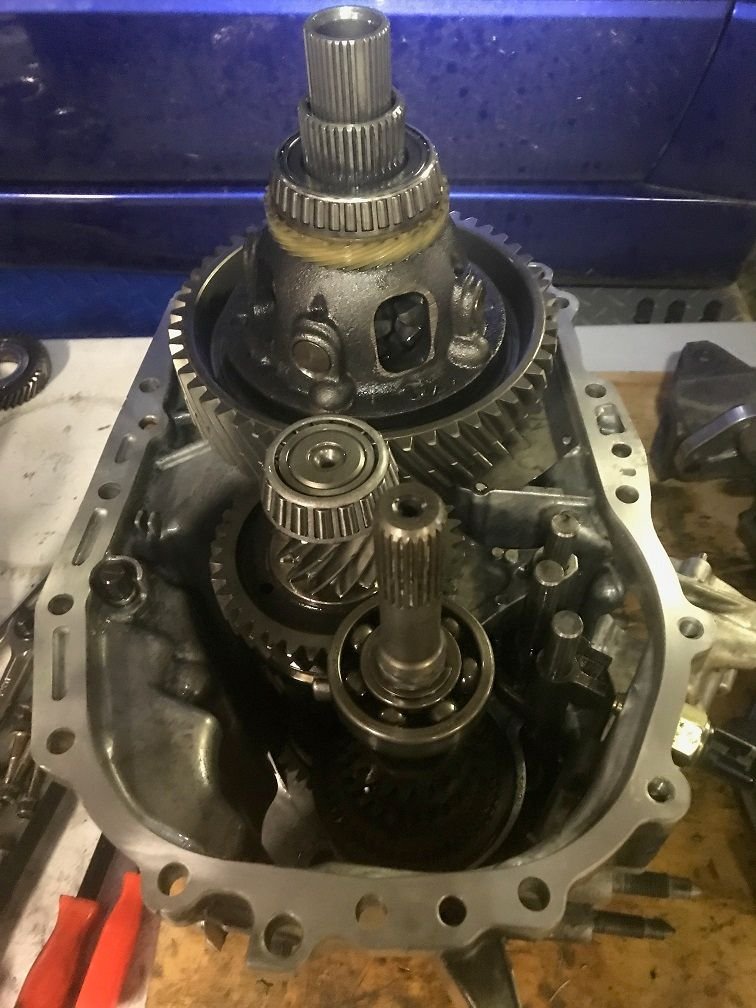

The new ACT Twin Disc shipped yesterday so I should have it sometime this week to put this thing back together. One thing I forgot to post initially is the best way to crack the case, which is to use 2 large pry bars opposing each other. There are a few areas on the trans that allow you to pry the case apart without having to touch the mating surfaces.
I cleaned the threads with brake cleaner and applied red locktite to the bolts that hold on the final drive gear, which are torqued to 98ft-lbs.
I got the gear set back in the case, which was easier than I thought. In fact, with a simple pulley puller and a press you can service the entire trans, which is not complicated once you start to play around with it. I did set the lash on the new output shaft, which Jacks told me there method of shimming the bearing and then putting together the case. If you can spin the shaft by hand and it goes 2 turns then the shaft is too loose. If it doesn't go a turn then it is too tight. Jacks said the MFactory usually required more clearance so I ended up going from a 0.045" shim to an 0.033" shim to get the desired effect, which took me 3 test fits. The input shaft shim just stayed the same since I did nothing to affect preload by just replacing 5th gear. I then assembled the trans to make sure all the gears worked, which they did. I will seal it up tomorrow using Ultra Grey and call it a day. I also ordered a new bearing for the output shaft, which you can see below since the one on the OEM shaft is just about impossible to remove and if you do, it will likely get damaged. Do yourself a favor and just order the $32 bearing for the MFactory output shaft.
It took about 1.5hrs to swap the gears from the OEM output shaft to the new 4.08 output shaft using just a low dollar & low tonnage press. The gears are not pressed on very tight so they press off easily and the best thing to do is just lay them on the table in a row as you remove each piece, which then allows you to put them back correctly. Even if you mix them up, just take a picture before you pull everything apart and you can figure it out pretty quickly. When you put on the sliders they can install 2 ways, which changes every 60deg of rotation. One way allows the sliders to engage the synchros and the other way doesn't. Verify they sliders engage the synchros for the gear before pressing on any additional gears. I have a video attached below to show what I mean.

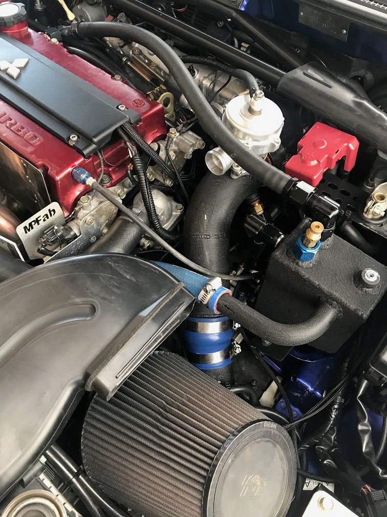

The next thing I did today was to relocate the vacuum source for my PCV setup from the PCV can to the front valve cover. I wanted to see if the vacuum was the same between the two references. Essentially, I don't see a noticeable difference whether I read the vacuum from the can or from the front valve cover. While I was doing this I decided the short the Hobbs switch to check out the vacuum with the air pump turned on. To my surprise it wasn't turning on. Upon inspecting the 15amp fuse it had blown so it was not working when under boost. This might explain why I had oil pushing past the rear main seal. I swapped in a 20amp fuse and it works like it should and pulls ~5" at idle. Because I monitor the pressure with my AeroForce Gauge it allows me to set a warning light. I now have the warning light come on anytime the PCV presssure exceeds 0psi.
Since the PCV is working and the clutch has ~225 miles I decided to do a few 1-3rd gear pulls on the new clutch with boost ~31psi. The car screams as usual and the clutch performs flawlessly. I didn't try to bang the gear as hard as I could, but it switched like butter at 8500 RPM with not problems. It was nice to have the car going again and I think I'm going to enjoy this clutch. I will likely just take it easy for another 100 miles or so before really seeing what it can do, but so far so good.
