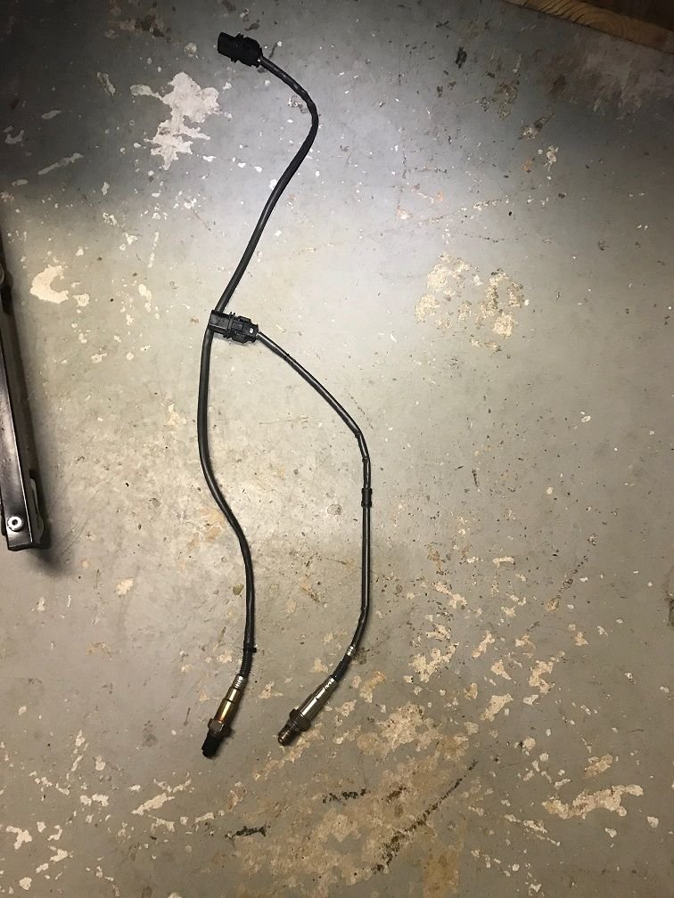

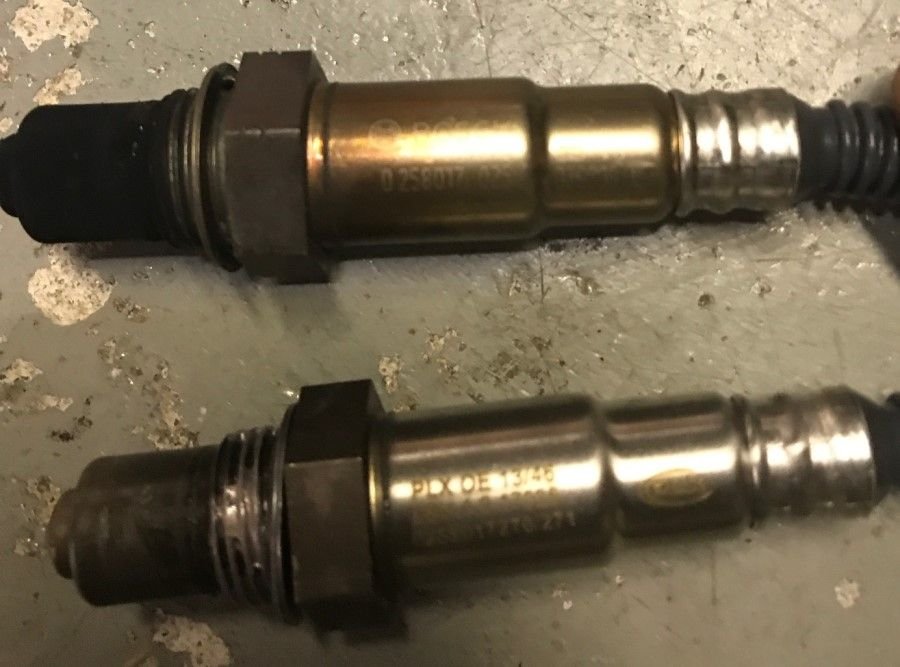

Car has been on the lift for 1 week because after ~6 weeks of use the Bosch LSU 4.9 wideband supposedly no longer works according to the code being spit out by the LC-2. After research I find the Innovate wideband controllers have a history of killing sensors every few months, which is definitely not a normal situation. Innovate has been sluggish to respond and claims I was supposed to use their 1" bung to keep the sensor out of the exhaust, but I told them this was contrary to what Bosch recommended for the LSU 4.9.
https://www.bosch-motorsport.com/con...or_LSU_4.9.pdf
It has been more than a week and they still won't tell me how they will address this issue so I guess I'm supposed to just buy an new $80 sensor every 2 months like many others have reported. I ran the PLX M300 for 10 years and the Bosch LSU 4.2 lasted 8 years before I replaced it for no other reason than as a refresh. I will likely now just purchase the PLX wideband controller because I want to see if this sensor is indeed dead or if it is something with the LC-2 and the stupid calibration it does on startup.
After scouring the internet and talking with a few companies, I decided to go with a little known company called 14point7. I saw several reviews on various forums about this unit and they all seemed to be positive. It was either this unit or the PLX, but as was mentioned the PLX gauge is quirky and the reviews were overall negative in terms of the gauge portion of the PLX.
https://www.14point7.com/products/sp...a-controller-2
I spoke with the owner of the company and explained my situation with the LC-2 and he said my sensor was likely still in perfect working order, which is also what I suspect. Too many people post about the LC-2 flashing a code for a dead sensor and having to change them every few months, which is just not a realistic scenario for a Bosch LSU4.9 sensor. Anyway, this is no frills unit and has both the 0-1V narrow band output for the front O2 sensor, which I use along with the 0-5V output for datalogging purposes. Because I have the AeroForce Tech gauges I can just tie in the 0-5V output to the gauge as well and hopefully I will not have the same issue that I had with the LC-2 with it changing the 0-1V signal function.

I'm not sure, but I suspect it has something to do with the auto calibration every time you turn on the unit because the LC-2 is looking for some type of response from the sensor it isn't seeing. The Bosch sensors use a calibration resistor from the factory that is determined by subjecting the sensor in a lab against two different gases and then the correct resistance resistor is chosen to get the senor calibrated. Therefore, when you do the free air calibration with the LC-2 it probably offsets the factory calibration of the sensor as performed by Bosch in a lab, which means it is no longer accurate.
The reason I run the 0-1V analogue from the wideband controller for the front O2 is because once I started making a lot of power I kept killing the front O2 sensor within 1 year and got tired of replacing it. Perhaps I should say Advanced Auto got tired of replacing it. I still have the factory front O2 plugged in and installed in the downpipe (completely dead sensor) otherwise it throws a code, but I just have the wideband 0-1V anologue output going to the front O2 sensor input of the ECU.

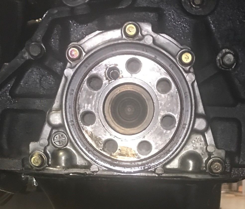

Maybe I have the RONA because it is definitely oil that's leaking. After removing the trans I can see the lower third of the real main seal is covered in oil so I am assuming the leak is from the rear main seal. Hard to imaging this leaking considering it was replaced with less than 20K miles on the engine. Pic is not that great so I'll try to take another, but oil is pooled in the crevice below the seal as well as coating the back of the engine and dispersed by the flywheel in the inside of the bell housing.
I'll have to search to see how common this is, but also need to decide if I just replace the seal or the housing as well. Replacing the housing means that I have to again drop the pan, which is my favorite thing to do and means I get the purchase another $60 in oil. If anyone has seen or experienced this let me know, but I guess I'll start by just pulling the seal and see if I notice anything on the housing. I don't believe it could sling inside of the housing if it was just a pan leak and considering I resealed the pan and it is still leaking, it must be the rear main seal.

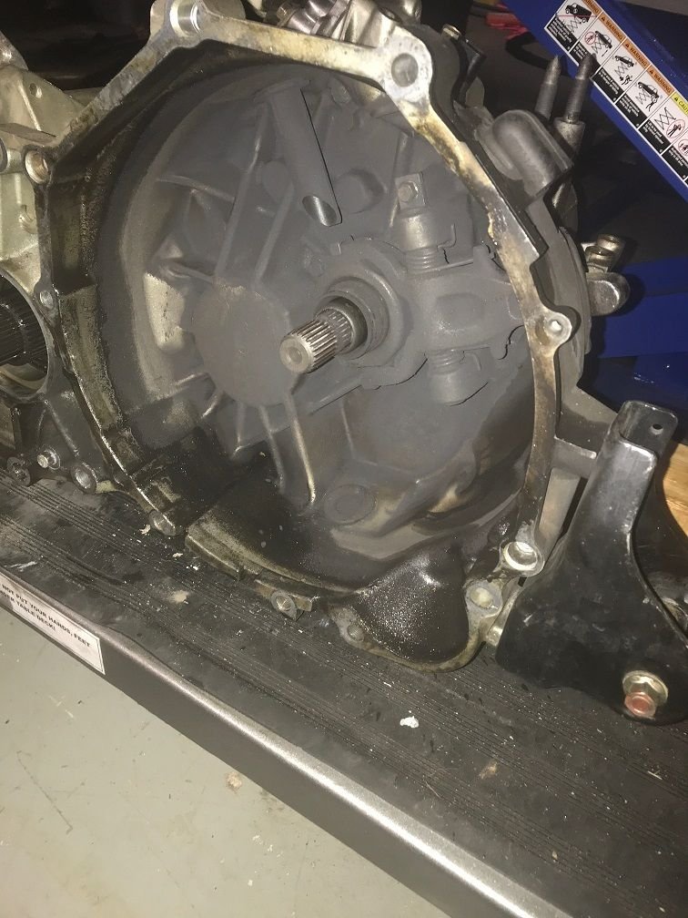

The inside of the tranny is also coated so and no signs of a tranny leak.

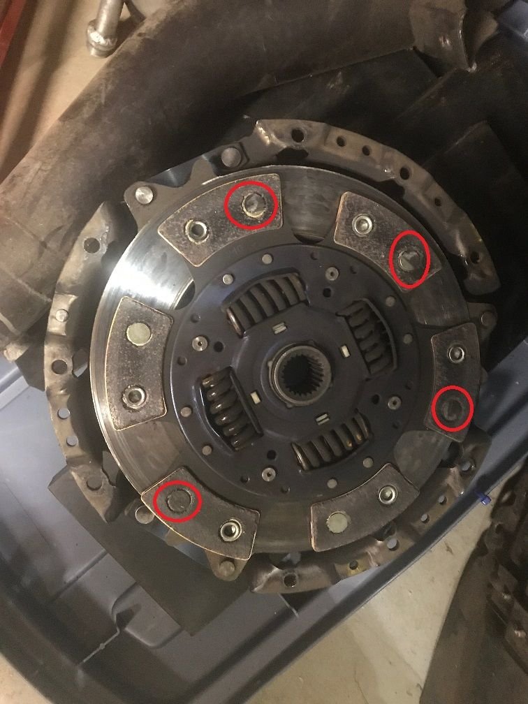

And to add insult to injury, the ACT disk is worn to the rivets so it also needs to be replaced. The clutch works very well and has never had issues, but it does not like to be slipped and clearly doesn't last a long time at this power level as a daily driver.
I also found the act 6 puck to be a good clutch until 450+WTQ , tall gearing and some launches quickly wore it out.
The ACT twin looks like a great clutch.
