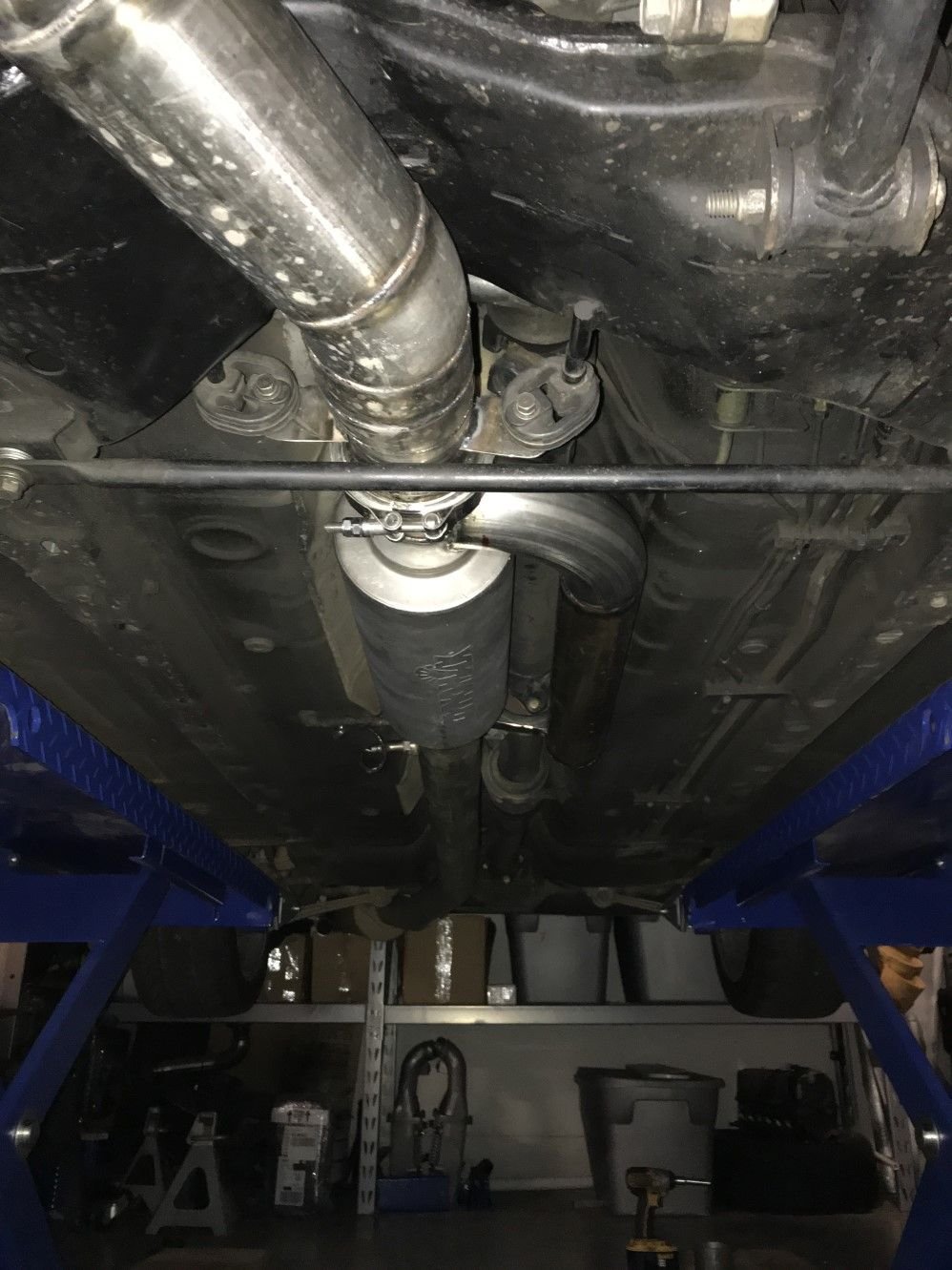

Very nice work, and clean welds. Loving the transition to clear the under braces. Could we get a video of it idling once it's back up and running?
welds would be better if I had 1/32 rod vs 1/16. Yea, have to snake it back up or the muffler sits too low.
iphone won’t capture idle sound properly, but with Varex muffler closed it is quite. Adding the muffler made it substantially more quiet on the highway with Varex closed. However, significant resonance at ~3500 rpm so need to wrap and add helmholtz resonator.

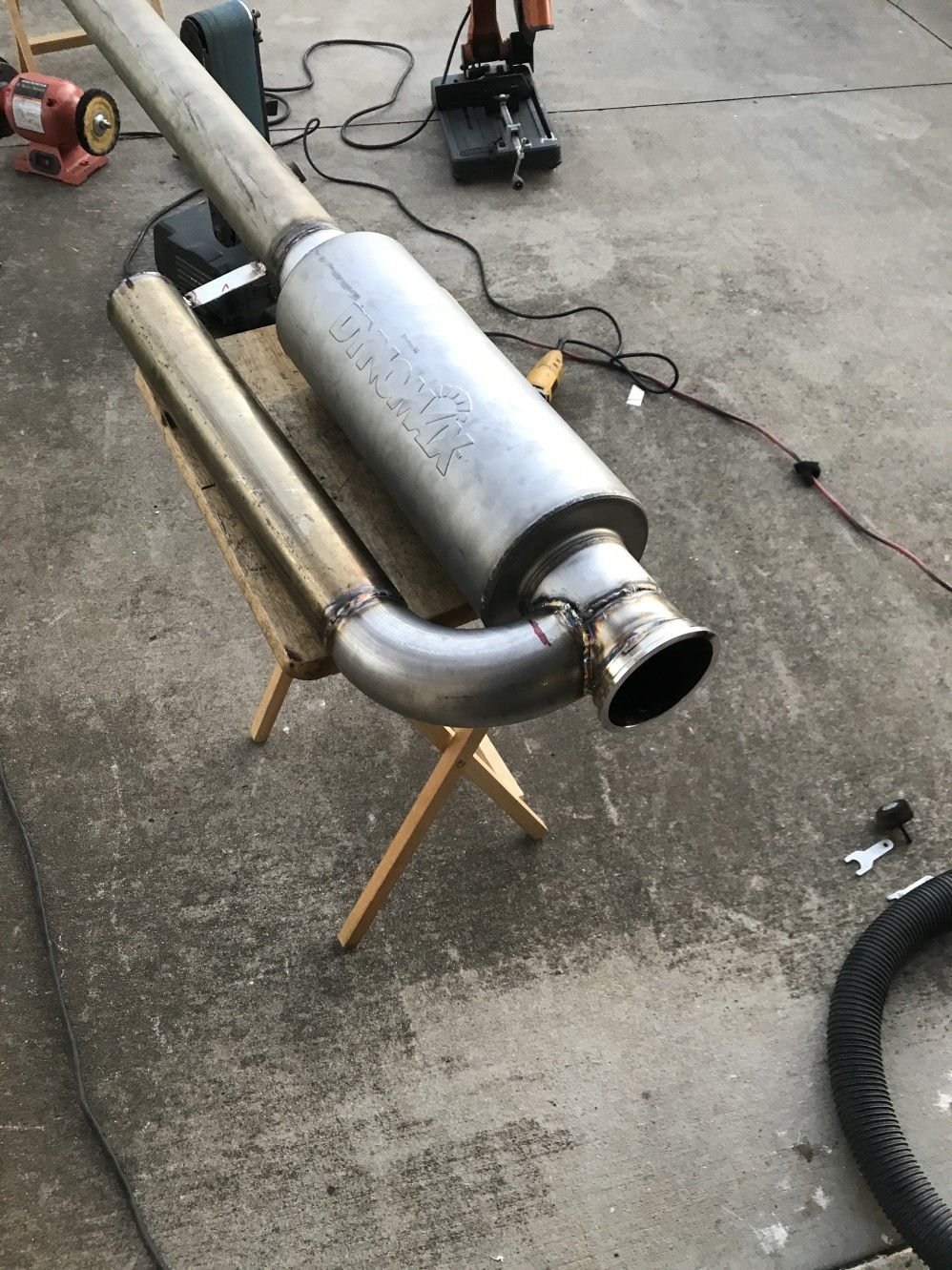

Had a little fun this weekend. Definitely makes a difference, but not as much at the tuned RPM I was seeking. 27" for ~3700rpm is what I came up with.

From factory, The exhaust has a resonator in the mid pipe before it goes by the rear diff. I've found that is the best place for resonator in the car. The test pipe/cat resonator doesn't work very well.
The Dynomax resonator was added last month and made a big difference vs the CAT so I am pleased with that mod and the subsequent results. I added the HelmHoltz Resonator (HHR) this weekend before the Dynomax resonator so that was the purpose of the post. It made a noticeable difference overall, but not as much as I wanted at ~3700rpm targeted based on the 27" length. From what I read the HHR should be as close to the engine as possible.
Regarding your comments, I may also add a resonator at the point you described, but a "bullet resonator" around the diff area since it can't be too large of a diameter due to space constraints. It is actually pretty dang quite below ~3200rpm cruising with the Varex Muffler closed so that is a good thing since I can now have a phone conversation. I think I need to go with a 4.11 gear as well so I don't hit that magical ~3500rpm when cruising.

I meant the resonator/muffler. If you look at all the quiet exhausts for these cars that is also where they put the mini muffler/resonator.
I agree on the HHR needing to be close to the motor.
