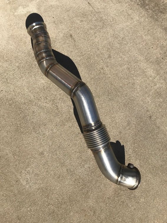

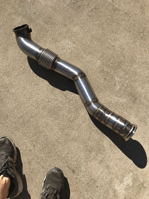

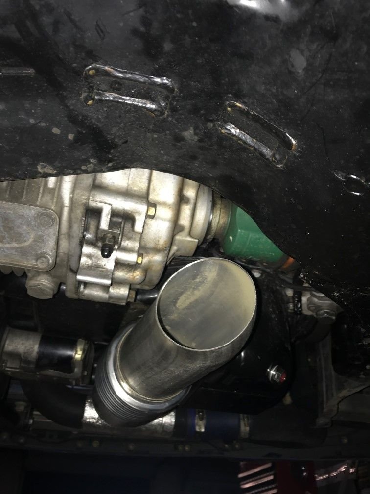

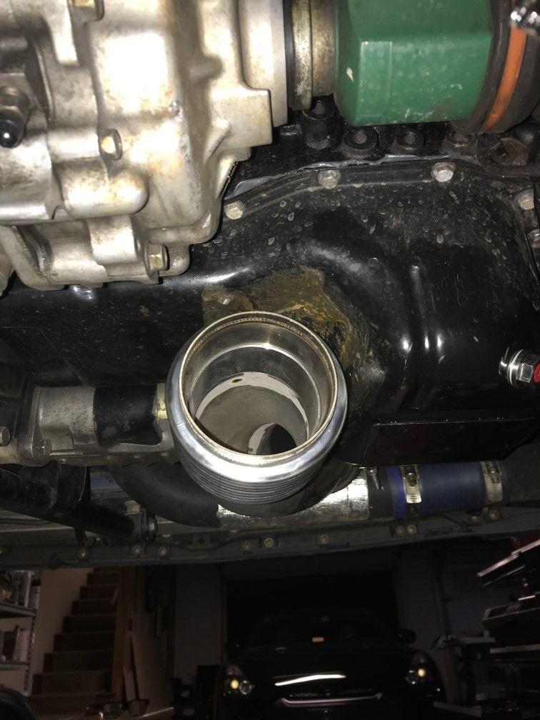

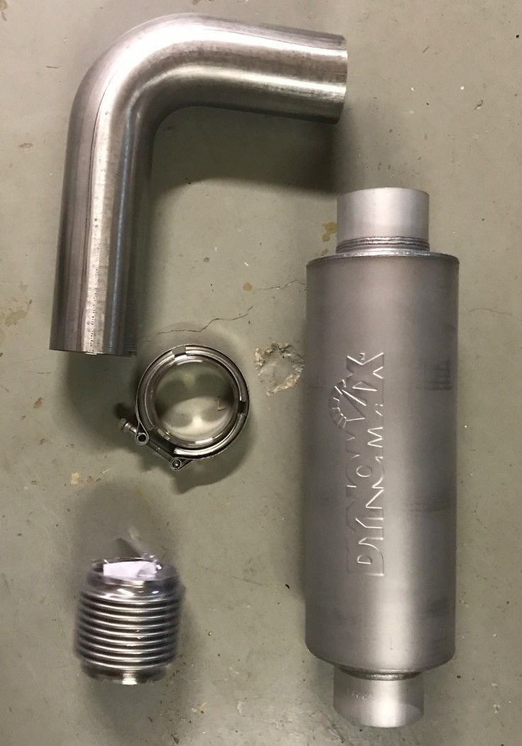

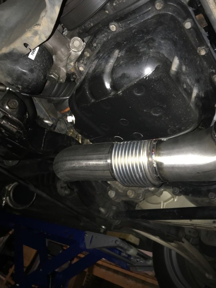

I ran into an issue as both my header and midpipe cracked in a few spots so I have narrowed it down to the fact I don't have a flex section in the exhaust until after the midpipe. On the short runner setup I had a flex section right after the 90deg from the turbo pretty much in the same spot as the stock pivot point. I've ordered and received a 3.5" bellow, new 3.5" vband clamp, 3.5" stainless 90deg bend, and a 3.5" 16" long Dynomax resonator. I'm gonna ditch the cat and put in place the resonator. This is more so because I might upgrade the turbo to an S366SXE (6673) 0.81 a/r vs the current S362SXE (6268) 1.00 a/r. I'm going to put the car on the lift today so hopefully I can have it done on Saturday after 3-5hrs of work.

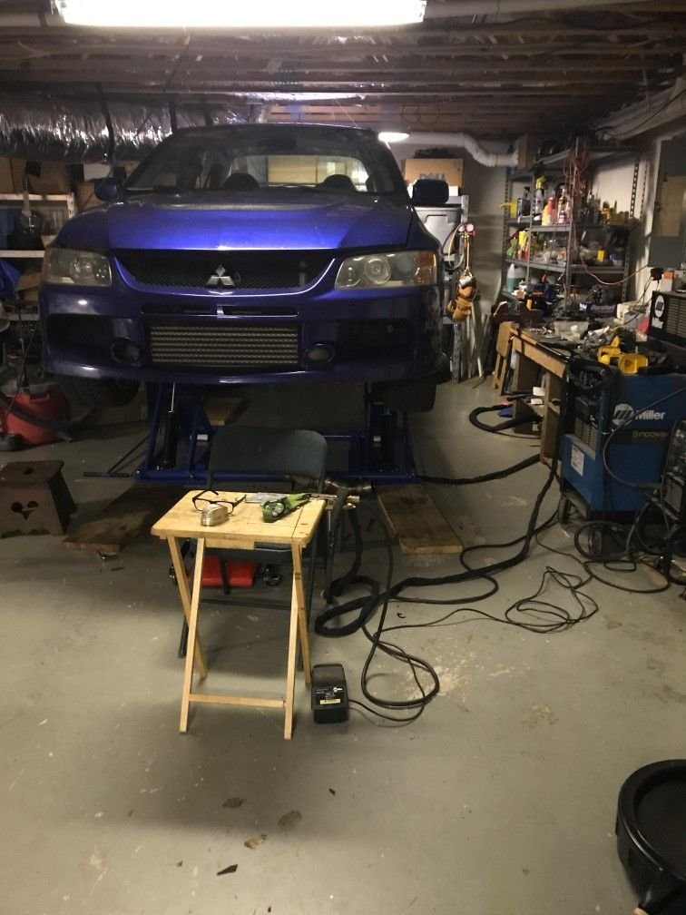

OK, so maybe 3-5 hours is about 3x under estimated!

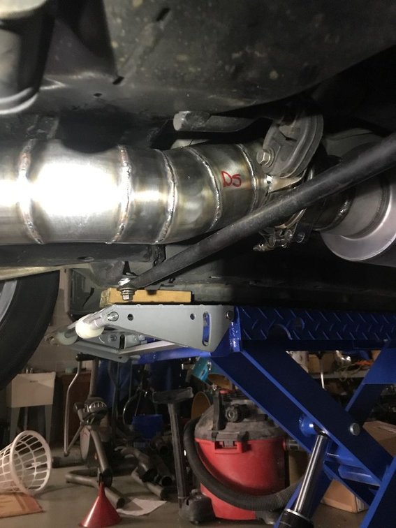

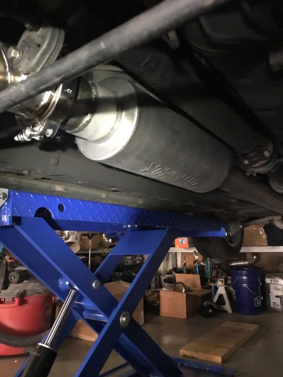

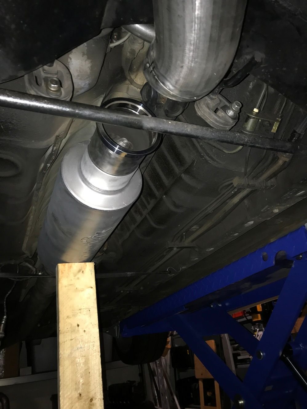

I should have it wrapped up tomorrow. I installed the muffler last so I now have to modify the midpipe to line up since it is slightly off, but not big deal.

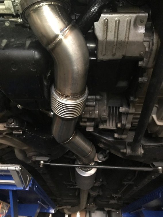

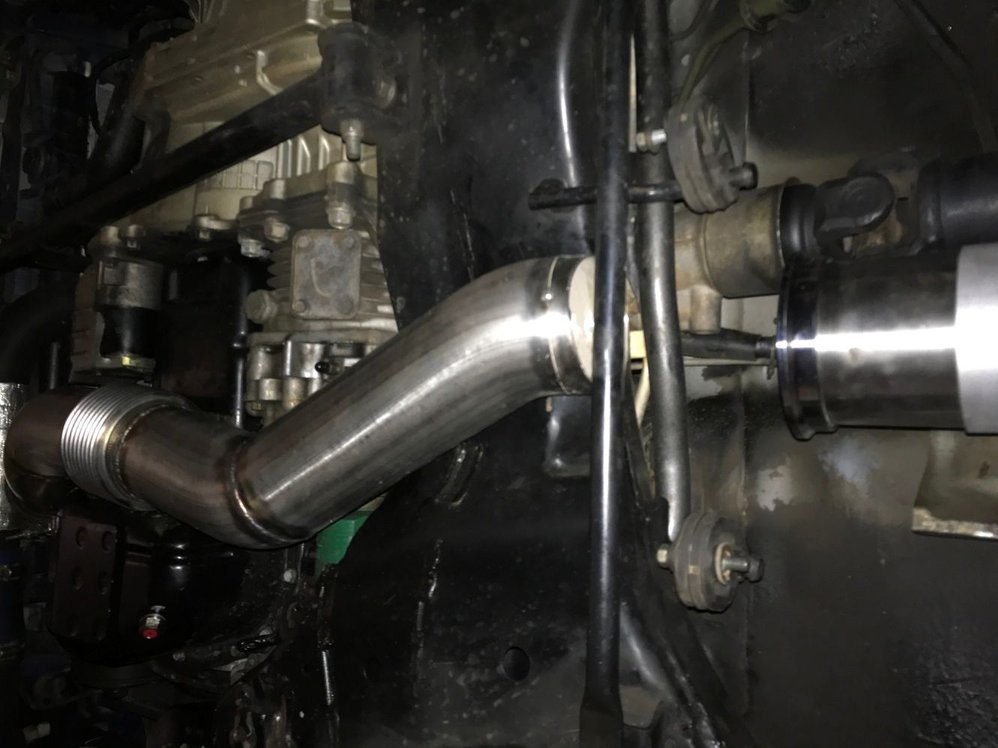

Finished!

looking good man, curious to see how much more power it’s going to put down with no cat.

Originally Posted by 240Z TwinTurbo
Finished!
Very nice work, and clean welds. Loving the transition to clear the under braces. Could we get a video of it idling once it's back up and running?
