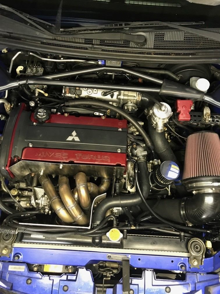

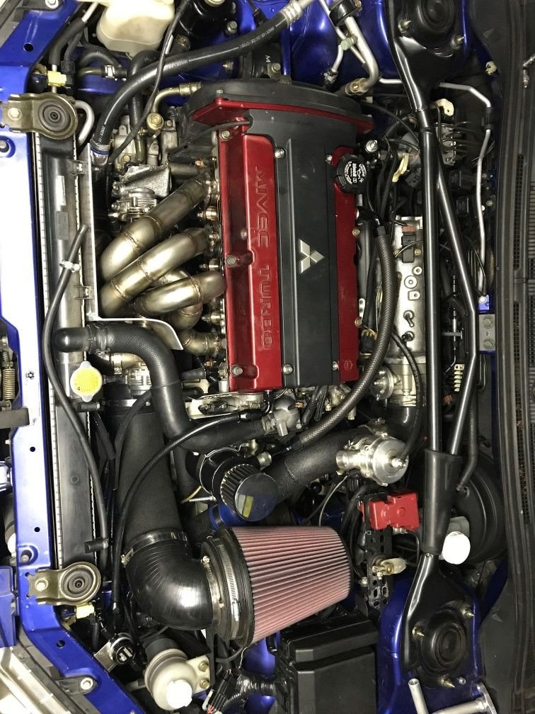

I should have this thing running in a few hours!
Notice anything different?
Old May 17, 2019 | 08:38 AM
  #80
Strm Trpr's Avatar
Joined: Jan 2007
Posts: 201
Likes: 9
From: NorCal
Potential for water cooling and no signal pressure hoses to the wastegates?

Originally Posted by 240Z TwinTurbo
The downpipe put up a good fight, but he finally surrendered with this hands in the air.
Haha was looking back at the pictures to spot the difference and just saw this. Thats funny!
On second thought you must have overnighted that kitty or something bc you're too smart to not think of that lol! Also shipping cost seems high...
Ok and here's my guess...is it the location of the o2 sensor? It looks lke you moved it upstream.
Now get that thing buttoned up and fire her up!

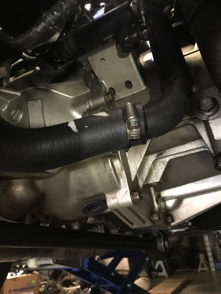

So the car is now running and I took it for a few miles of driving after letting it warm up and checking for leaks. Didn't get on it, but did stomp in 3rd from ~2500rpm to see how the boost responds. It has some additional lag, but it at ~4K rpm it looks like the boost goes from 5psi to 25psi pretty quick so I think this thing is gonna hit like a freight train at 4400rpm. I also now have extra MIVEC advance capabilities so I think I can help spool by ramping in more cam timing on spool.
Unfortunately, I noticed a small drippy drippy from the aluminum lower radiator tube on the very last weld. Must be a pinhole leak and it is definitely not coming from a higher location. I probably should have pressure tested the damn thing, but going to let it cool and then drain the coolant, pull the pipe, and pressure check.

Video Attached of the Leaky Leaky! Quick fix and the car is running again. Gonna take it through a few heat cycles to burp the system, but think this thing has promise!

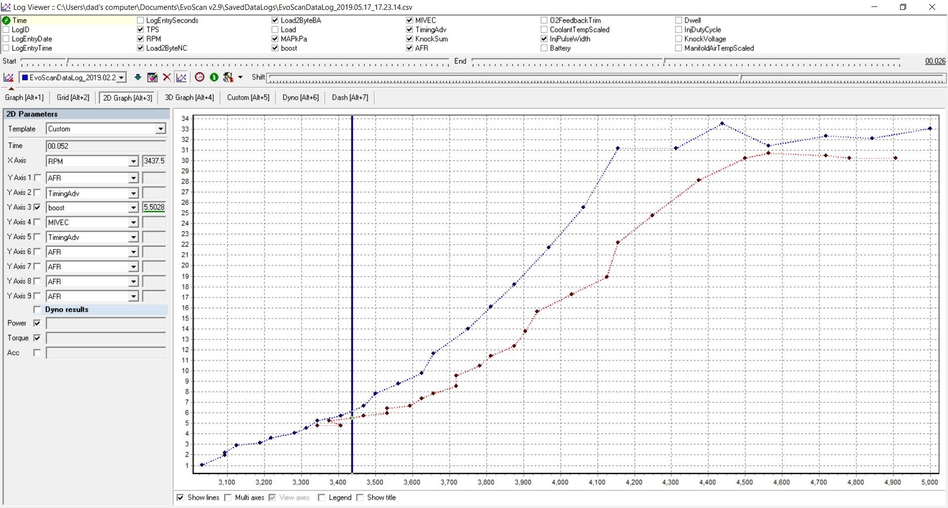

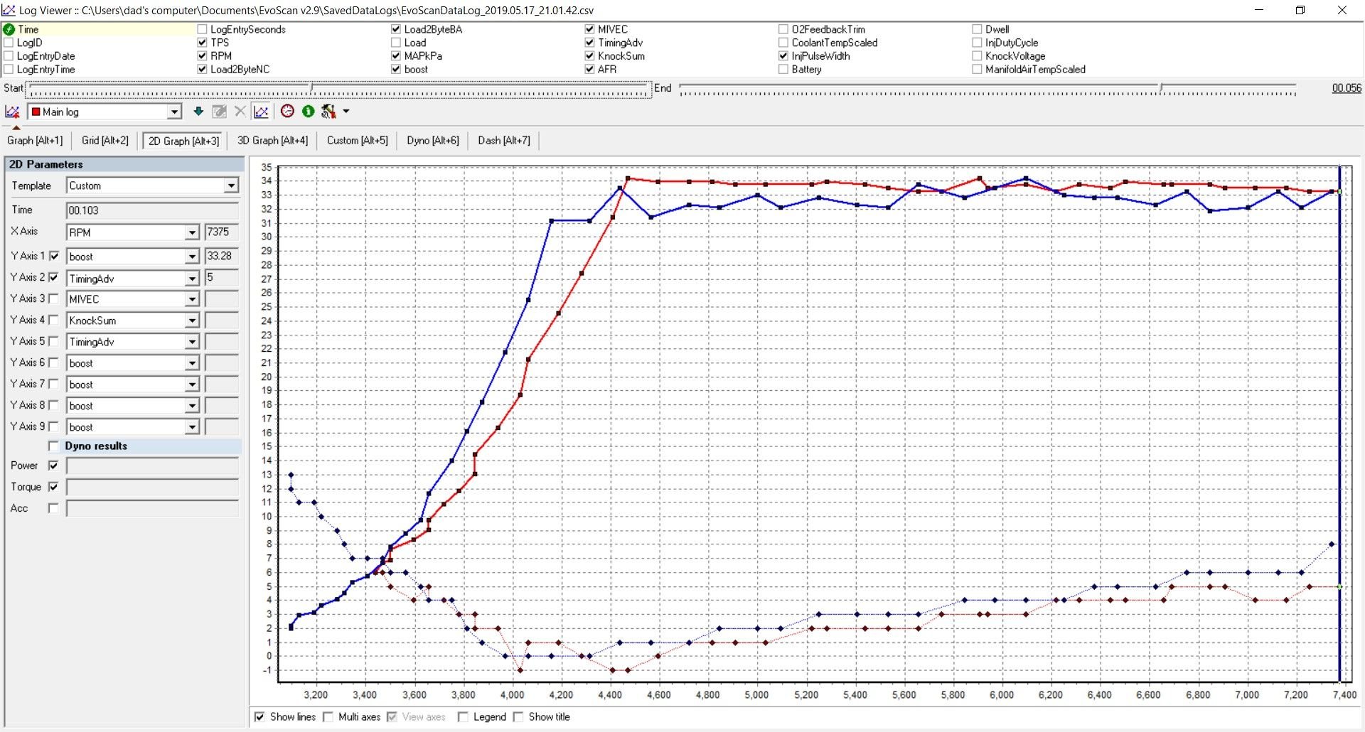

So this is the current state of comparison of the new setup vs the old setup, which is only slightly more laggy. After ramping in more timing during spool and playing with the MIVEC it made it come on boost faster. I feel a bit better now knowing that I am running a bit lower on timing so I will play around with that tomorrow to raise it by 1-2deg.

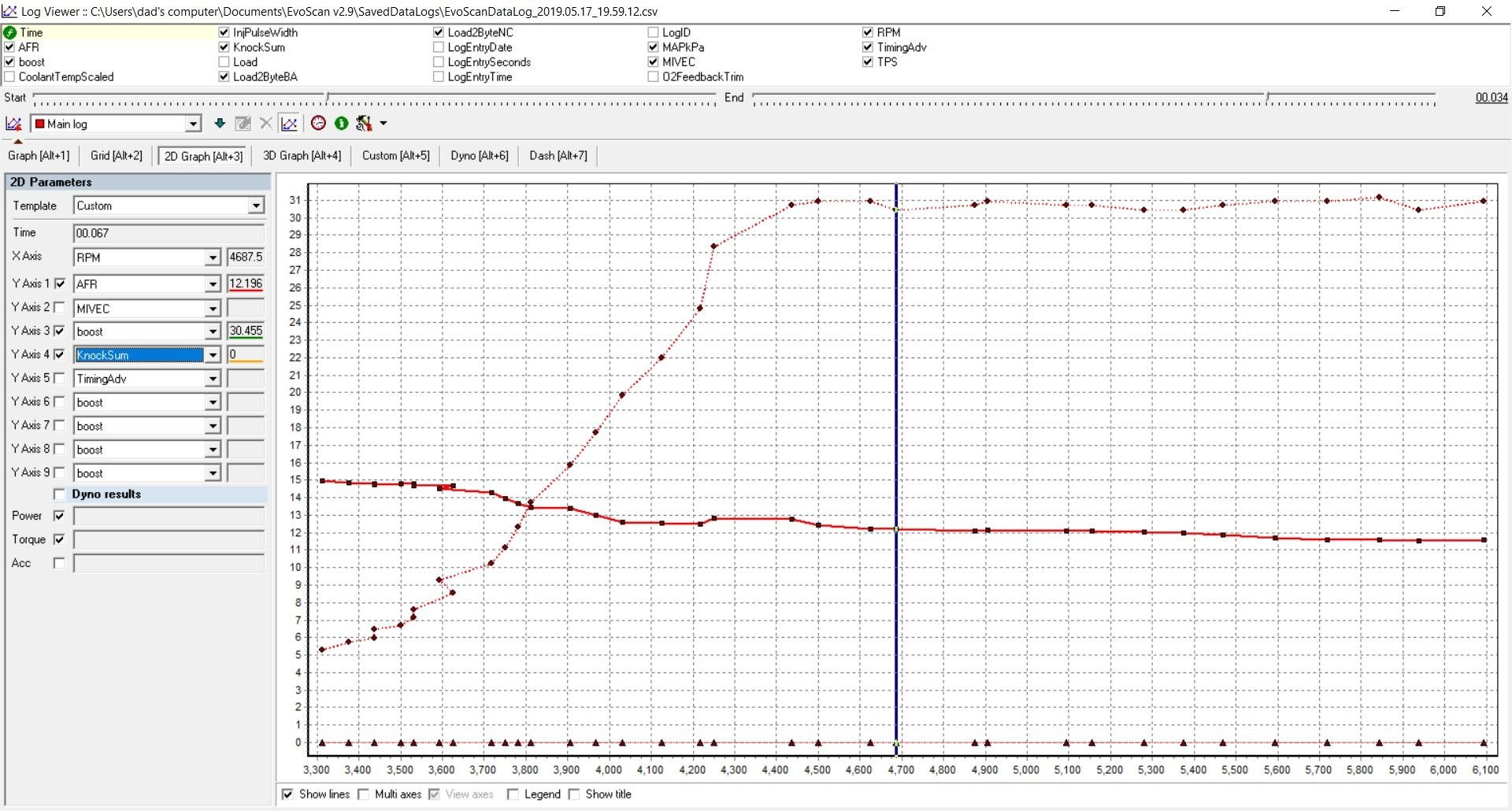

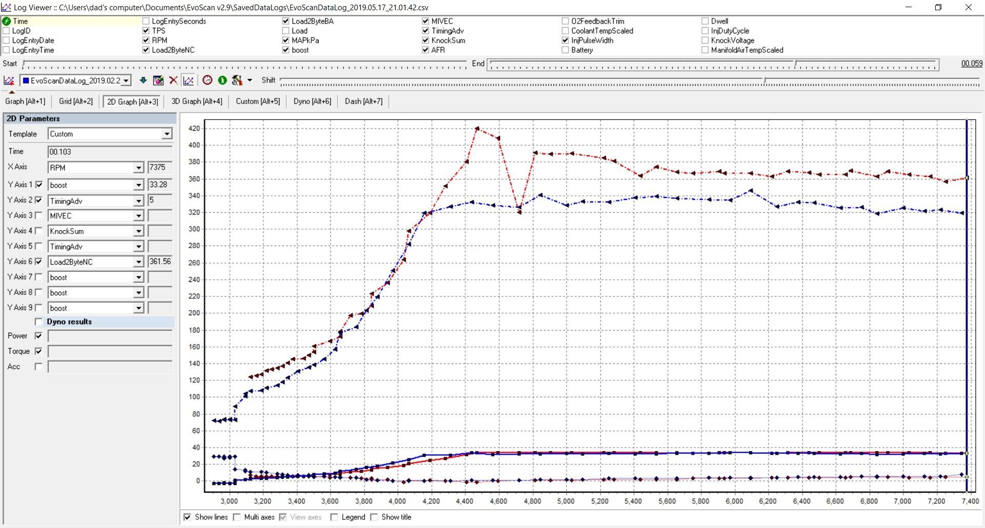

So I overlayed the log of the load comparing the GTX3582r vs S362 and it is definitely making more power. These are the same two logs as in the previous post. This explains why my ignition timing is down because I am at a different load value so I will correct this and run it in the morning so hopefully this will wake up the turbo.
