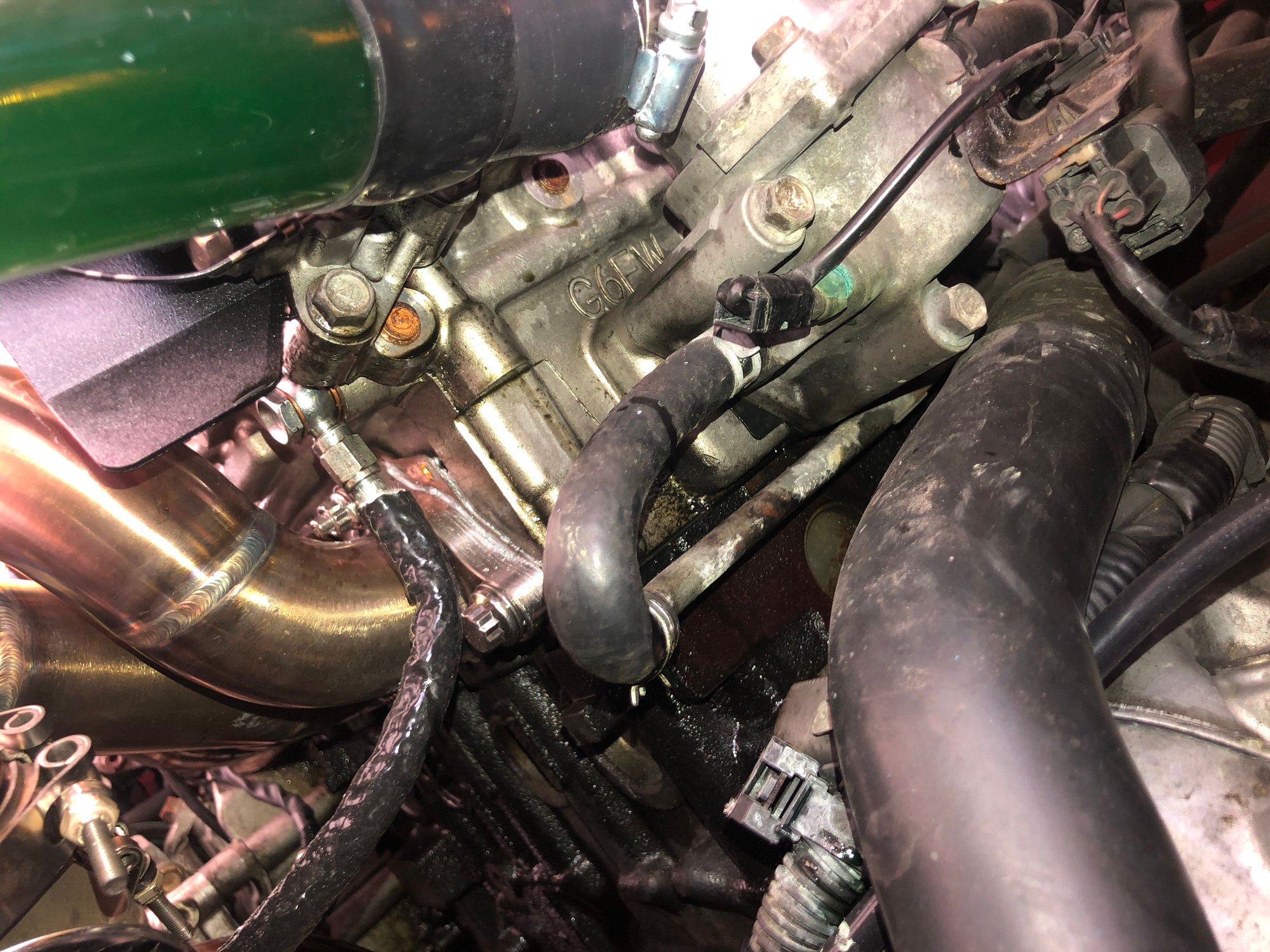

Uh oh.. oil all over my block
Old Feb 21, 2020 | 12:18 PM
evolved310's Avatar
Joined: Oct 2016
Posts: 10
From: goldsboro
Finally have my new set up on and got my car tuned, started smelling burning oil and noticed oil is all over my block, I’m stumped.. the L19 headstuds haven’t been retorqued since 2016 so, I’m going to check that out first, any advice would be greatly appreciated!
Old Feb 21, 2020 | 12:37 PM
Dallas J's Avatar
Veteran: Army
Posts: 5,969
Likes: 811
From: Portland, Or
Looks like its coming from above. So valve cover gasket (check PCV valve) or CAS housing.
