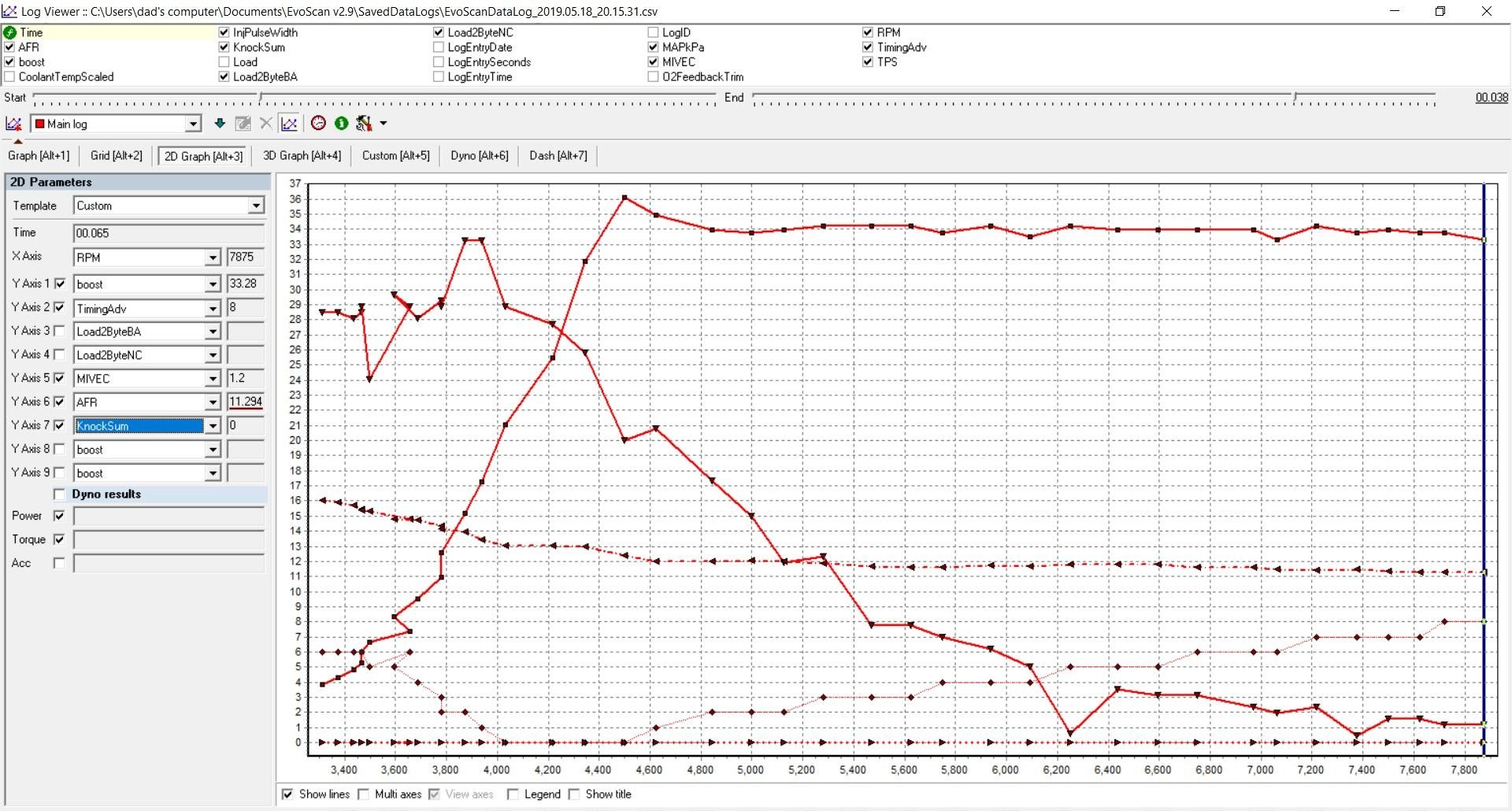

I logged this a few years back and there was some explanation for it. Search mivec map vs actual by me in ecuflash if you're curious.

Problem is that I didn't raise the "MIVEC Intake Advance Max" so it was at the default value of 28.#. I swore I had raised this value, but perhaps I went back a tune revision for some reason and forgot to change it back. I played around today and raised it, but didn't want to push past 32deg. I'm going to play around with running negative overlap on the topend to see what it does to AFR. Perhaps it will breath better if I go to -2 to -4 degrees.
the one drawback to vipec. No negative values in mivec table for me

it did nothing on my gtr with stock head & cams on the Dyno, but maybe it will on this setup. If the AFR leans out then it is making more power and I will try a back to back tomorrow going negative above ~6500 rpm.

Didn't see any AFR change going from 0deg to -3deg on the topend so I just left it at -2deg.
