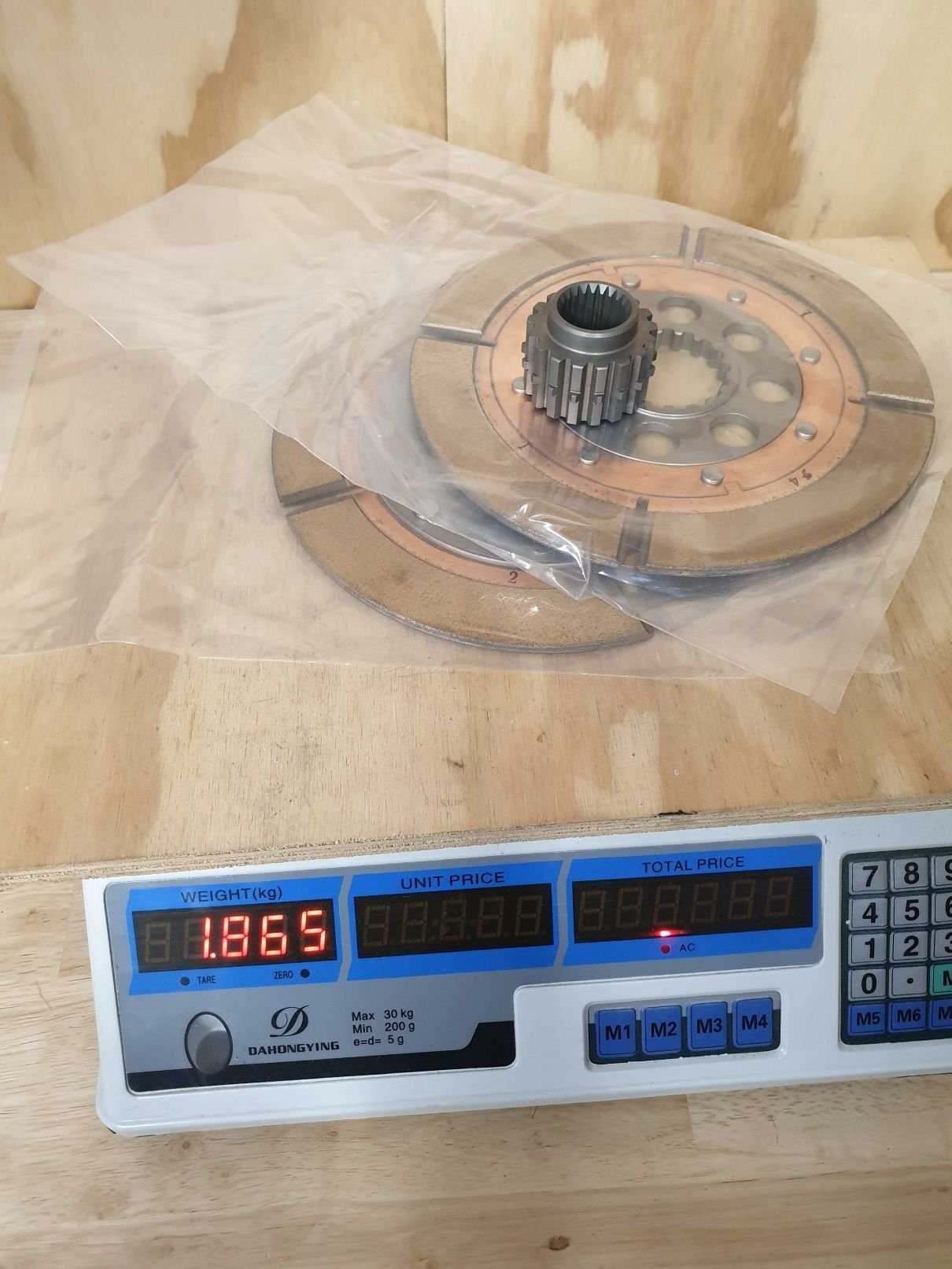

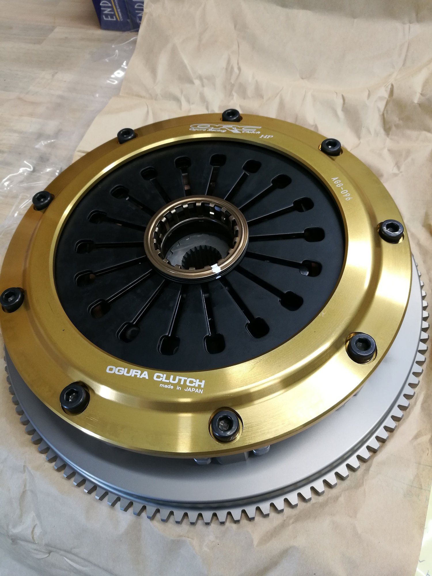

Originally Posted by RSMike
ORC 659 Twin plate is a very good option too.
These things shift absolutely amazingly. Driveability is super easy, my wife can drive my car with no problems.
http://www.ogura-racing.com/metal_clutch.html
I can supply these directly from ORC (Ogura Racing Clutch) if anyone wants them.
Around $1850USD including shipping.
Main advantages:
Amazing shift performance. Full wheelspin 1st to 2nd gear shifts are no problem at all.
Central Single Spline design. This stops lots of issues of stripping the splines. Super strong and allows another degree of freedom/release.
Full OEM style installation. No conversions. Use OEM flywheel bolts and release bearing.
Super easy to drive. Engagement is very smooth.
Reasonable cost - cheaper than Exedy Twin.
On paper they hold 750nm at the engine. We have run these in cars up to 670whp (500kwatw) with no problems (Just be mindful of mindrange torque).
Components are individually balanced from ORC.
ORC 659 Complete assembly
ORC 659 Flywheel
ORC 659 top floater plate (NOTE it's balanced from the factory)
ORC 659 centre floater plate with central hub and sprung discs
ORC 659 Sprung discs
ORC 659 sprung disc weight. 2.45kg for both discs and central spline hub.
ORC 659 solid disc weight. 1.87kg for both discs and central spline hub.
ORC 659 installed pic. NOTE PULL type is retained. 100% factory installation.
I can support what he said above. I have the 659D for about two years but without many miles to provide a better feedback on those. The clutch is very street friendly, it has the chutter that all multiple discs have, but the engagement is very smooth. I was searching for a twin disc with dampers and I chose this. It was also cheap (around 1.300bucks). This is my first twin disc so I do not know where this clutch stands in terms of competition(OS Giken, Quartermaster, Exedy etc). Although it is rated at 650ps and 735lbs of torque, i made 750whp on my 2.4 and is holding fine
