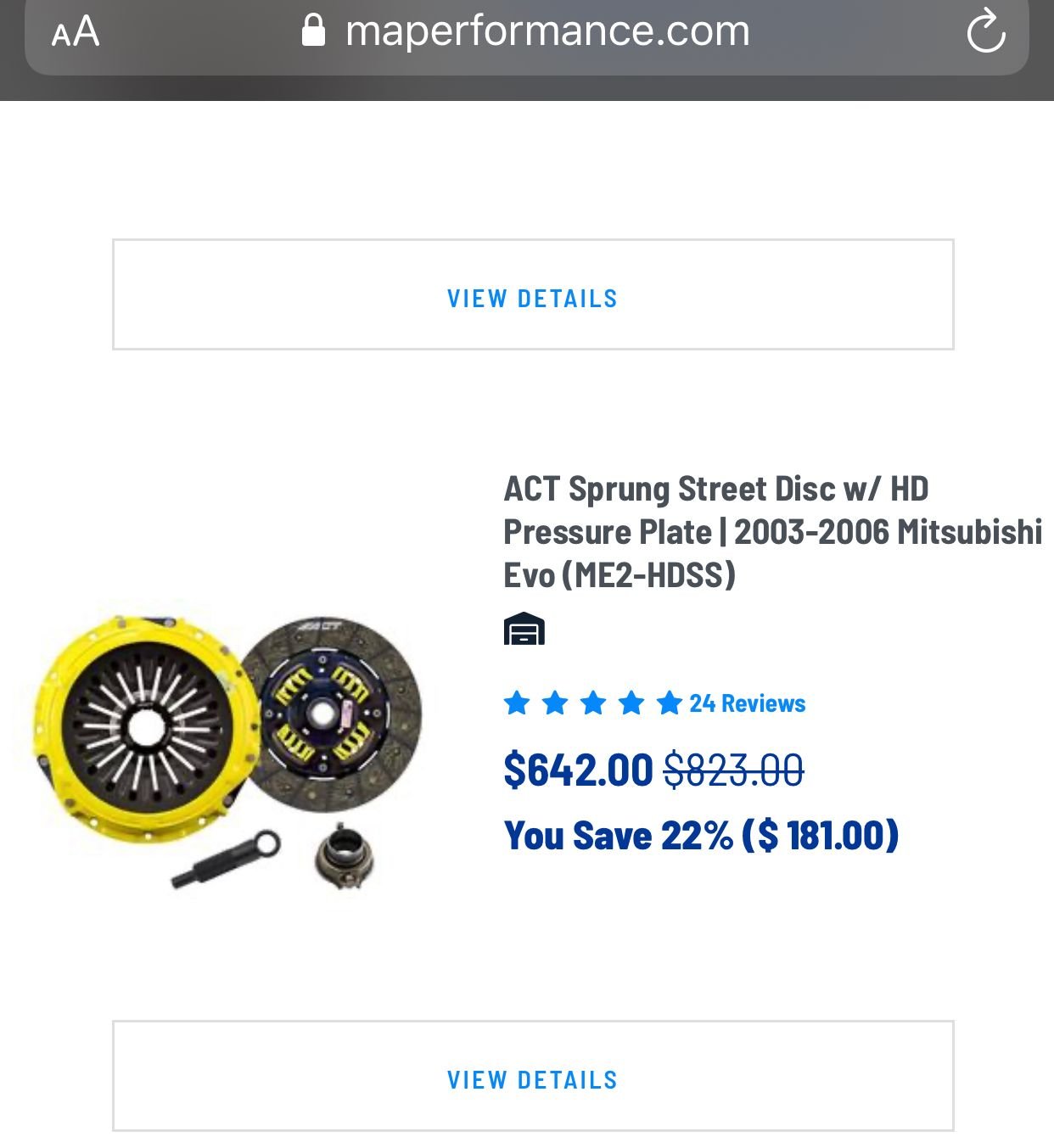

Whats a reliable clutch you’d recommend ? with stock block/bolt ons and an Fp black on e85. Was thinking an ACT street disc kit with the pressure the plate as shown in the pic provided. I believe I had that one on my first Evo 9 with stock turbo/bolt ons and held up great. I know theres different versions to the ACT brand you can pick from. But giving the amount of torque I’ll be making with the black which should be under 450wtq it seems it’ll hold up just fine from what I’ve read...currently running stock clutch now and have never launched the car or had any slippage but just don’t wanna take the chance the stock clutch goes out while on the dyno getting tuned and I end up looking dumb cause I could of just switched it out ahead of time. Thanks

The HDSS will be plenty. Your tuner shouldn't let the car make more than 400wtq with that stock engine.
Yeah he’s telling me now that’s what the goal is and he’s not taking it any further than 400. He said stock clutch should hold all day just fine to just switch it out if it out afterwards if it goes out, for now to just leave it since it’s holding up.
