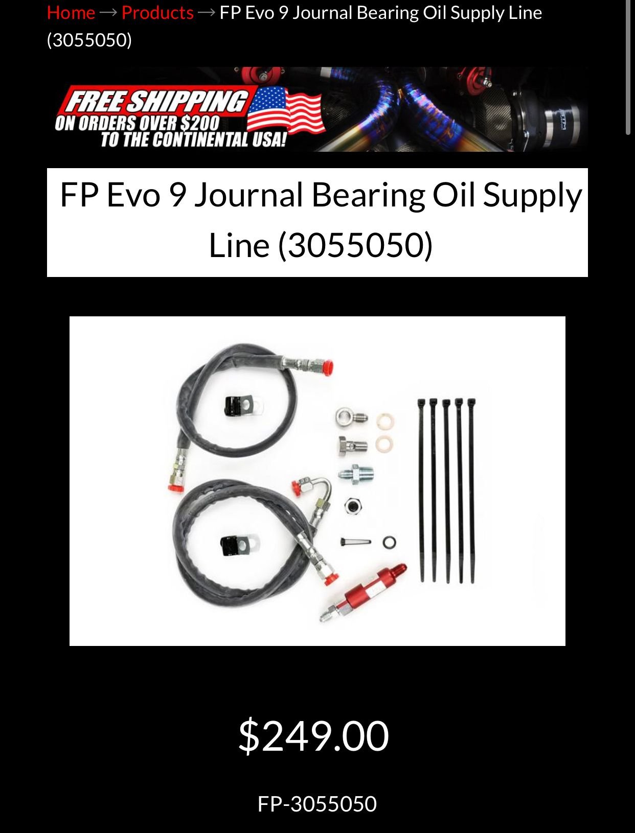

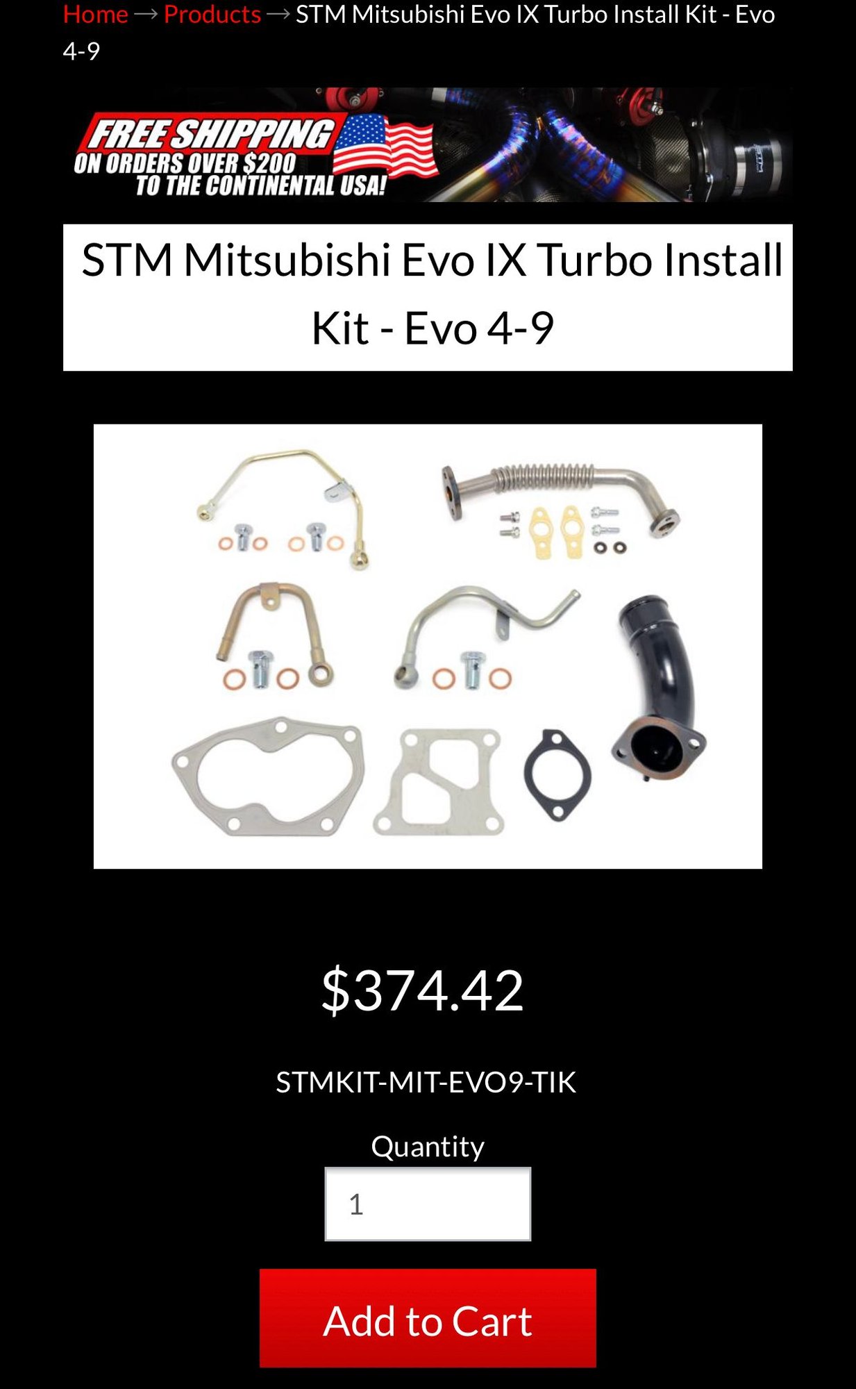

Yeah to break 500hp I plan on being e85. So idk if I can use the stock 8 waste gate? If not, then which FP size 18 or 25? And the Fp oil line is different than the one I ordered from STM’s install kit that I received? Picture provided shows what I received already with the kit.

Apparently on STM’s site it shows I’ll need this also along with the Fp install kit...

You need the OEM parts kit, and then you also need that oil feed line, yes. The oil feed line in the STM kit is the stock line that feeds off the head, and won't feed the FP JB turbo enough oil. So you need the FP oil feed line.
I would go with an FP JB red for better spool up, and the 18psi actuator will make plenty of boost to make 480-500whp on the stock motor. It will also ensure you don't make too much boost for pump gas. And yes, you need an Evo 9 actuator; the 8 actuator won't work.
Ok so the install kit is needed, that “FP oil supply line” for $249 in the pic I provided, and the Evo 9 18psi actuator. And Fp red is the better option, got it. If I have the HTA71 coming in is it possible to have that shipped back and converted to an FP Red ? I see when you send in your stock 8/9 turbo to FP they can do conversions for black and red apparently.
