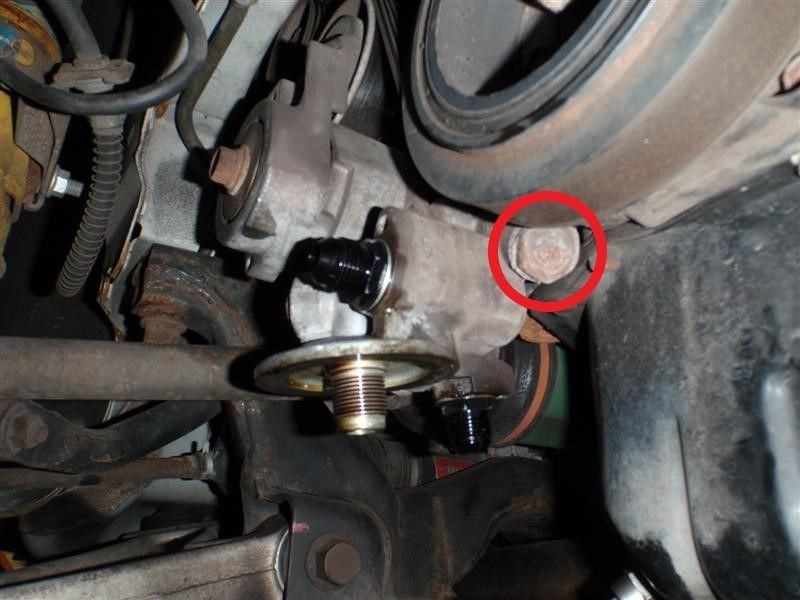

Originally Posted by colo_evo
How long would it take to install the adjustable regulator?
Under $100 and takes about 20 minutes to install. You just remove the factory cap from the bypass spring and screw on the new adjustable cap, which is located on the oil filter housing. You then would need to drive the car to see what pressure you have and then adjust accordingly. Adjustment is just loosening the lock bolt and then adjusting the screw with an allen head, which is done without exposure to oil as it would be an oring seal on the adjustment screw. It is easily accessible from the bottom of the engine without removing anything and below is a pic of the cap circled in red.
Old Sep 4, 2020 | 02:19 PM
Abacus's Avatar
Joined: Jun 2012
Posts: 1,399
Likes: 418
From: FL
Hats off to you Sir for taking the time to work on the bolt on adjustable regulator @ 240Z TT . Great Concept! I ported my bypass to lower oil pressure slightly years back.
I think both ideas are cool for a sub 8000/8500 rpm 4g63 engine to lower some oil pressure.
Beyond that RPM or for the road course , I think slowing the oil pump down with the ER gear makes sense. Extend pump life, slow down pumping oil to the top of the engine or letting it bypass and add heat.
