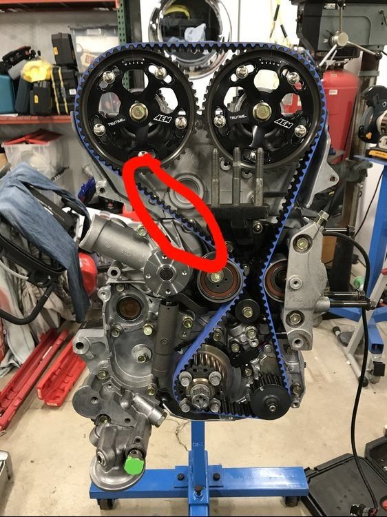

I wonder if your tensioner is defective. But cams will determine how loose your belt ends up based on where it rests. How much play do you have here:

This. That is not normal, Something is not right. Correct tension would not allow cams to move and create slack.
When you installed the belt you wrapped it around clockwise starting at the exhaust cam and leaving all slack at the tensioner location right?
That tensioner pulley may have slipped from its original location after you put it all together and turned it over.

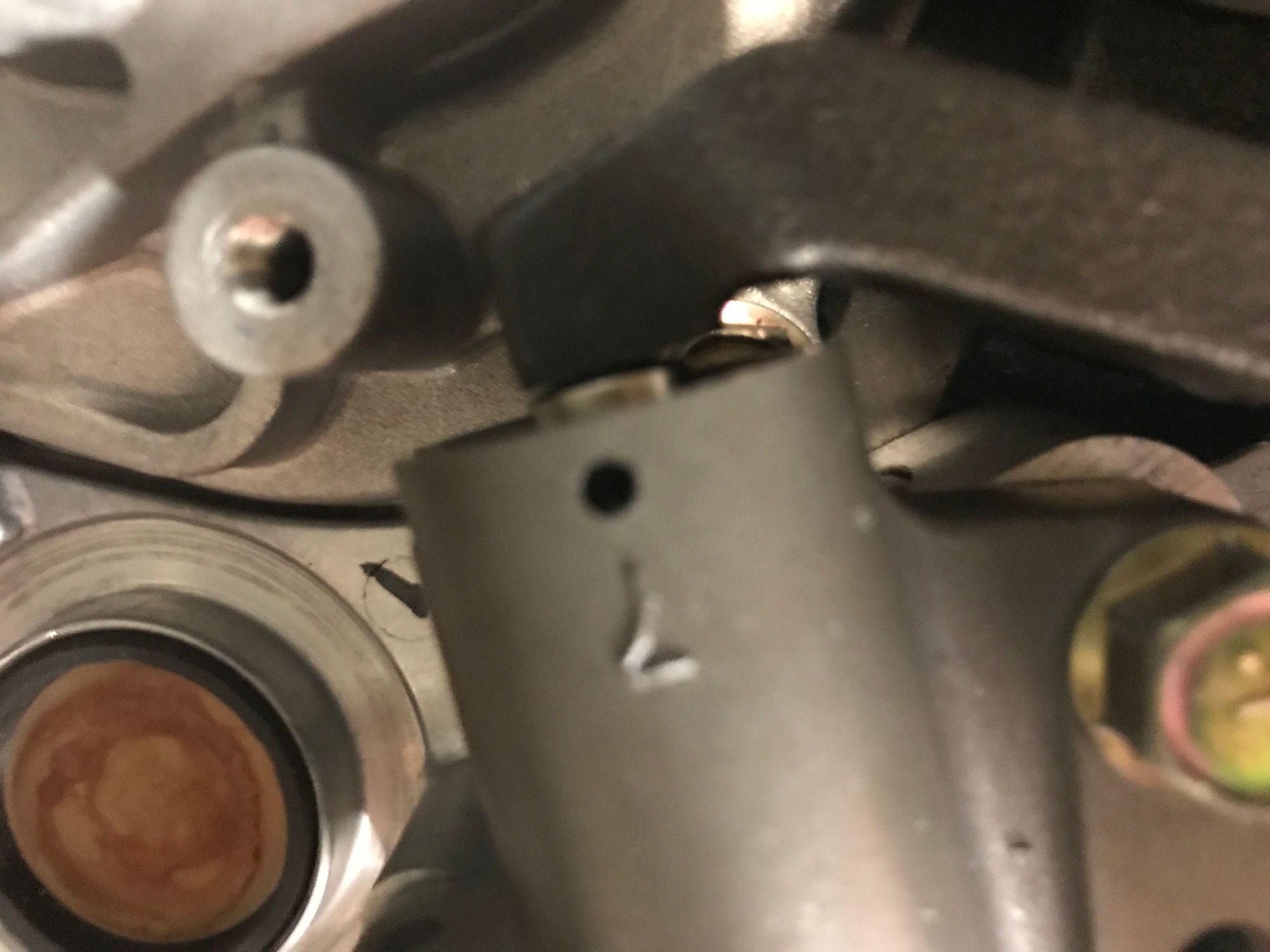

OK, so I was able to pull it apart tonight. This is what I found.
1. The grenade pin moves in and out of the tensioner freely as it should.
2. The tensioner did have some oil at the bottom. A few drops, but not enough where it actually dripped off the tensioner. I'm going to order an OEM tensioner & replace it. If the pin still move in and out freely, then would the oil drops be the issue?
3. I can't remember if I installed the belt clockwise starting at the exhaust cam gear, but all timing marks line up perfectly.
4. I checked the tensioner pulley and it was torqued correctly to 35ftlbs.
5. I didn't check the tensioner arm since the belt was still on, but I did see where I had previously applied grease so I'm pretty sure that I had checked that it moves freely, when I did the install.
6. I took a video of the tension between the Intake Cam Gear and the Tensioner Pulley to show the amount of play.
7. I'm going to order an OEM belt. I read that the Evo 9 belt is better than the Evo 8 belt. What do you think?
8. I'm thinking about ordering a Kiggly 12 tooth Crank Trigger, since I'm running AEM Infinity. Anyone have experience running this setup?
9. I called GSC and they confirmed that their lifters should be installed fully extended. It also says this in the factory manual, but to fill it with diesel fuel instead of oil. So much conflicting info, but it seems like nearly everyone is installing them squishy, so I'm going to do that.
Not sure if I'm missing anything else.

the evo 9 belt is a good belt... thats what i have on mine.
since the tensioner pin is in the correct position... geez man i dont know.
the last video you posted looks about right to me.
i guess my point above... is if the tensioner is working correctly, and the belt is not defective, it wouldnt let the belt have that much slack in it no matter where the motor is in its rotation.

I didn't read the whole thread, but I noticed the oil on the tensioner. Did you put any thread sealant on the tensioner bolts? If I remember right, one or both of them are connected to the oil lines.
