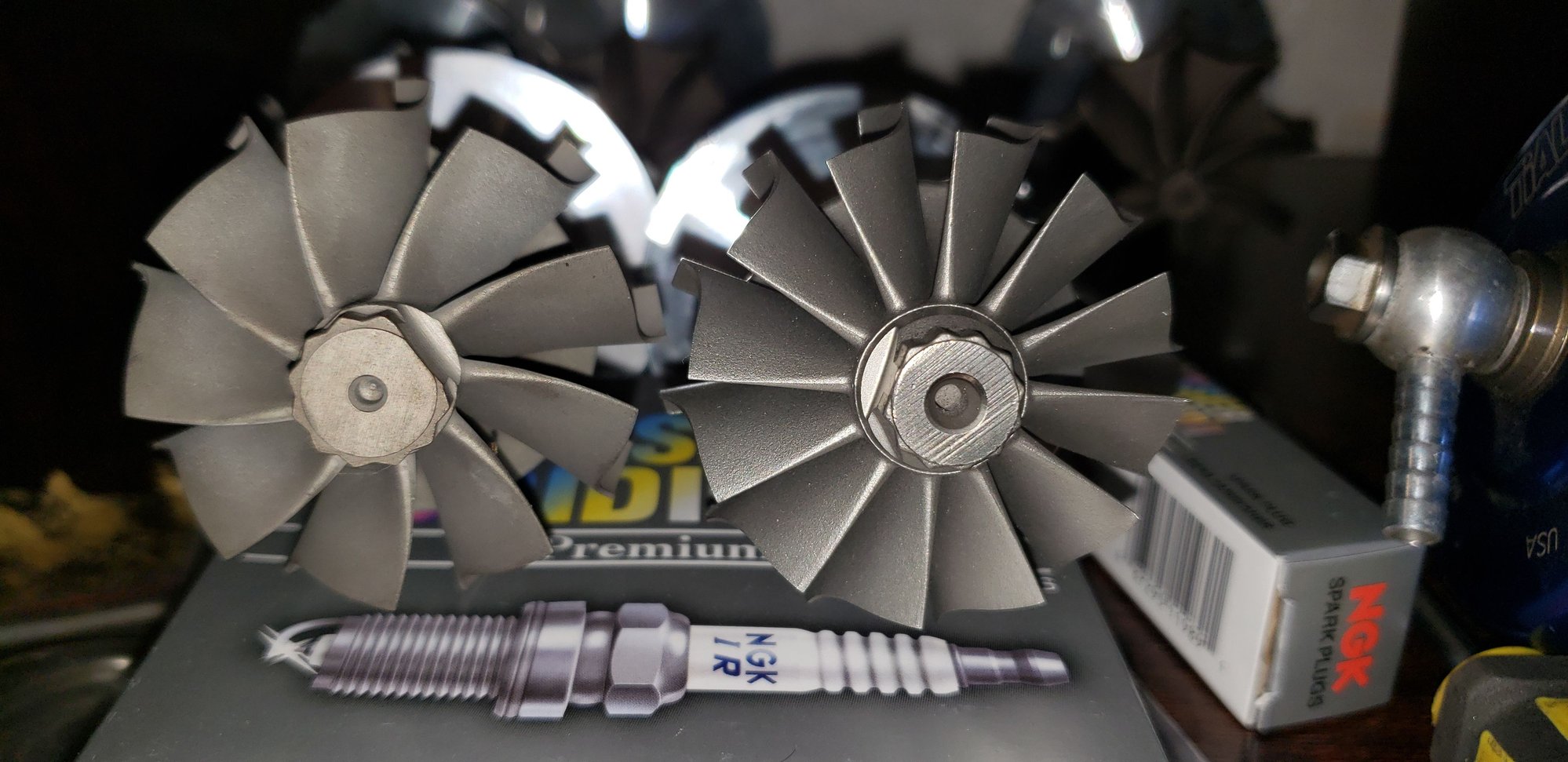

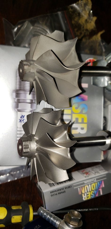

In the stock twin scroll turbine housing, you will always choke the engine after 6500-7000 rpms. The only option to help is to use the 9 blade design to reduce backpressure. The 59mm compressor wheel will move more air than the 55mm to help airflow (with more lag).
Here is are some pictures to show you the difference between stock 49mm 12 blade turbine wheel and 9 blade and a picture of the 9 blade 59mm I suggested using with 55mm or 59mm compressor wheel. The last picture is 60mm vs 55mm compressor wheels (big difference in size and lag). But with 2.4L, the lag may not be too much more.
