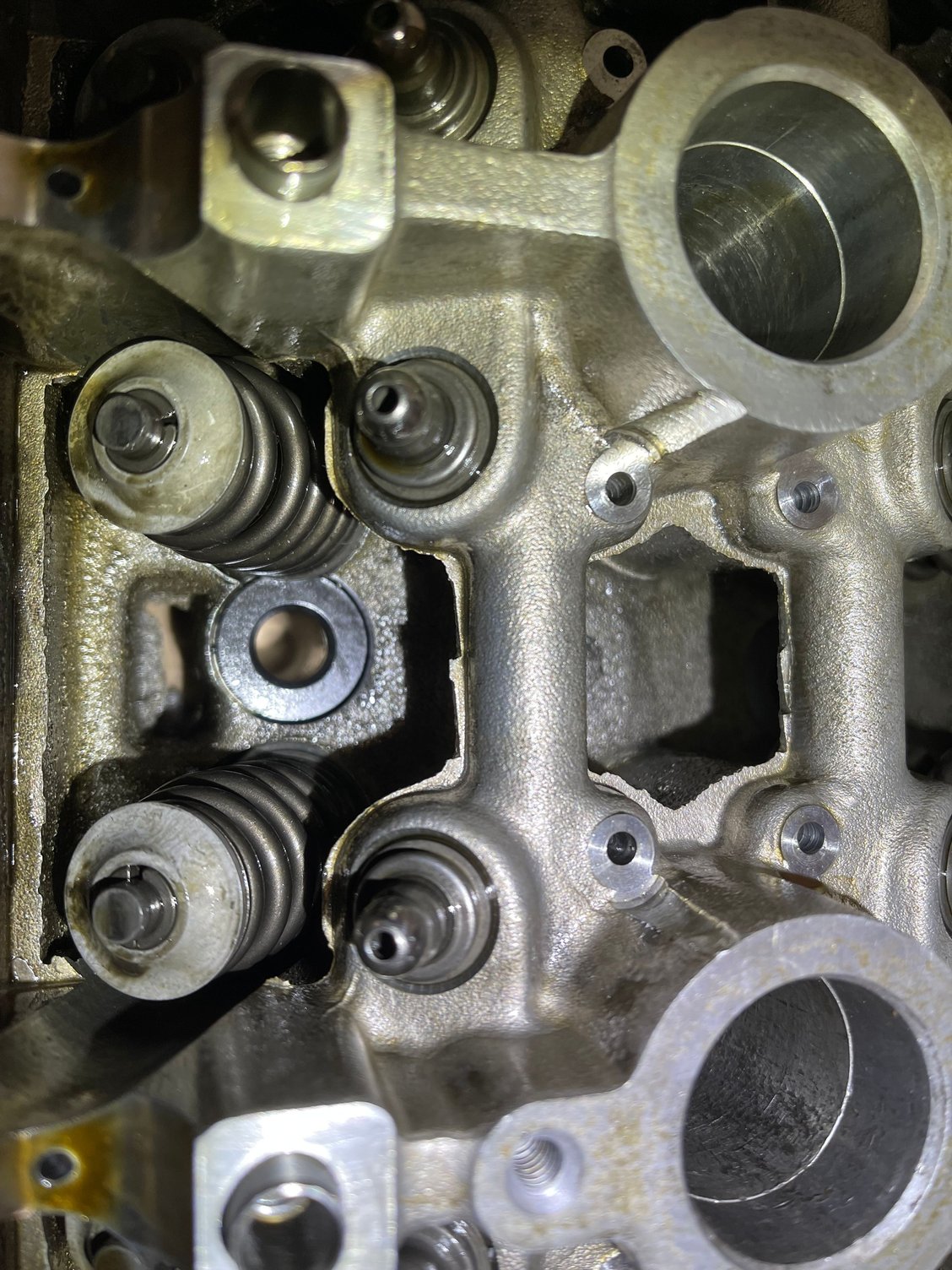

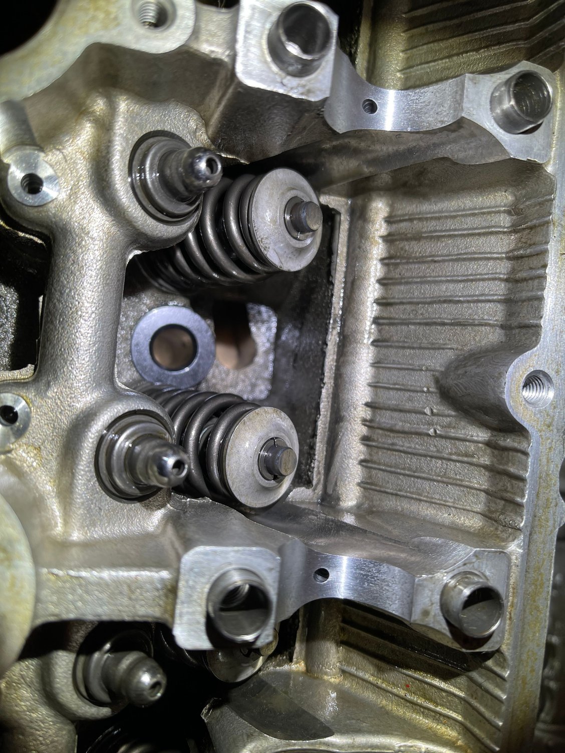

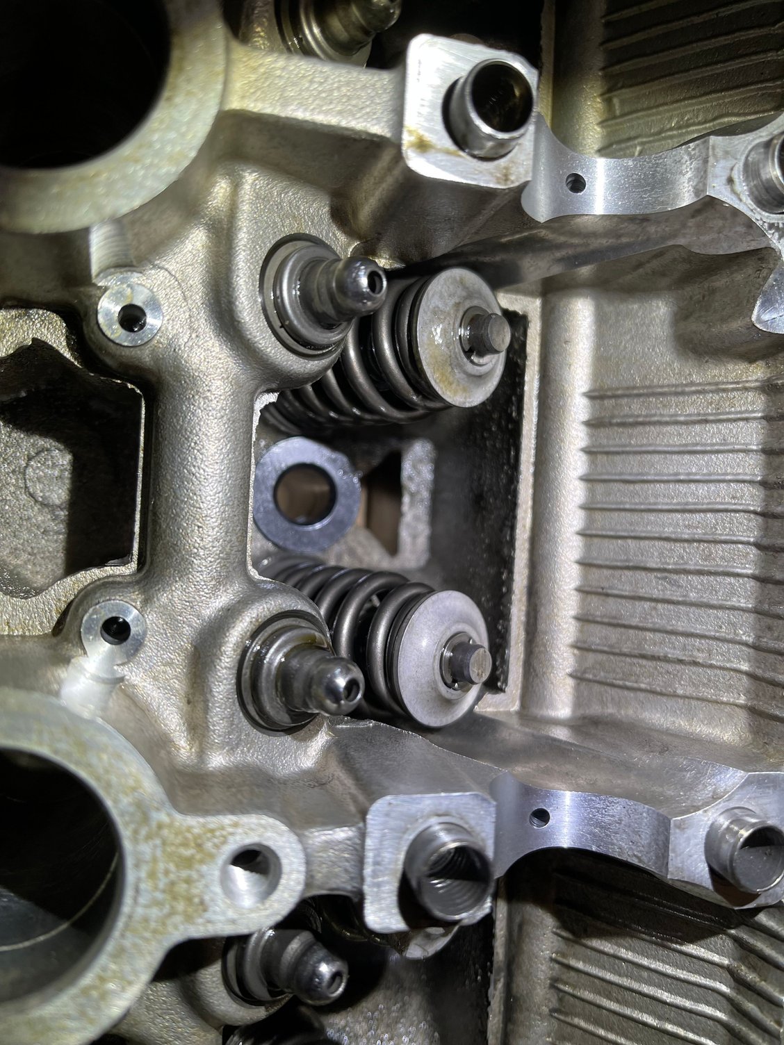

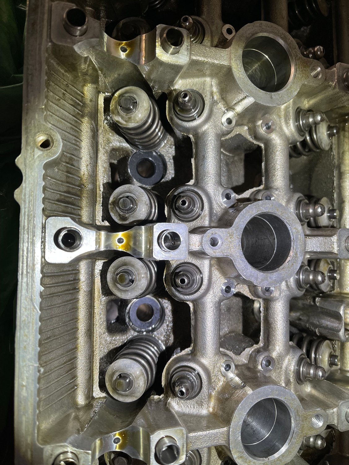

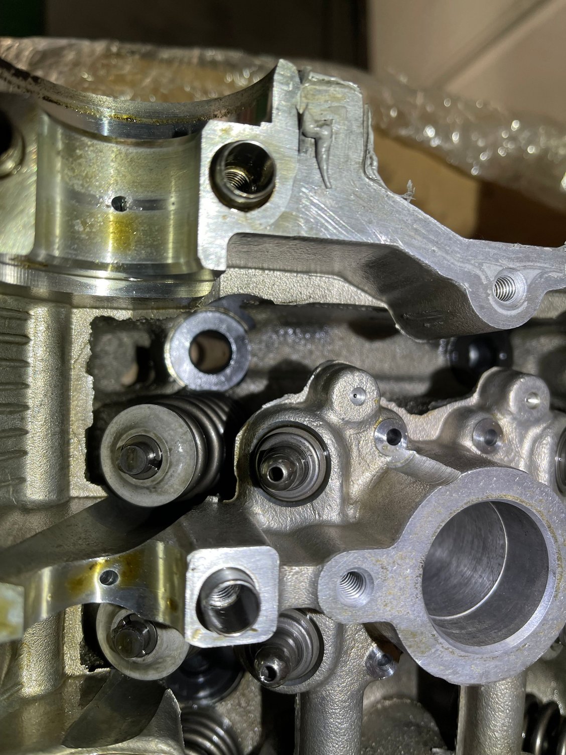

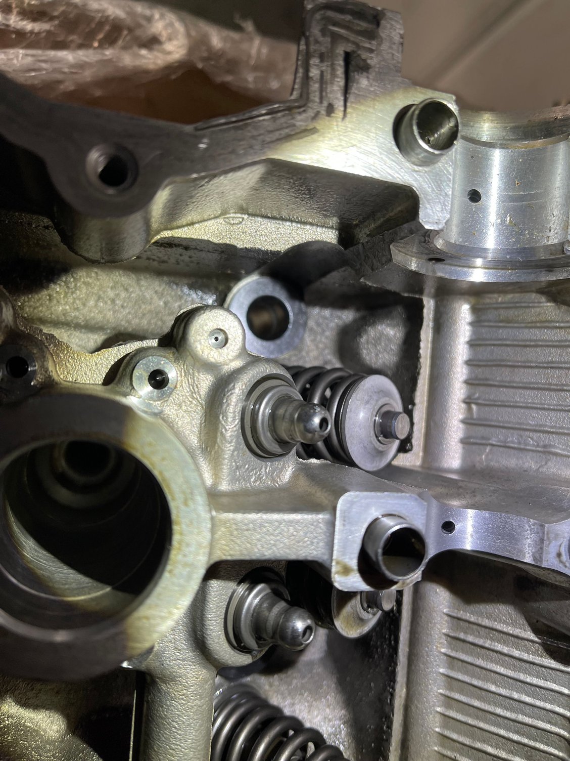

Arlington Machining Oversize Headstud Washers

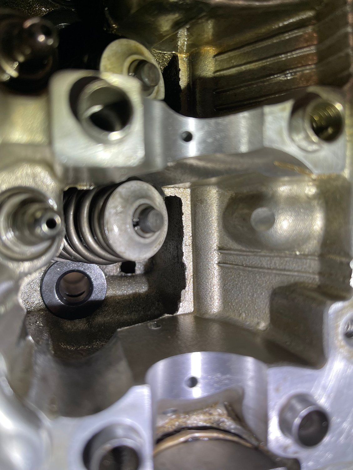

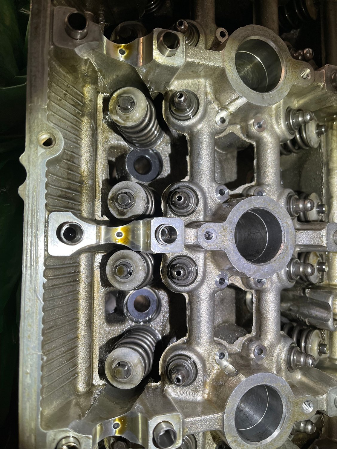

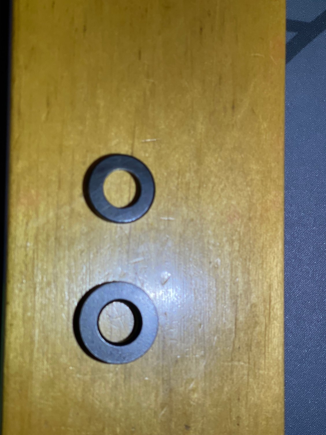

I've been looking for a set of over size washer for my Evo 8 head with ARP 625 studs. We know the washer ARP supplies will dig into the head when torqued over 100ft.
The solution was to get a set of Whalen Speed washers but I've been unable to source it from them. Arlington machining out in Cali has his own set that fits like a glove.

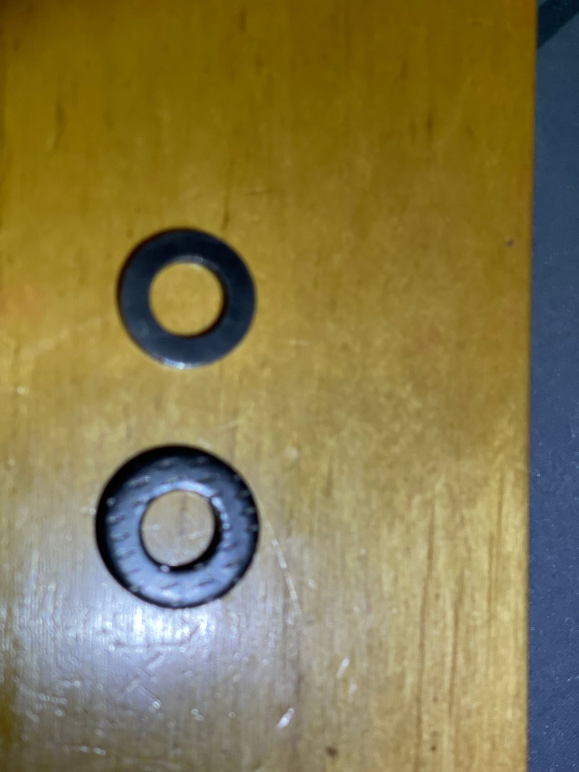

ARP Washer size:
OD: 0.8115in(20.61mm)
Arlington Washer size:
OD 0.9475in(24.07mm)
As you can see, it's a whole 4mm bigger which fits like a glove in the washer groove.
Front
Back

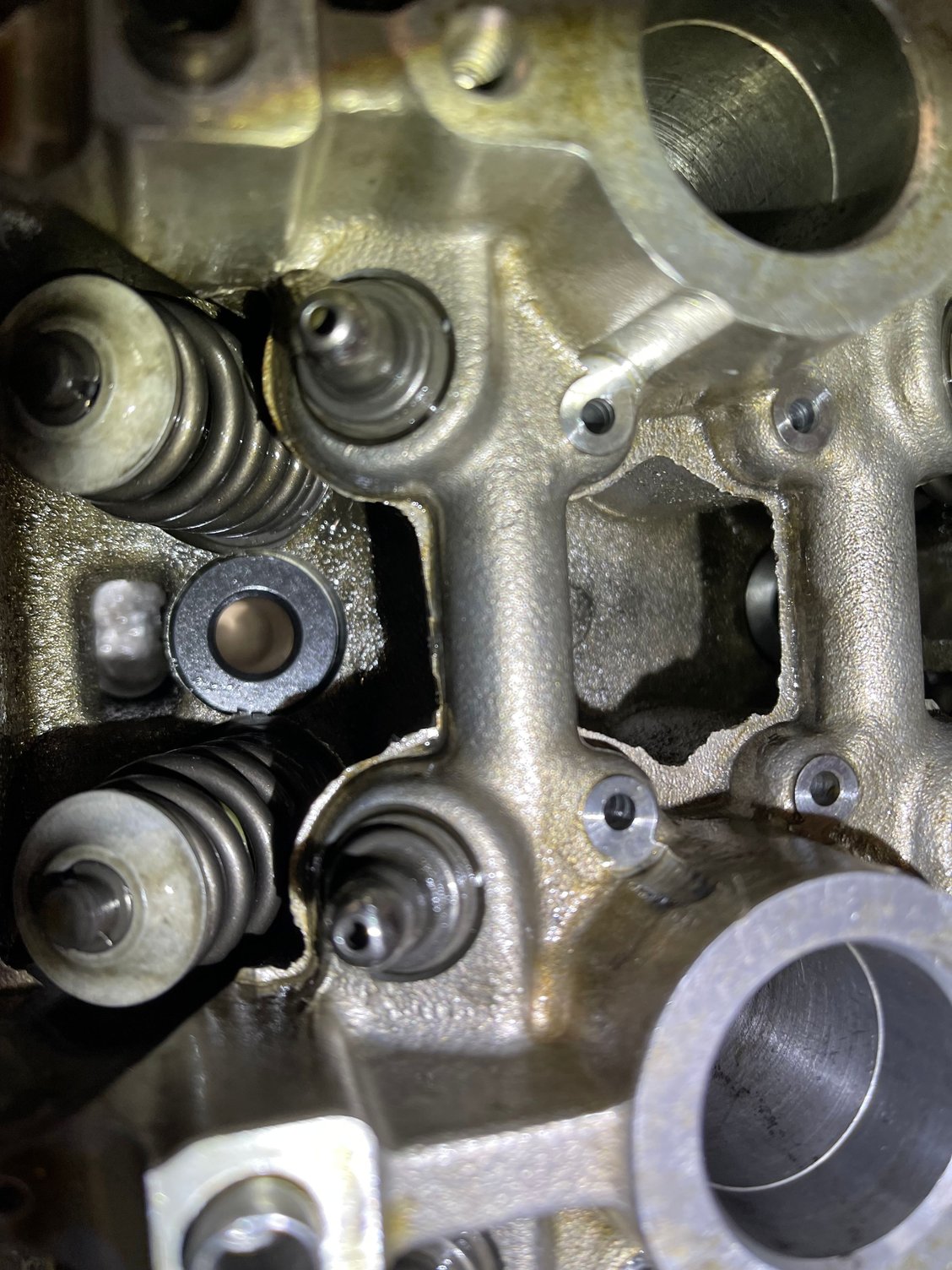

Comparison of the washer in the head

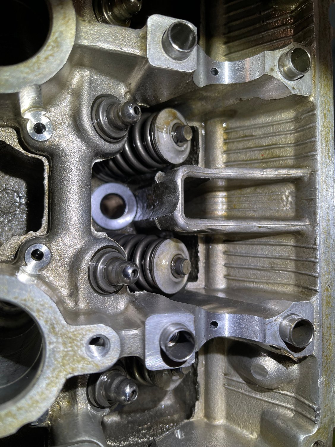

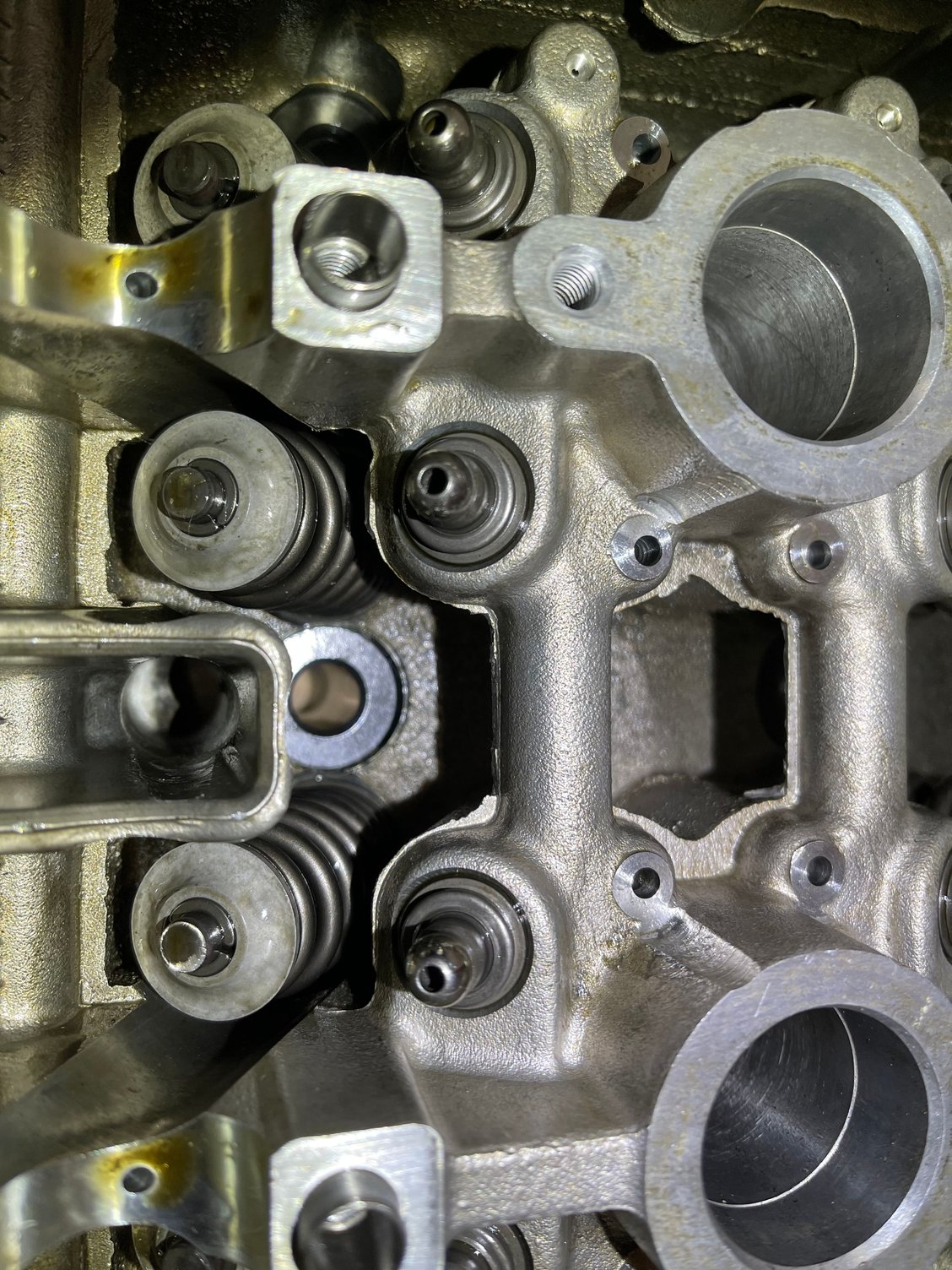

Install Pics in all 10 slots.
