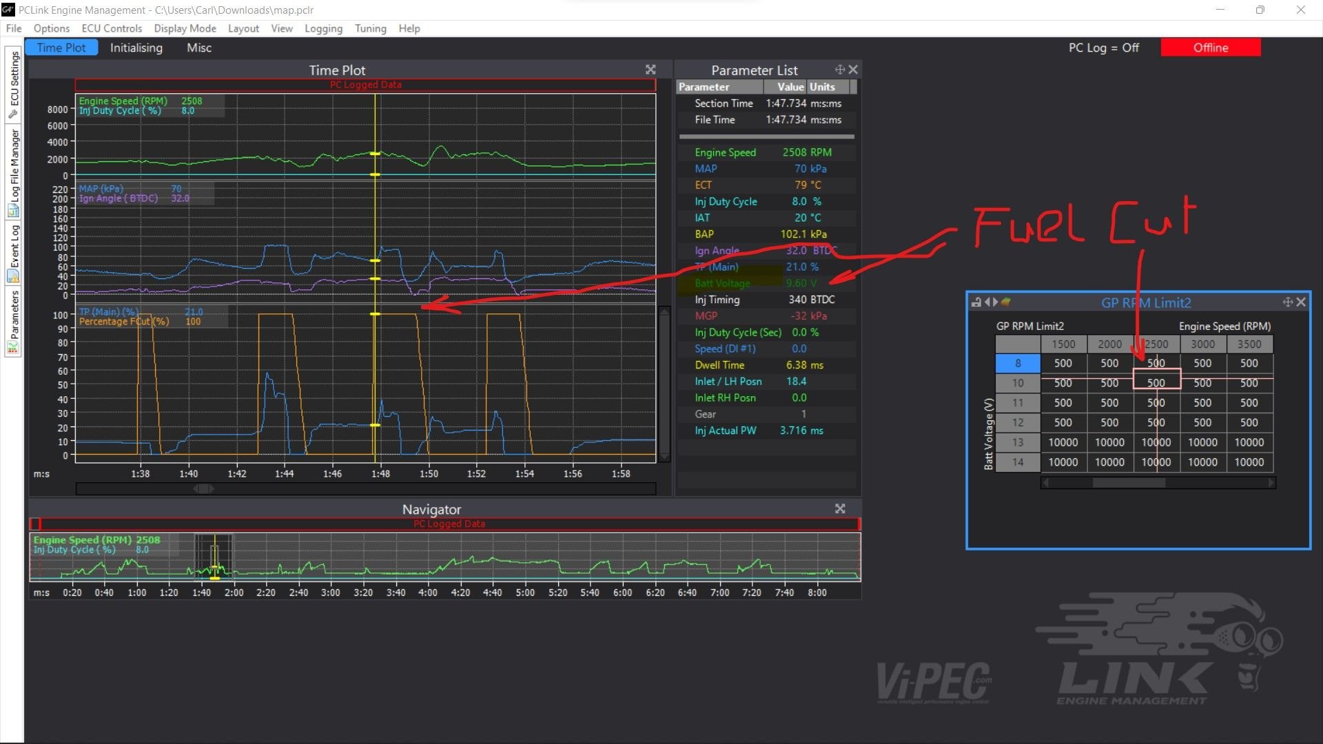

Varv - You are hitting 100% fuel cut due to what looks like a very low battery voltage of 9.6V. Find out why your battery voltage is so low.
Details: The Engine Protection setting in the GP RPM Limit 2 table is set to apply a fuel cut if the battery voltage is below 13V and RPM is greater than 500. Your logged battery voltage starts out at 12.02 V, and drops to 9.6 V, so fuel cut will happen once engine speed exceeds 1000 RPM. The fuel cut happened 4 times as you tried to accelerate with a low battery voltage. Then it increased to 13.74 V and everything was OK.
Correction Required: Charge your battery up, or remove the engine protection setting for low battery voltage by increasing the RPM limit in the GP RPM Limit 2 table to 10000.

Varv - You are hitting 100% fuel cut due to what looks like a very low battery voltage of 9.6V. Find out why your battery voltage is so low..
Thank you so much
Now it all makes sense. I'm getting some strange noise from alternator when starting the car, so maybe it is failing. Anyway, I will check the electrical installation to be 100% sure. Thanks again!
