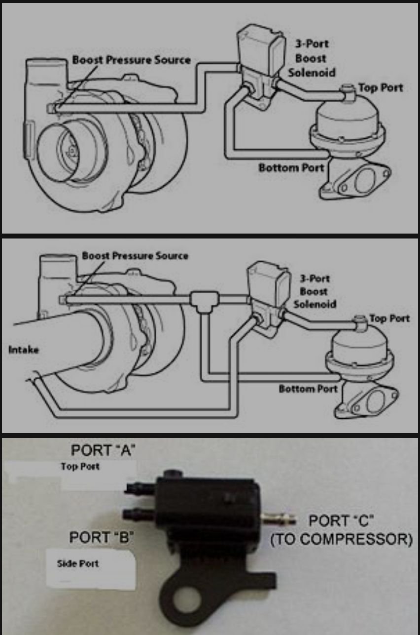

hi how did u connect the pipes from wg too turbo and boost solenoid?.
when i hooked mine it over boosted but when i gave gate pressure boost was what was correct according to spring... how did u plumb your lines?

I have an MHI housing so its internally gated but its the same idea. I have my boost reference pulled off the J-pipe off the turbo, to a 3 port boost control solenoid and then to the wastegate.
I run the GM 3-port so I use so like at this link.
https://www.evolutionm.net/forums/ec...ml#post5660901

hey so you used the top picture correct?

I used the bottom picture. I am running the GM solenoid, not the MAC-style. But I only have 1 port on my gate so I have one of them VTA.

i dont have fitting on my intake so i dont know how to use the bottom pic... but my looking at both they both look like they doing the same??

The one to the intake can be VTA if you are on speed density. Yea, the one with the valve hooked to both ports on the gate allows for more accurate boost control generally.
