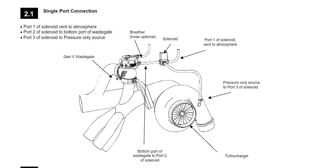

tried 2.1 and it held boost just fine... so I'm rolling with that..
​​​​​​since fp turbos are not big turbo they don't need max boost method so this is the best method too do plumbing in my opinion for fp turbos external or internal wG.

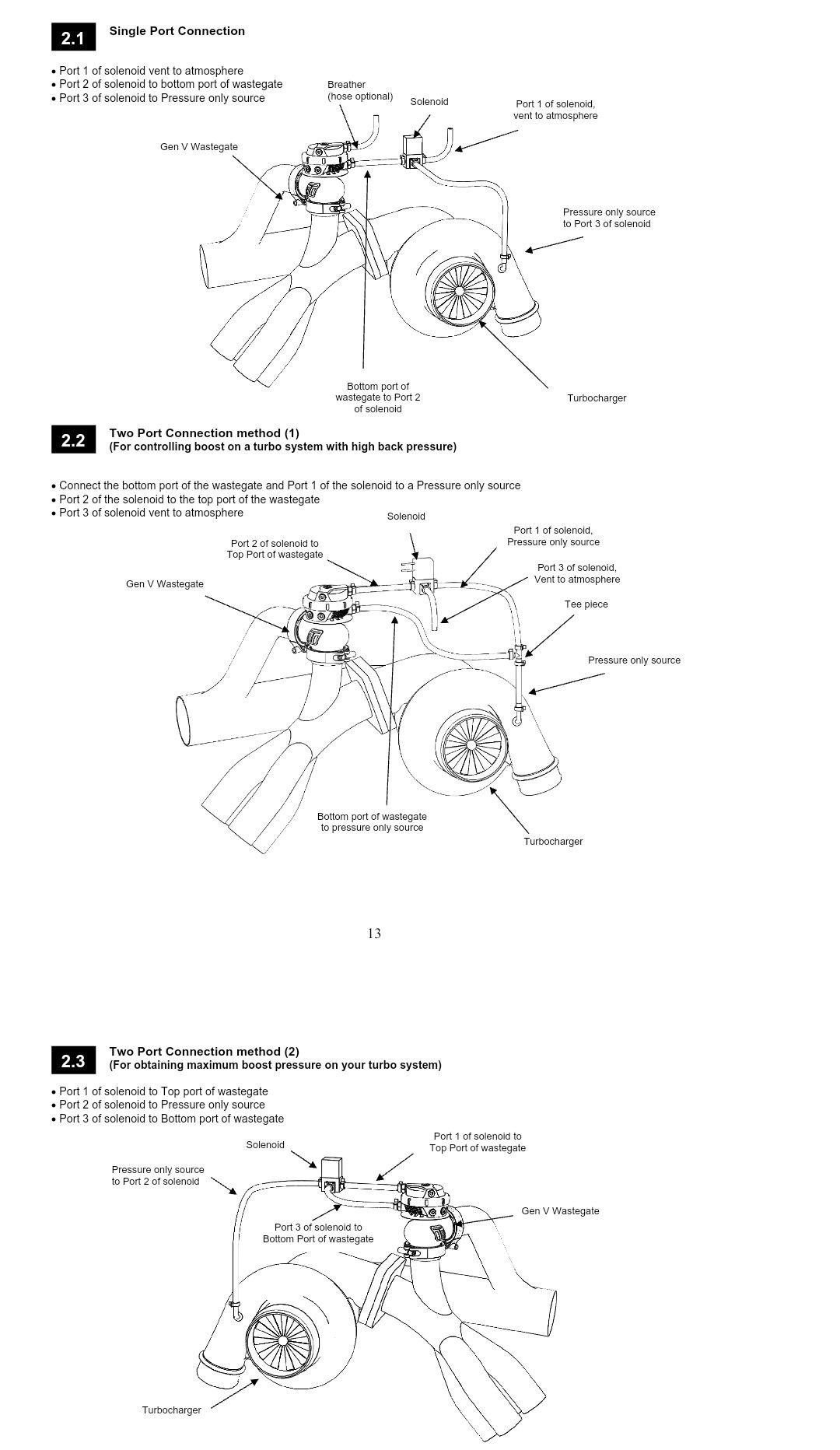

​​​​​i went with this method 2.1 (single port method) and the boost was held fine with control attached and energized... didn't shoot up boost so im going with this plumbing... i figured since fp are not big turbos it dont need max boost method i.e 2.3.....also fp them selves recommended i dont use 2.2 method as their turbos dont make much back pressure.
