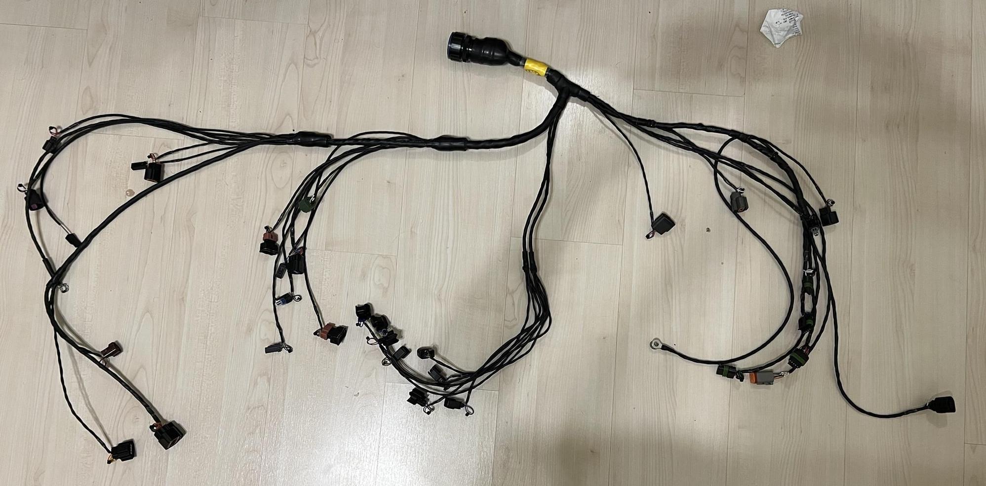

From right to left the second branch is all 8 injectors on my Ohm Racing built engine harness

easiest solution is to make a new harness for the injectors to the ecu.
new injector harness will have switched 12v and the 4 injector signals at the ecu (only 5 wires, 5-8 injector outputs on Haltech ecu and switched 12v from harness). The 12v power will T out to each injector in the harness.
if you can’t build or find one you like feel free to pm me I’d be happy to build one for you if you take the measurements you want for total length.
the other alternative would be to go with a fresh engine harness that includes 8 injectors. If you get a complete harness you may also want to utilize 4 coil outputs for direct fire vs the stock 2/wasted spark. (2 birds one stone)
