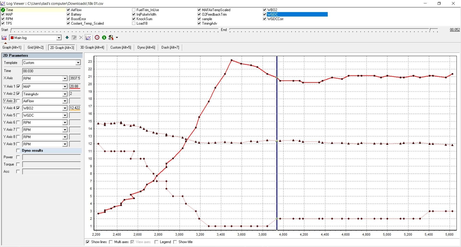

I have installed an 18k that I've had for a while and am starting to dial in the boost curve. I am getting a nasty fluttering sound at spoolup when going WOT, hopefully evident in the airflow/load curves shown.
This clears up above 5k rpm and pulls smoothly. Stock block and head with HKS 272 cams. Was running a crushed 9 DV but have switched to a Synapse and am unable to dial it out.
Am I over-driving the turbo and getting real surge? Softening and delaying the spool helps but does not eliminate the noise. I would appreciate any advice.

Is the MAP value an absolute reading (what MAP implies) or is that gauge pressure?
Old May 4, 2022 | 11:25 AM
topper_bob's Avatar
Posts: 48
From: SEPA
Also a good point. "MAP" is showing gauge pressure and just a label.

The posted logs are with the crushed 9 DV when I first experienced the issue. I have found the synapse to be more response at part throttle so far.
Old May 4, 2022 | 01:04 PM
LetsGetThisDone's Avatar
Joined: Oct 2013
Posts: 15,973
Likes: 1,629
Hmm, odd you're getting surge at only 22-23psi of boost. Does it stop doing it if you lower boost?

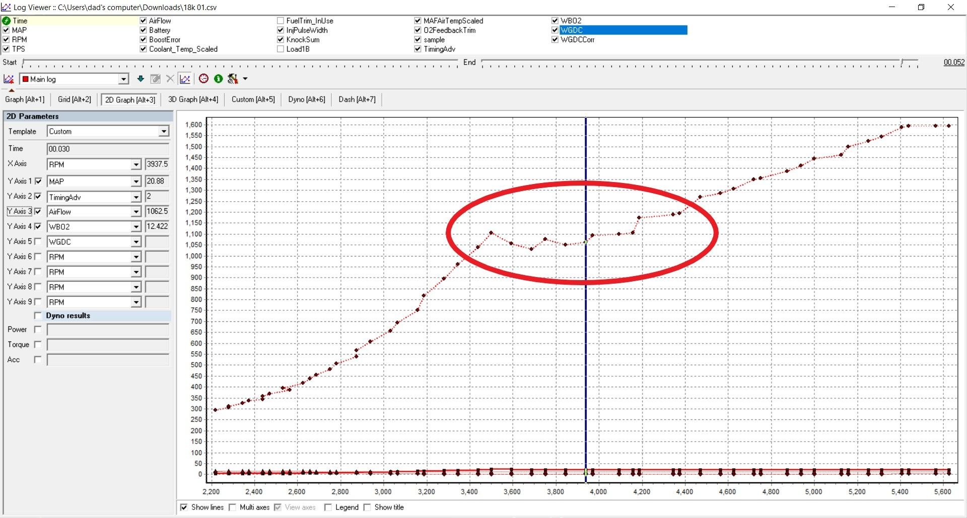

The compressor can surge any time the turbo is discharging more air than the motor can ingest. It's hard to read your logs so perhaps post the actual log file, but is this happening when the throttle is 100% or is this happening during part throttle acceleration?

The 18K flows 54lbs/min without a ported shroud inlet so that is substantially more flow potential vs stock. I'm not surprised that is surges because it's making 23psi at 3500rpm and it doesn't have a surge cover. Instead of forcing 100% WGDC until full spool is reached, you're gonna likely need to dial down the WGDC during spool to cause it to delay.
If I look at the curve of the airflow I assume the area circled in red represents your surge issue, but please confirm.
Old May 5, 2022 | 11:41 AM
topper_bob's Avatar
Posts: 48
From: SEPA
Correct, that is the area. Thanks for taking a look.
Yes, I am coming from an older turbo with less flow so I wasn't expecting the response/airflow down there and I've never experienced a WOT surge issue before.
I will just work my way up with the WGDC and give the motor what it can take. Boost is just a number.
