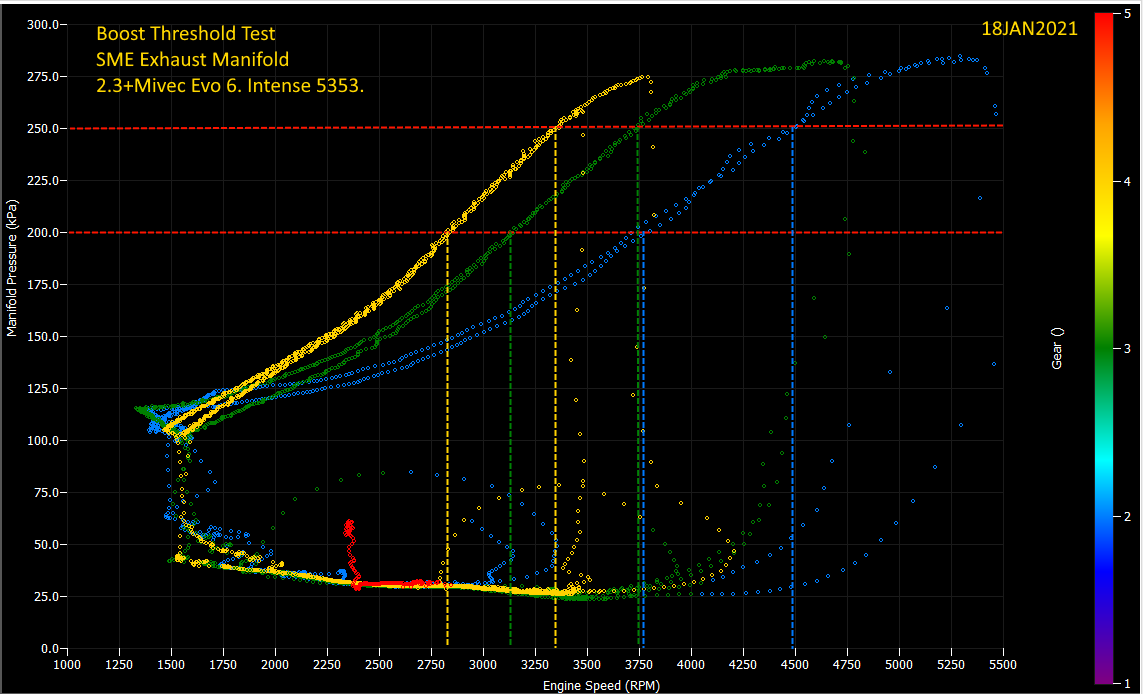

Originally Posted by anasmamoon
How much power were you able to push on your 5353rs? Any dyno sheets?
360kwatw (480whp) on Dynapak and 322kwatw (431) on Mainline dyno.
Kinda like Dynojet and Mustang numbers.
98 Pump gas (USA 93 octane).
Boost Threshold table below as well.
2.3L Stroker + Mivec.
Yellow - 4th
Green - 3rd
Blue - 2nd
250kpa line is 22psi
