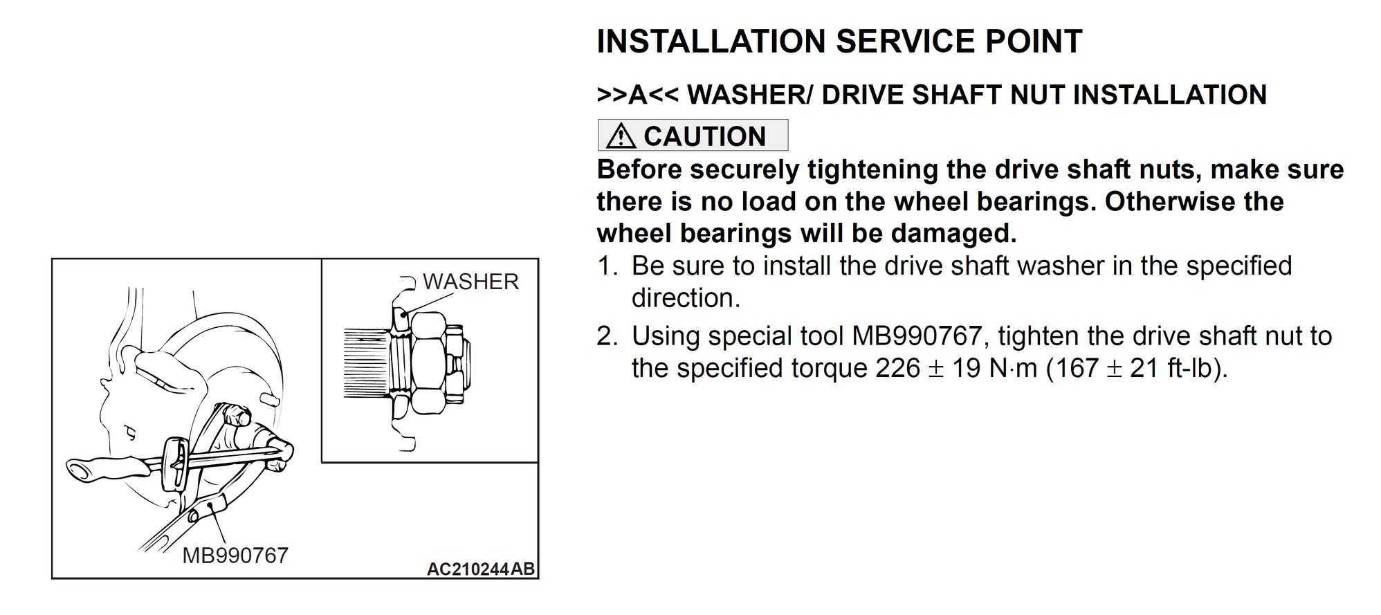

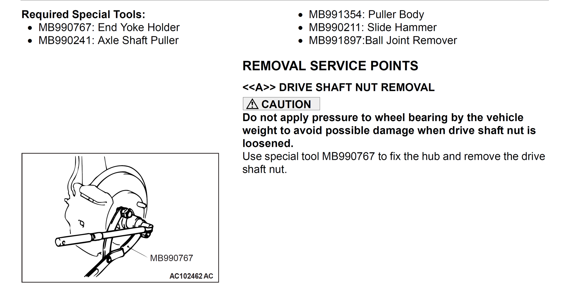

No idea if you did either of these, but just a P.S.A. for anyone doing work that requires pulling the axles. There are a couple of gotcha's (Service Points).
Old Aug 3, 2022 | 08:28 AM
Drmadman's Avatar
Joined: Jun 2021
Posts: 23
From: Hudiksvall
I didn't do it with the special tool but otherwise yes, I did it without putting any load on the bearing as it says.
