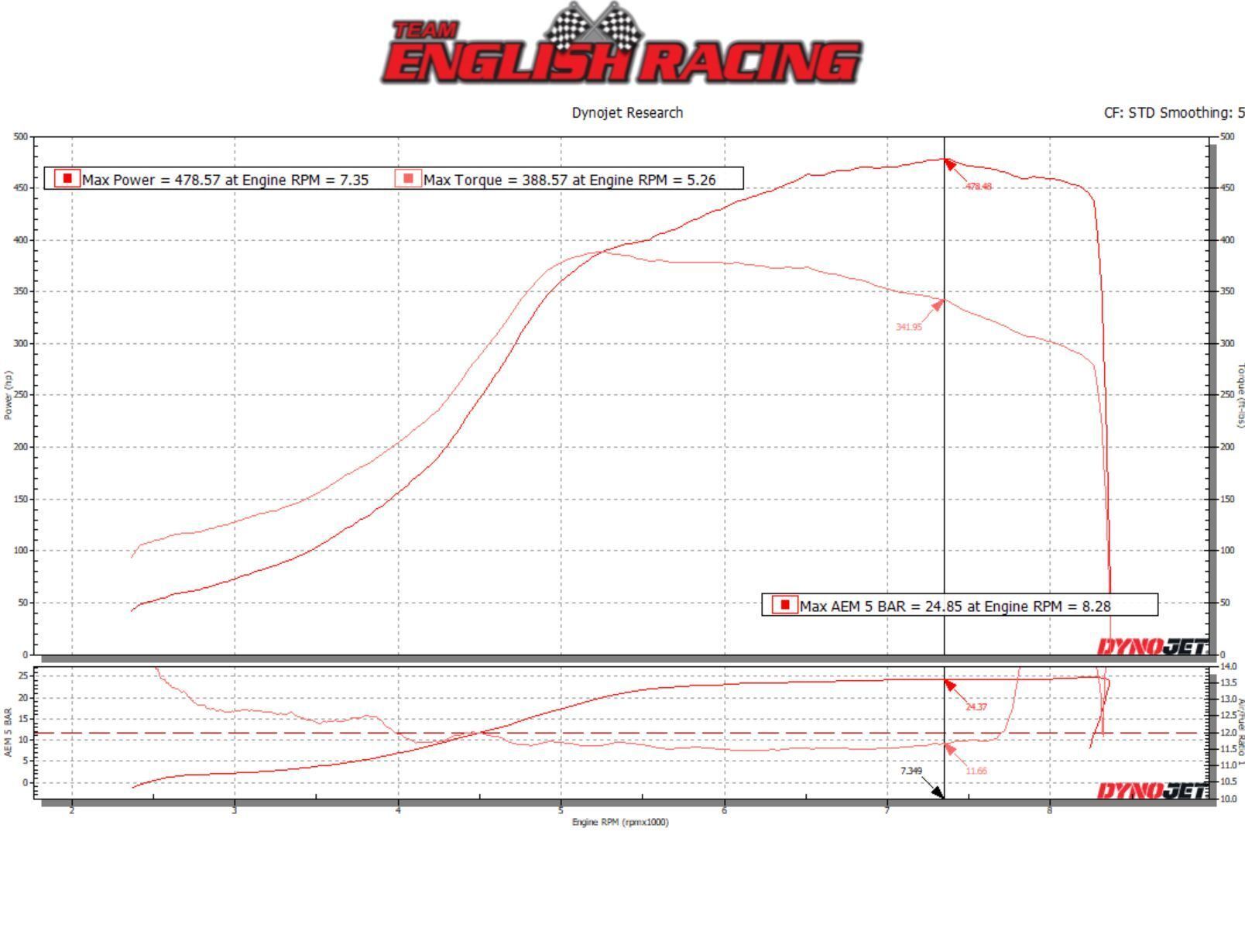

It is my current suggestion for any road race car actually. Here is a dyno sheet from a 2.0L, 3582, S2, etc. (normal) with "guess the compression ratio". The car was dyno'd on normal Chevron 92 octane a mile from our shop where I have gotten fuel for the last 17 years. The AFR at the end was the sniffer blowing out of the exhaust but other than that I think it gets the point across.
