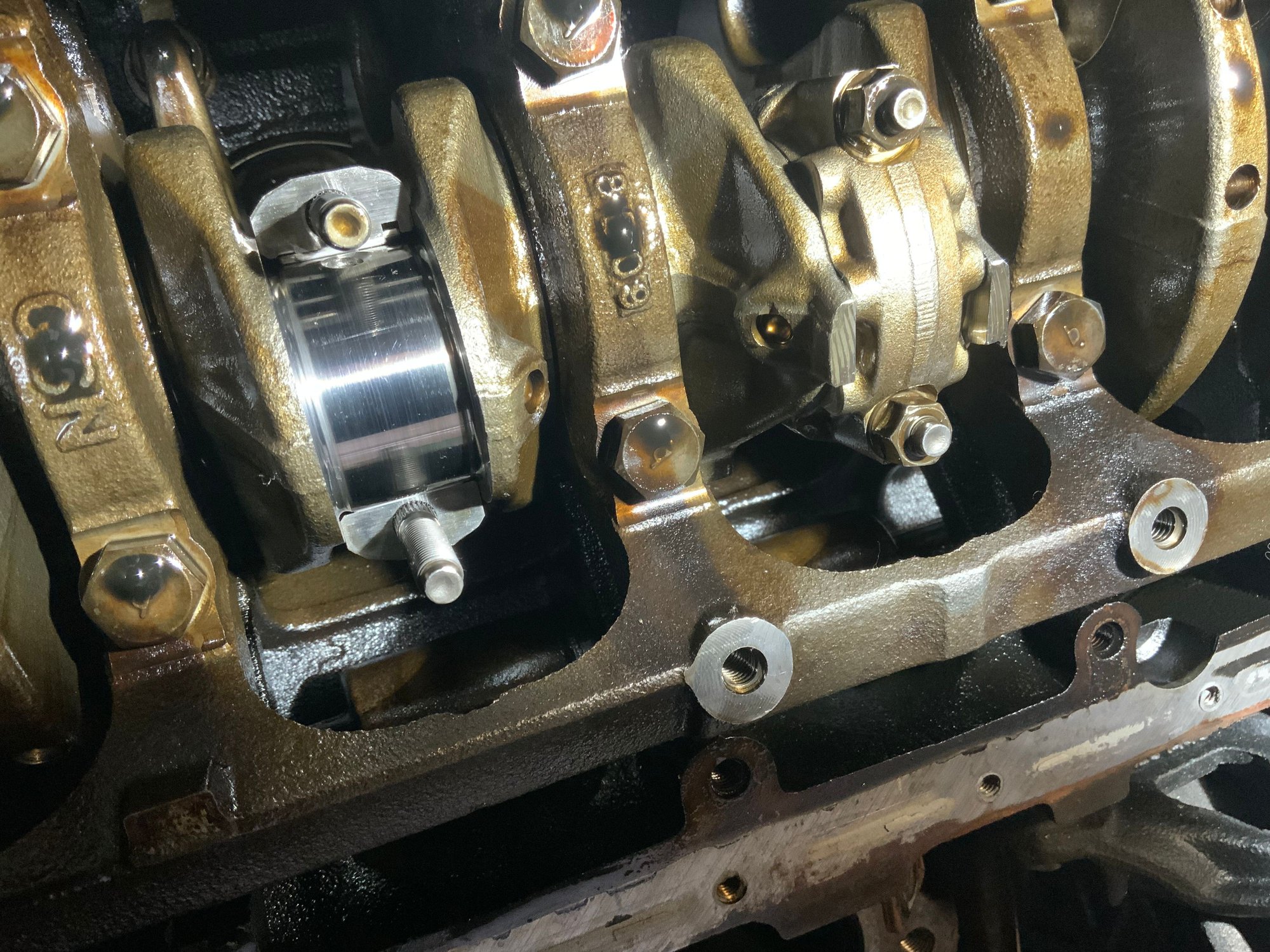

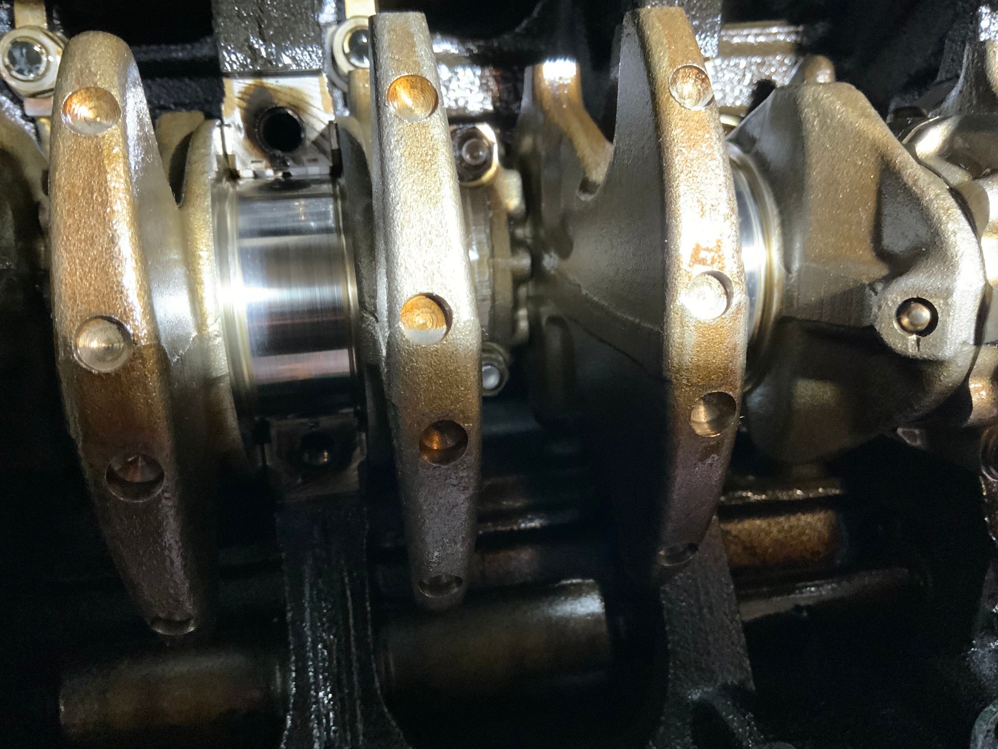

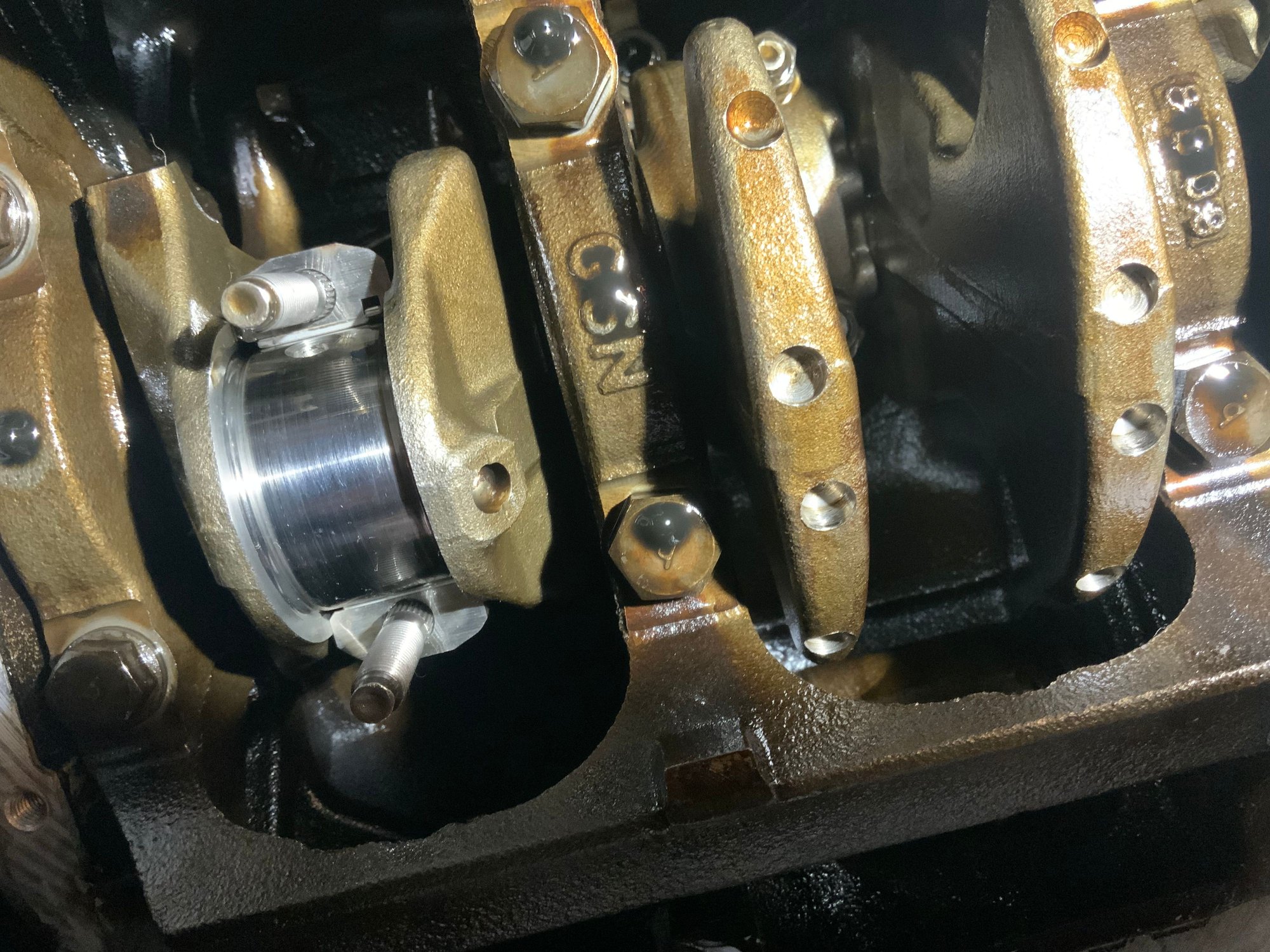

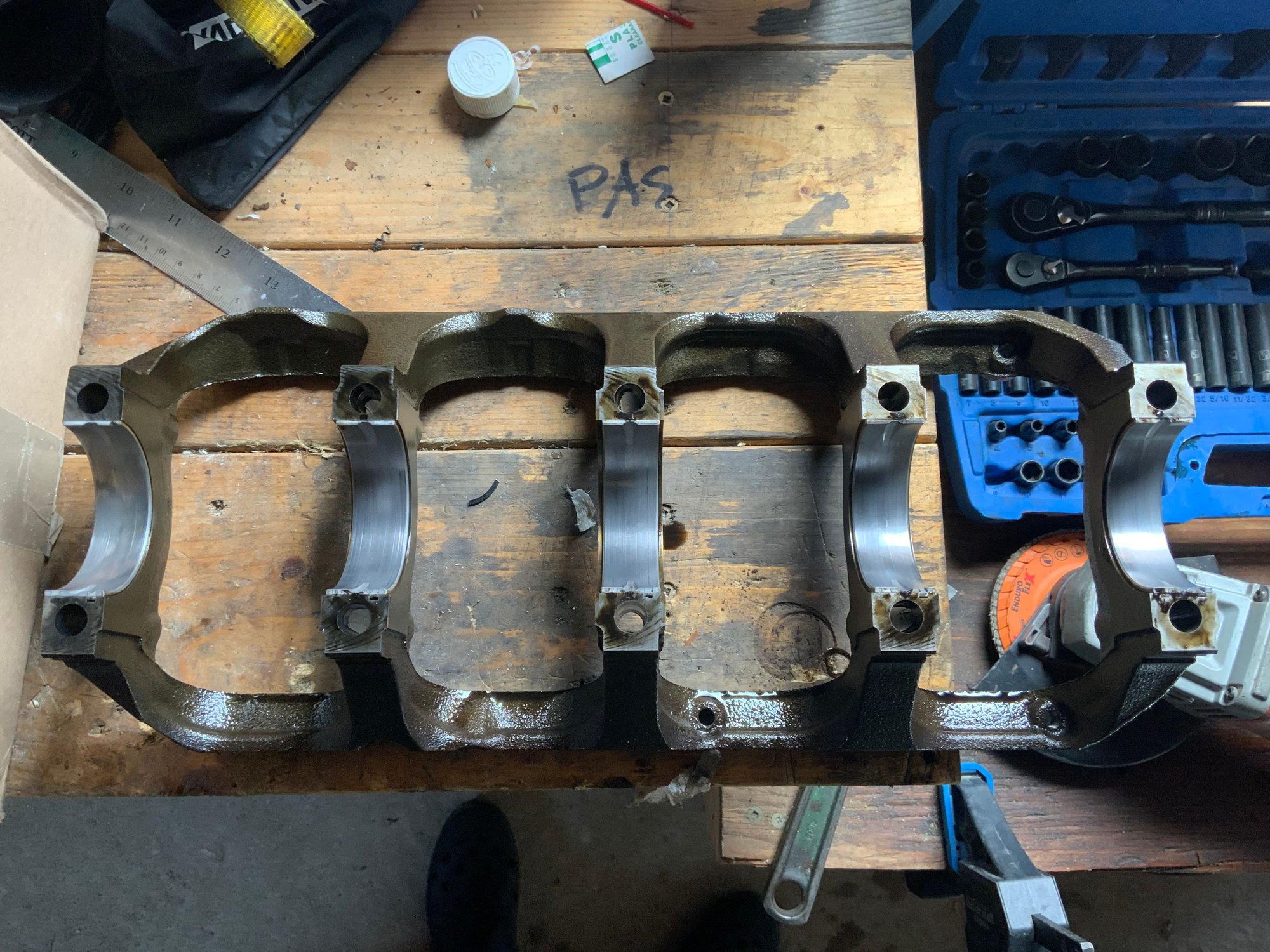

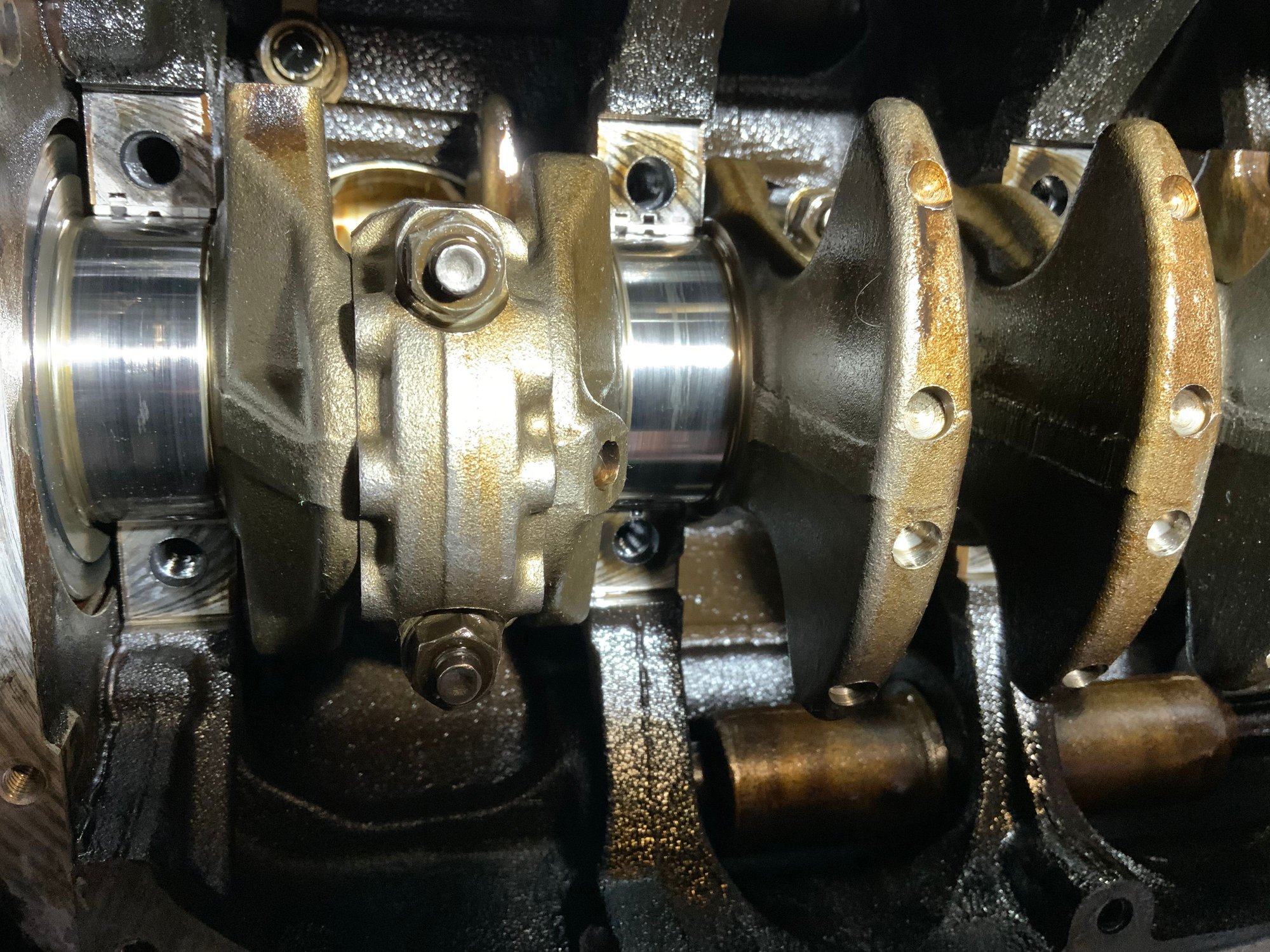

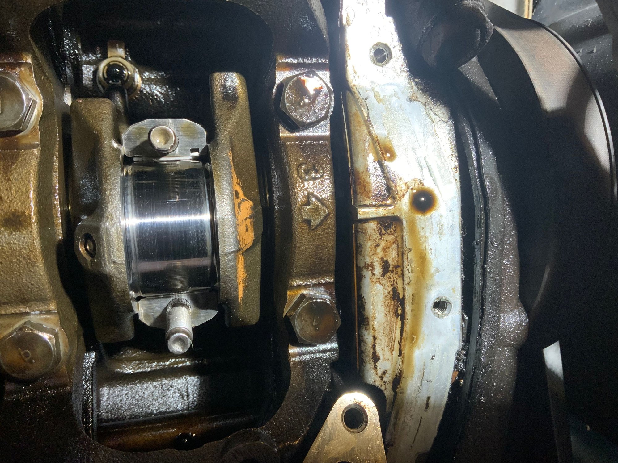

New to this forum but not to evos. I have a 98 evo v, fully stock apart from the secondary air system delete. I currently have the oil pan off to inspect the condition of the bearings and crank and wanted some opinions on the condition.
I measured all the clearances with plastigage and it’s 0.0015 across the board with oem torque settings / torque pattern.
The rod bearings have what appears to be some scoring, but running a finger nail across it you can’t feel them. The main bearings have some scoring which you can feel with a finger nail. The crank seems to be good with no hang ups running a nail across the surfaces horizontally. There is one journal that appears to be scored, but running a nail across it you can’t feel anything at all.
Rod 1
Rod 2
Rod 3
Rod 4
Girdle
Main with scoring that can’t be felt with nail
Plan is to replace all the bearings with the motor in with ACL bearings, and I wanted to check opinions on the condition of the crankshaft.
*Forgot to mention car has 105k miles on it*

I'd bring it to a machine shop for a professional opinion, personally I'd at least get them to polish it and see what comes out. You've got lots to play with on clearance, so there's no harm in it. Anything 0.020" to 0.025" on clearance after is going to be just fine.

Crank should polish up fine. Looks like normal bearing wear for the mileage. May a bit extra because the car probably sat a lot, so it may have had some dry-ish starts.

If the photos are an accurate representation, the most I would do is replace the bearings.
