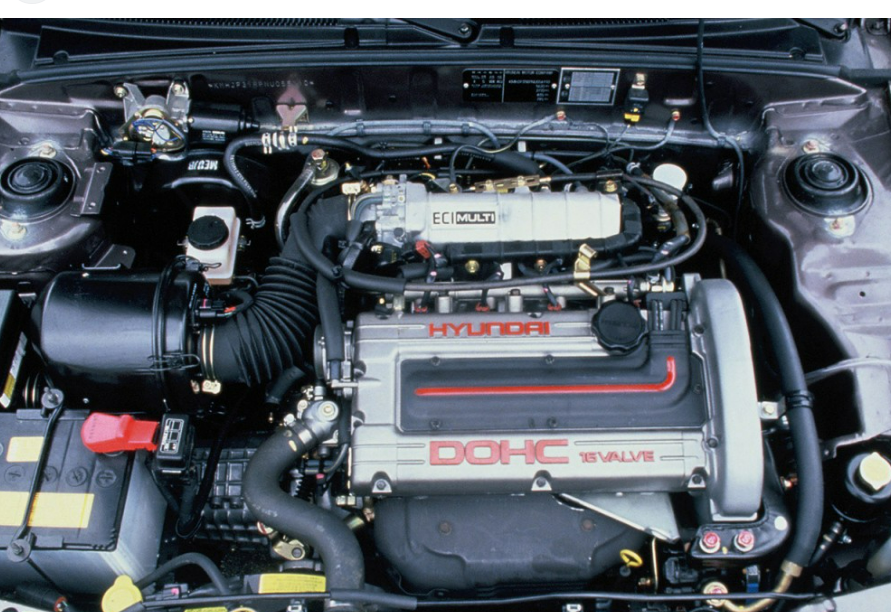

Old Sep 29, 2023 | 11:50 PM
Jaime4g64's Avatar
Joined: Sep 2023
Posts: 1
From: florida
Talking
the hyundai g4js head is the same one as the evo 8 head the crankshaft is also forged. cars it comes with is the hyundai sonata 2000-2004 ;] and if you want to do a 6 bolt swap the 1991-1993 hyundai elantra comes with a 4g63 .
