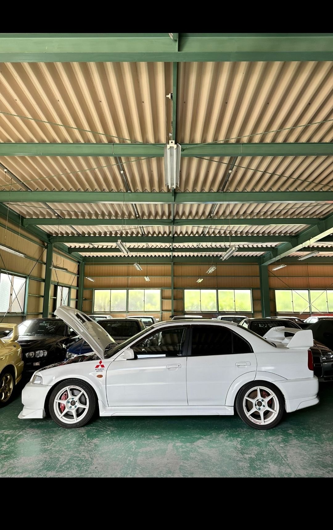

In the next few months my EVO 6 is showing up from Japan.
Goals of build: up to 500whp
Reliability
Fun
Simplicity
(I know pic 2)
My ideas but I'm open (why I'm posting).

It got off the boat in Jacksonville Tuesday. It cleared customs yesterday and I should have my guy get it today. Then ship it to me in the fly over midwest.
Evo 6 gsr. I'll send pics once I get it.thanks.
