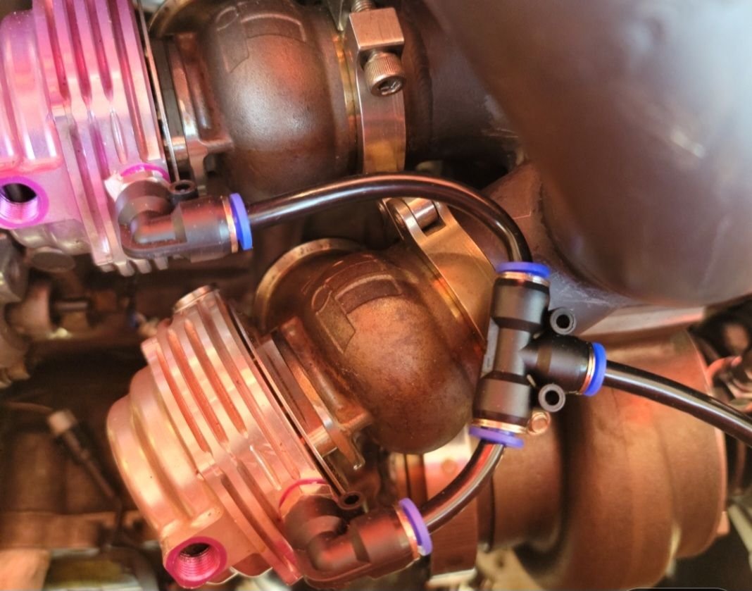

I'm close to finishing my big turbo build and need some insight. I'm running a t3 open scroll dual wastegate with a Pulsar 6466. I'm wondering if I set this up correctly.

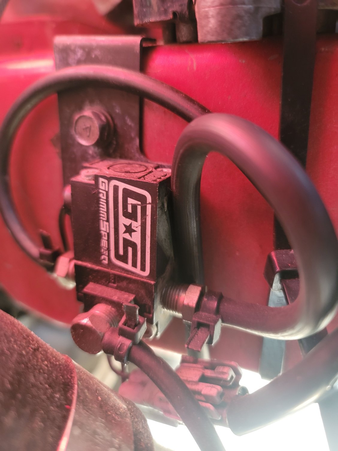

The wastegate side ports are teed and connected to port 2 of my Grimspeed EBCS. The tops of my wastegates are plugged. I wanted to make sure this was correct.

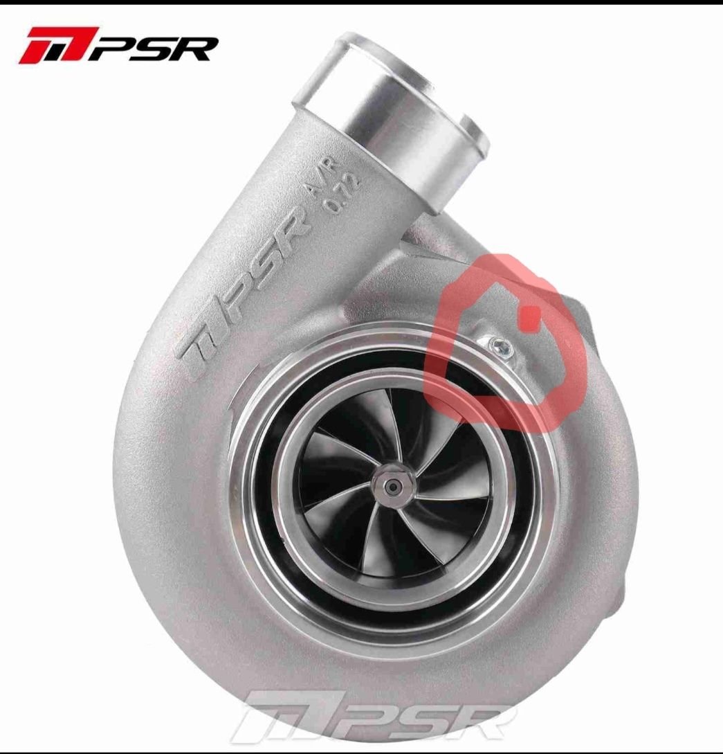

Port 3 would go to the compressor housing of the turbo via vacuum nipple. I'm unsure what would be the size of this vacuum nipple fitting that would go to the turbo. I provided a picture and maybe someone can tell me.
