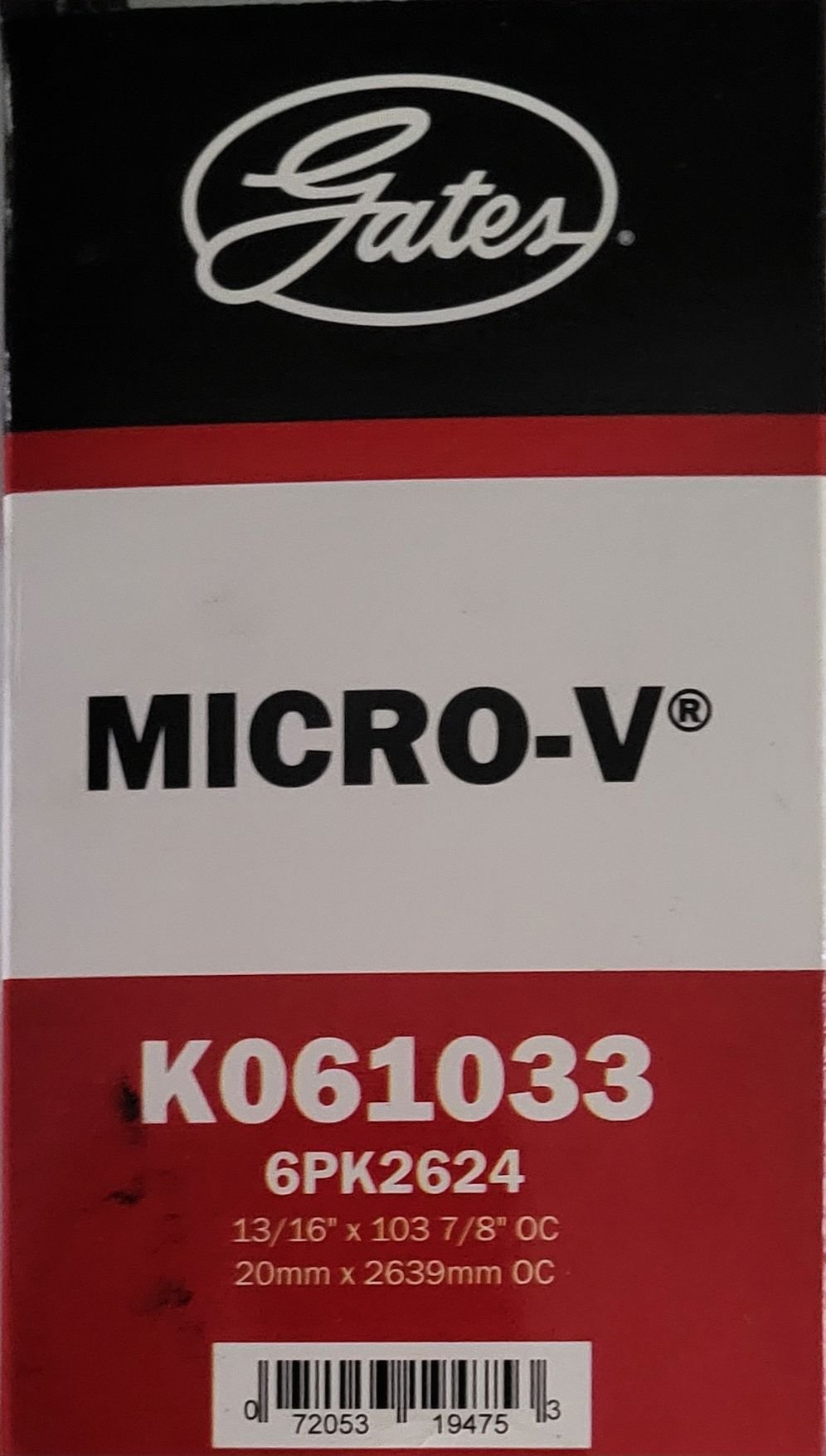

Based on some real quick googling for part numbers, I found the link below.
It seems like the linked belt is roughly 400mm longer than the evo 8/9 belt. Is the evo one too small?
https://www.japperformanceparts.co.u...th-ac-6pk1815/
Just as a note, I have no idea if that linked belt is correct, I was just looking for something to compare the evo 8/9 one against.

This is the one I recently tried for the 2008 evo but once I get it all routed it still has an inch or two of extra belt hanging from the p/s pully but it's then only belt that shows up until we go so far back in years the evo is no longer available in the parts finder I'm also banking on the parts store being correct a bit to much here honestly

That explains it, you have an evo X belt there but need one for an evo 8/9. Try a belt look up for an 03-06 evo, I bet that's the right one.
The evoX doesn't have a 4g63, it has a 4b11. Different engine, different routing, different belt.

So the first belt was near impossible to get over the last pully and so I went and got the slightly longer gates belt and I get all the way to the p/s pump and even using a pry bar to kinda roll it on I can not for the life of me get the belt on ill include a picture of how close I am so I'm just not sure if it's something I'm messing up

I don't know man. It looks like it should be the same belt. I know when I do it, I always start at the power steering pump and end at the crank pulley I think. Its been a few years since I did mine.
