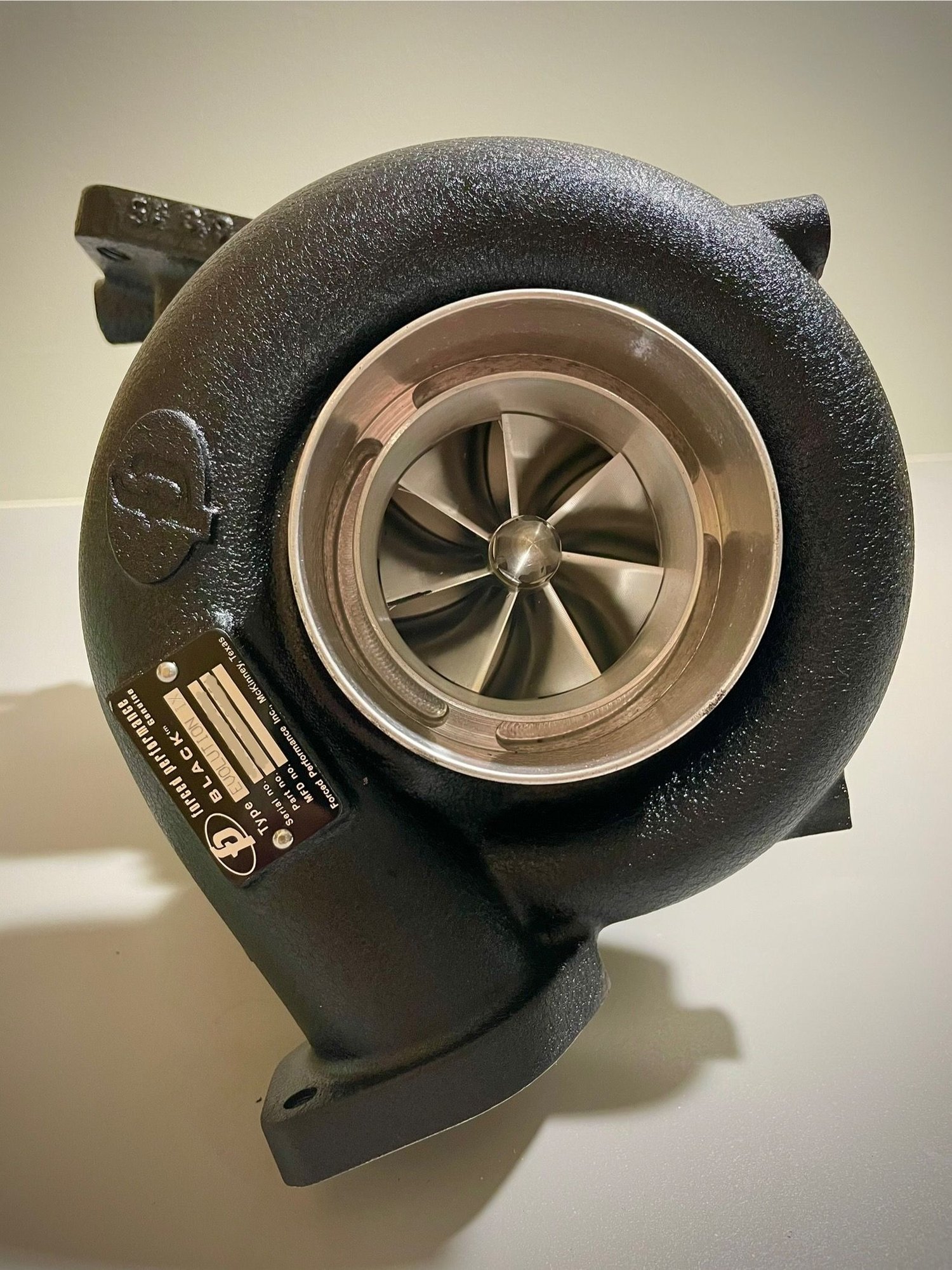

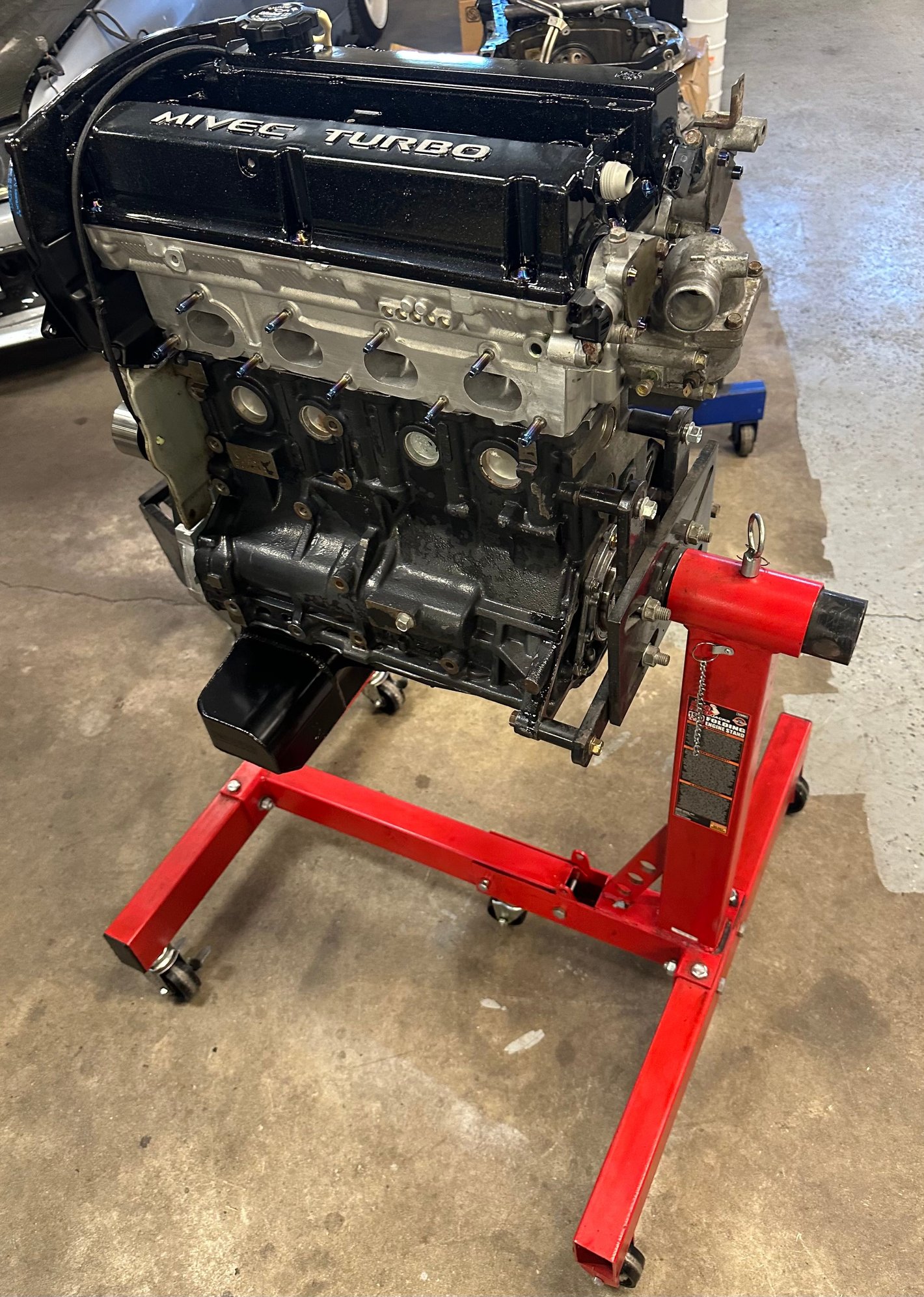

I am getting ready to install my 2.4LR 4G64 FP Black HTZ MHI setup on my Evo 9. I went with R2 cams. I am interested to see how it spools.
Those R2s are interesting. I know they were made for stroker setups but I have seen some results on 2.0s that are interesting. There just isn't enough S2 vs R2 data out there to really see the difference.
Make sure to post up your build and results in the dyno section! More data is always helpful for others trying to make decisions on builds man!

Seems to be no real good data out there on the topic. GSC originally said when they first came out that they did spool better. When I contacted them before the build they said, “Quickest spool S2, most power would be the R2.”
When I sent my head into headgames to get it pocket ported they also recommend the S2s for the quickest spool.
I went with the R2s because I want to try and get the most power possible on this setup and see what happens with the spool. My friend did the R2s in his Evo 8 2.4LR with a Precision 6870 and the spool wasn’t bad.
