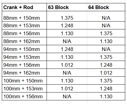

Originally Posted by kinglloyd69
Since coming to the conclusion of making this a one and done deal with no regrets, certainly gonna go with a 94mm crank. I'm about to ask a dumb question here, as I don't know a lot when it comes to engines themselves if I'm being honest. Is there a lot of machining when it comes to doing a bigger crank or stroker setups in general? I ask this as a good friend of mine will be building it for me, very knowledgeable guy who does this for a living and a hobby who I've trusted with my cars for years along with many of my friends. We discussed building it as a 2.0 shortly after buying the car, but that was before me deciding on wanting to do a 2.2 stroker for obvious reasons. The block would be going to a local machine shop that's never let us down in 10 years so far, but none of us have ever done stroker builds so I'm unfamiliar. Moral of the story, would it be a lot more work to do a 2.2 stroker over a standard 2.0 build? I know there's different pistons and rods as well just wasn't sure if doing a stroker means having to send the block to big name shops because special machining or something needs done over stock displacement motor builds. I hope that makes sense haha. Asking on here because I won't see him for another couple weeks. I will have to do some research on the 64 blocks. I'd also like to state for the record I'm gonna acquire a spare long block for this build so we can swap it on a weekend as opposed to being down for a few months. I'd like to have the current long block as a spare.
I've not seen any 94mm setups that required extra machining. I know on the 63 block some 100mm setups (depending on the rods used) the block needs to be clearanced for the rods. Not sure if the 64 block requires the same clearance work as a 63 block with wide rods.
With a 94mm crank there's no extra machine work over an 88mm crank. Just need to have the right compression height pistons and correct length rods. It assembles the same as a 2.0L would.
This is a breakdown of what compression height pistons are needed depending on which block, crank stroke and rod length are used (comp height is in inches as that's how most manufacturers publish it):
Recommend not going any lower than 1.130" compression height as the 1.012" setups put the wrist pin through the oil ring groove and the oil scraper is much more easily destabilized without that support (there is a rail support under the scraper but it doesn't perform the same as having piston material there) and when it becomes destabilized the engine is way more prone to consuming oil. Also, there are very few options for 153mm rods, it's an oddball size.

Originally Posted by Ayoustin
Haha yea, I'd love a MIVEC setup too but the expense over a non MIVEC is hard to justify and getting spares would be a huge pain in the ***. MIVEC is definitely not a necessity for having a well driving, fast and enjoyable car!
Awesome I was hoping to hear that! I'll show this response to my buddy when I'm able to. He'll understand compression height and all that stuff as it's a foreign language to me haha. One last question regarding the forged vs billet crank, the only con to the billet is the price tag correct? From what I've read I'm leaning towards a Callies crank. What brand piston/rod combo do you guys recommend? Wanting to try CP/Carillo if they make the right combo for a 94mm crank setup, never used them before and always wanted to. Seen and heard nothing but great things. Open to whatever brands though.
