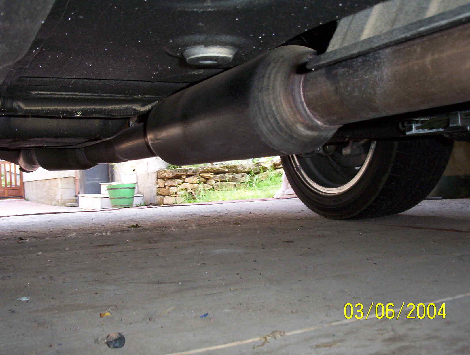

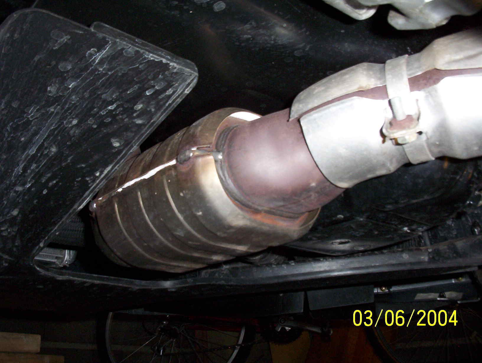

Hi all,
I don't know if in Europe we have the same exhaust system.Here are the pictures I took from mine:
Attached Thumbnails Quick question concerning exhaust-cat-just-after-downpipe.jpg   Quick question concerning exhaust-cat-just-after-downpipe-2.jpg   Quick question concerning exhaust-downpipe.jpg   Quick question concerning exhaust-intermediate-pipe.jpg

From those pics, it looks like you have a cat converter in the downpipe? So that is different. The US dpwnpipe doesn't have that. Other than that, they look similar. From your second cat back, it looks the same as the US spec. The bumps in the mid pipe are resonators, which we have as well.
The cat backs include the mid pipe and bolt to your second cat.
Axle back systems retain the mid pipe and just change the last pipe/muffler.
