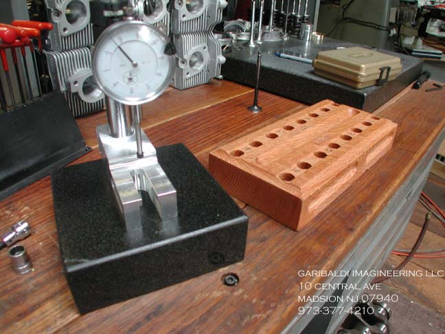

Here is a fixture I came up with for adjusting the solid type lifters on your EVO should you be running that type of cam. Just take the initial measurement, postion the lifter under the plunger, zero the lifter and make the adjustment. The amount of adjustment shows up on the dial- although it is not linear due to the rocker ratio, but once you get it down, it makes adjsuting those lifters a hell of a lot less of a pain in the *** then just guessing what change you made and having to reinstall it, only to find out that you are off and have to take it all back apart to do it again.......................

I just finished a motor that is running them, hence the fixture.
