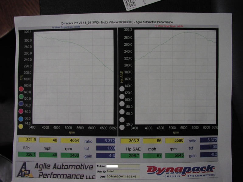

OK...I got dynoed on a Dynapak Dyno back in March with the mods I have listed below. Here is the chart...
Today, I was dynoed on a Mustang Dyno. I have the same mods as before. Now, I know that this dyno reads lower than a Dynapak/Dynojet...but...I was a little concerned with the results. Dynapak 303hp/324tq...Mustang 233hp/277tq
On the left side of the chart is my run. On the right side is my run overlayed with a baseline pull of a STOCK Evo RS on the same dyno on a different day. It looks like there is a difference of 90tq but only 20hp from the baseline of the STOCK Evo RS?? Also, comparing my Dynapak and Mustang charts, it looks like I am producing max HP at only 5600-5700RPMS. Isn't that real low???

i believe that the top charts are hp at the crank..it says flywheel hp and flywheel torque right on the top so your numbers will be much higher..the bottom ones are at the wheels..and for your limited mods i would say that is about normal for hp and torque..that torque actually seems really good to the wheels..hp is about average since i believe evo's baseline at 220 hp at the wheels? anyone feel free to correct me but I believe this is the difference between the two charts

I called the shop back in March and according to the shop the Dynapak numbers on my chart are whp...for some reason they are printed on the fly wheel horsepower screen.
I find it odd that the Mustang Dyno says my HP is 233 and torque is 277...that ratio seems a bit off to me....especially when the stock RS is at 219hp/188tq.
My hallman boost controller holds 21psi and tapers to 19psi by redline, so I don;t think there is much of a boost leak.
Like I said before...the one thing that both the charts have in common is I reach my peak HP around 5600-5700rpms...which I think is way to low. Any reasons for that as well has any reasons why I would produce 233hp/277tq on the Mustang Dyno?

Keep in mind, though, that torque and hp are directly related to RPM. That is, hp = torque * RPM / 5252. So when you say "HP is low but torque is high," you really want to say, "My torque peak is at a really low RPM." In fact on the Agile graph you have torque declining continuously from the beginning of the graph, so we don't even know where the peak was.
The other graphs just look a little weird to me. They're really jagged -- seems like I've noticed that before with Mustang plots. And, a stock Evo RS with a torque peak that doesn't happen until 4500 rpm? Huh? What, did they not step on the gas until 3000 RPM? How exactly does that happen?
But as to the big difference in torque with not so much difference in top-end horsepower, that's not uncommon. The deal is, we can pump up the boost and make a bunch more power at the low end, but with stock fuel injectors you run up against maximum duty cycle at fairly moderate boost levels, so it becomes hard to tune at high rpms. (Conventional wisdom says that after 80% duty cycle, the injector is pretty much wide open, so you can't fine tune after that.)
Your air/fuel ratio was richer than 11.0:1 at the top end, and you could run it a bit leaner than that, assuming there's still some room to dial the fuel back.
