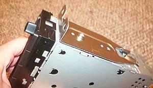

I bought a new CD player tonight and started the install process, but hit a snag...
I pulled out the stock deck and proceeded to take off the 2 side mounting brackets, but I can't get all 4 screws out! I've started to round off 2 of them, and don't think they are coming off!
Therefore, it looks like I need 2 fresh side mounting brackets! Any ideas or help?

Very common. Next time take a rubber mallet and hit the top of the screw driver when before you turn it helps a great deal. As far as now, get a dremel and cut a slot on the screw like a flat head screw, then try the rubber mallet technique. Should work.

Do you have an impact driver? it looks like you used a screwdriver that was too small- next time use the right size- #2 phillips i think- also make sure the handle is long enough- more length= more torque.

Ok I did the same thing and as long as you have one out on each side you should be ok. Just take and kind of pull on the bracket untill you can "unclip" it and turn it. If you can get it to where you can turn the bracket with the one stuck screw still in there then it will take alot of pressure off of that screw and you should be able to get a pair of pliers on there and turn it the rest of the way out. Worked for me so give it a shot.....then just get a couple of new screws and you are set!

Dude, I got it! I just needed to get the hammer out as it seems!
Lifted up the back end of the clamps, and hit the front with the hammer in order to rotate the clamp around and it loosened itself up and it's off.
